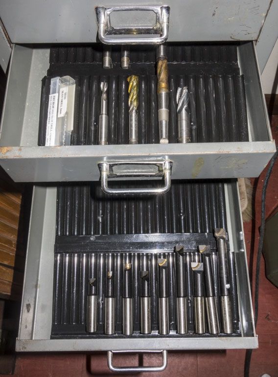

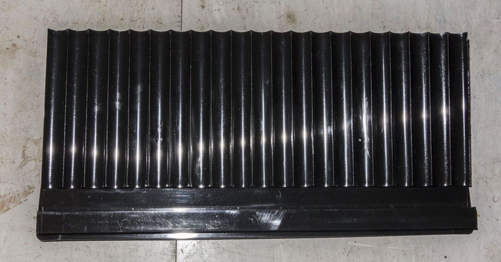

                        I like the Ikea rack, this is what I ave now in some other drawers. Please note, this is a layered drawer with the tray on the right sitting on rails over the lower layer. Trying to cram as much as possible in there:
                        I don't like the idea that the cutting edges can crash against each other as the drawers are opened and closed hence the new cabinet.
                        graham.

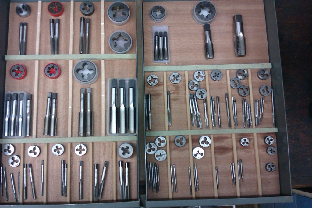

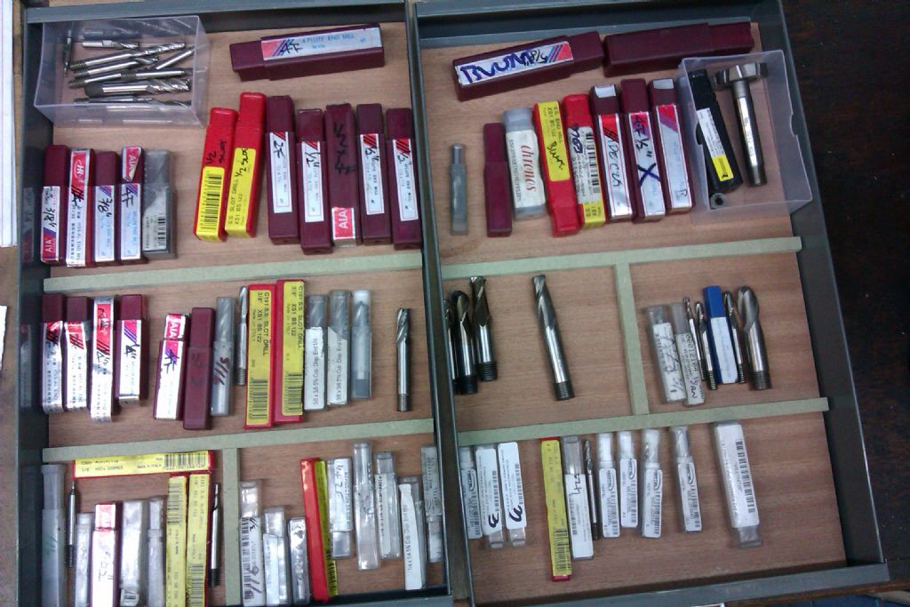

                          Make a wooden frame up same size as the internal dimensions but only half hight. Just four side no top or bottom. Lay out your cutters and tools In the order you want them on a dummy bottom then lay a piece of cotton material soaked in light oil over them and press it round the tools. The oil helps it flow round the tools. Then spray some of that builders foam over the lot. Bang a top on it and an anvil to weight it down and when its set you have a custom drawer insert. If you don’t want to use oil water will do but you have to let it dry afterwards.
                          God this was hard work with one finger on this phone
                          Note to self buy a computer

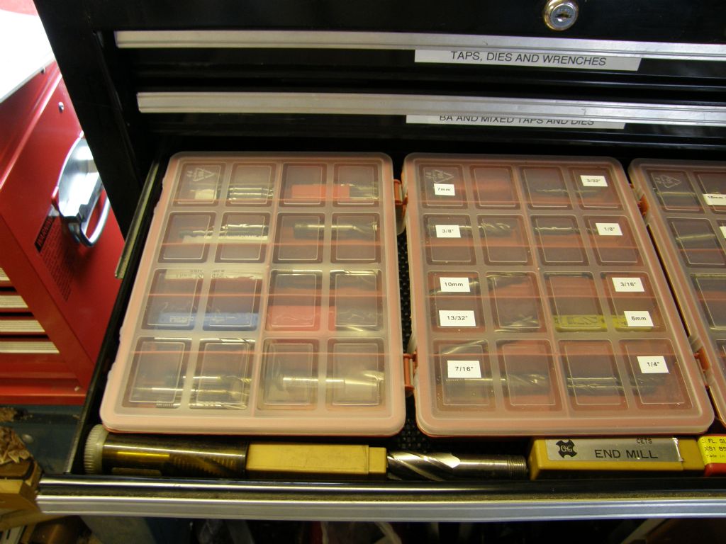

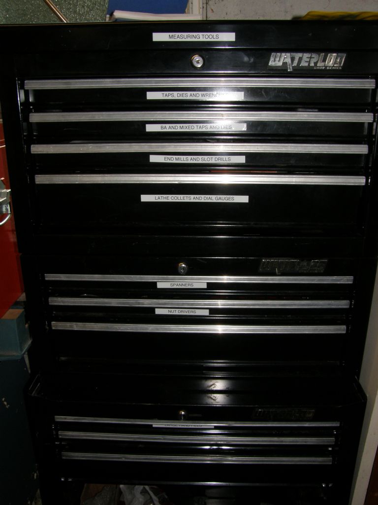

                                        Son-in Law gave me this Waterloo tool chest (empty of course) recently and I am in the process of stocking it up.
                                        What I did find was that three small plastic compartmentalized boxes ( ten compartments in each box) fit in the shelves, comfortably side by side. They are obtainable from CPC for about 99p each.
                                        These will accommodate most of my milling cutters without fear of cutting edges getting damaged.
                                        Len. P.
                                        P.S. Haven't finished the labeling yet.

                                          Well Len
                                          That certainly is the deluxe set-up. I'm quite envious!

                                            Very nice Len.
