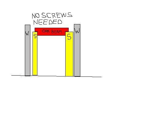

        I've noticed a couple of ideas being bandied around in random threads recently and thought it might be useful if we pool all our ideas into a single thread
        My own problem was metal shelving in a garage with a wonky floor and breeze block walls
        I wasn't going to drill holes into breeze blocks to secure my shelves, I don't trust them because they crumble too easily, especially under side loading and I was going to be putting some big lumps of metal onto heavy duty shelves which were set on some not properly flat concrete flooring
        My solution was to jam the top of each shelf unit with oak 2x4s, pinning them against the walls
        the end of each beam was cut by 50% to slot downwards on the shelving
        This also gave me even MORE storage space because there's a two foot gap above the beams, it's very stable and not a single hole was required to be drilled in a wall
        The walls are grey
        The shelving yellow
        The beam is in red

              Neat idea Ady
              I don't know if it was strictly necessary to use oak – unless of course you " had some about you "! wink

                    If the blocks are concrete breeze blocks they'll be fine for fixing with raw plugs. If thermalite I'd probably run a batten along the top of the shelf and fix into the mortar between the blocks, then secure the shelving to the batten. Alternativley the No-more-nails type of fixing would be good on a block wall with the batten method, but I wouldn't recommend it on thermalite.
