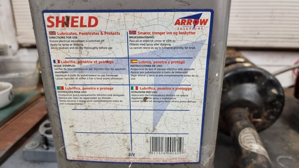

                          As many will know i built a fully insulated fridge panel type garage /workshop. I still have the dehumidifier running through the winter months. I get about a litre of water out every 3 or 4 days. Probably coming through the concrete base.
                          At my previous house i insulated the garage door with polystyrene panels , which helped. A friend had a company in who fully spray lined the garage with insulation. That was toasty warm, but probably very expensive.
                          Brother in law had a concrete garage with wriggly asbestos roof. He bought large sheets of poly insulation from the.. builders merchants. He did all the roof & the concrete walls. The walls he then oversheeted with ply . It worked well.
                          Edit… I still spray coat some cutters & other tools with the shield stuff but i guess these days it is banned.
