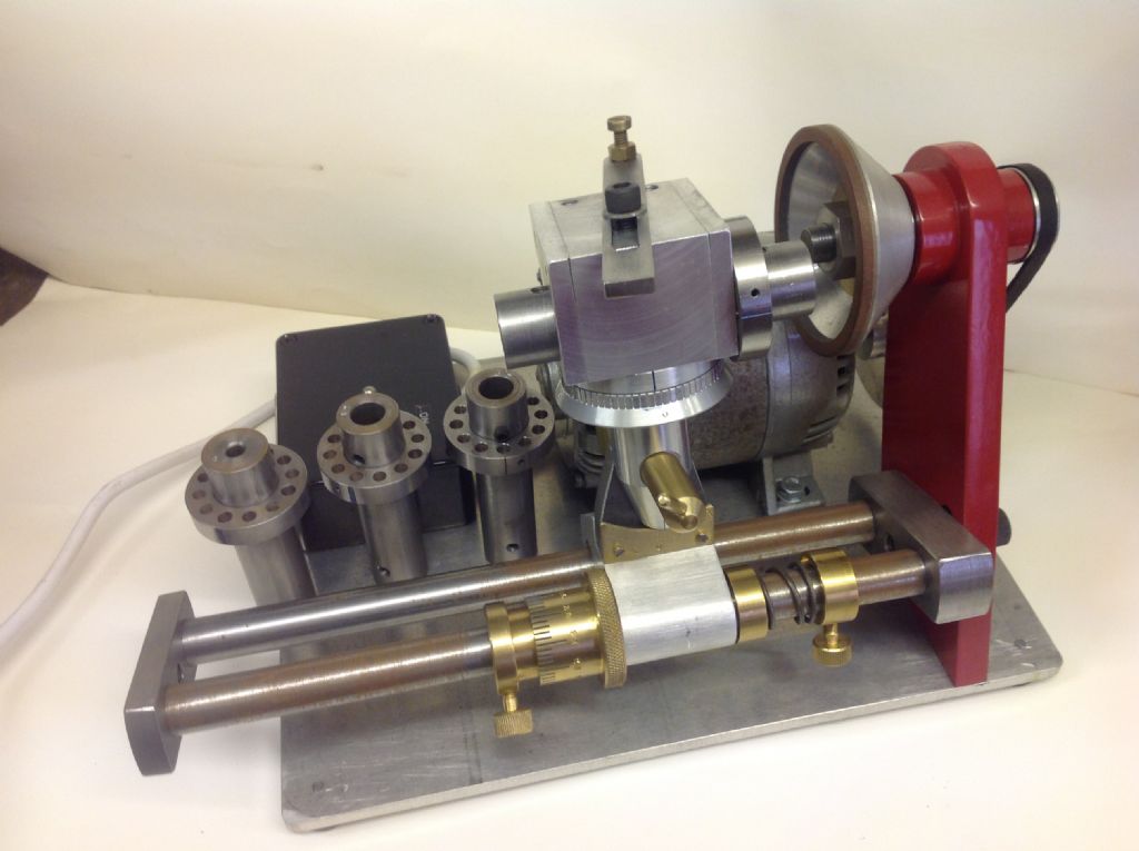

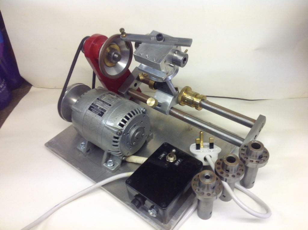

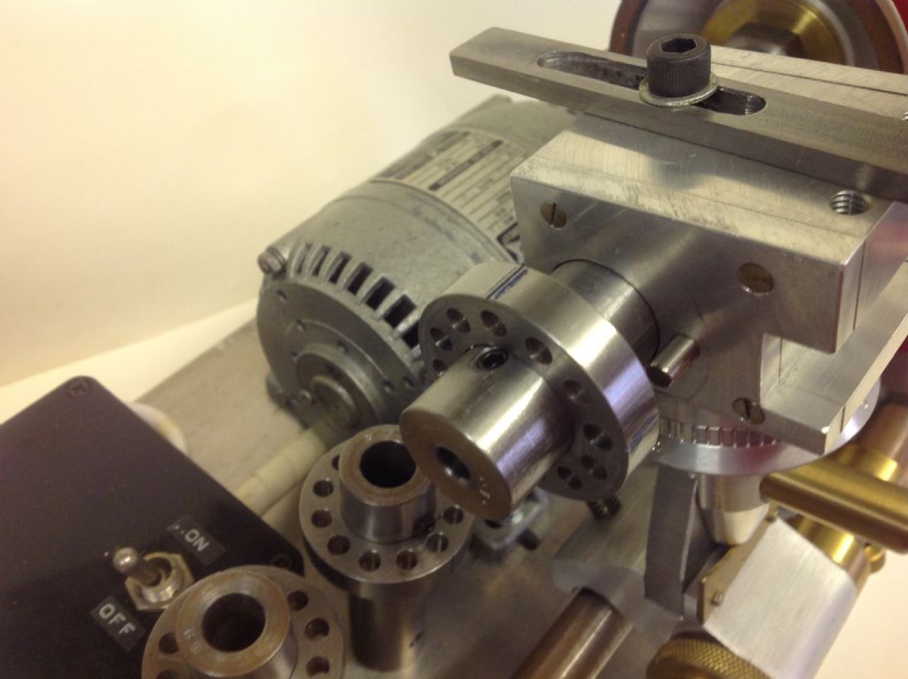

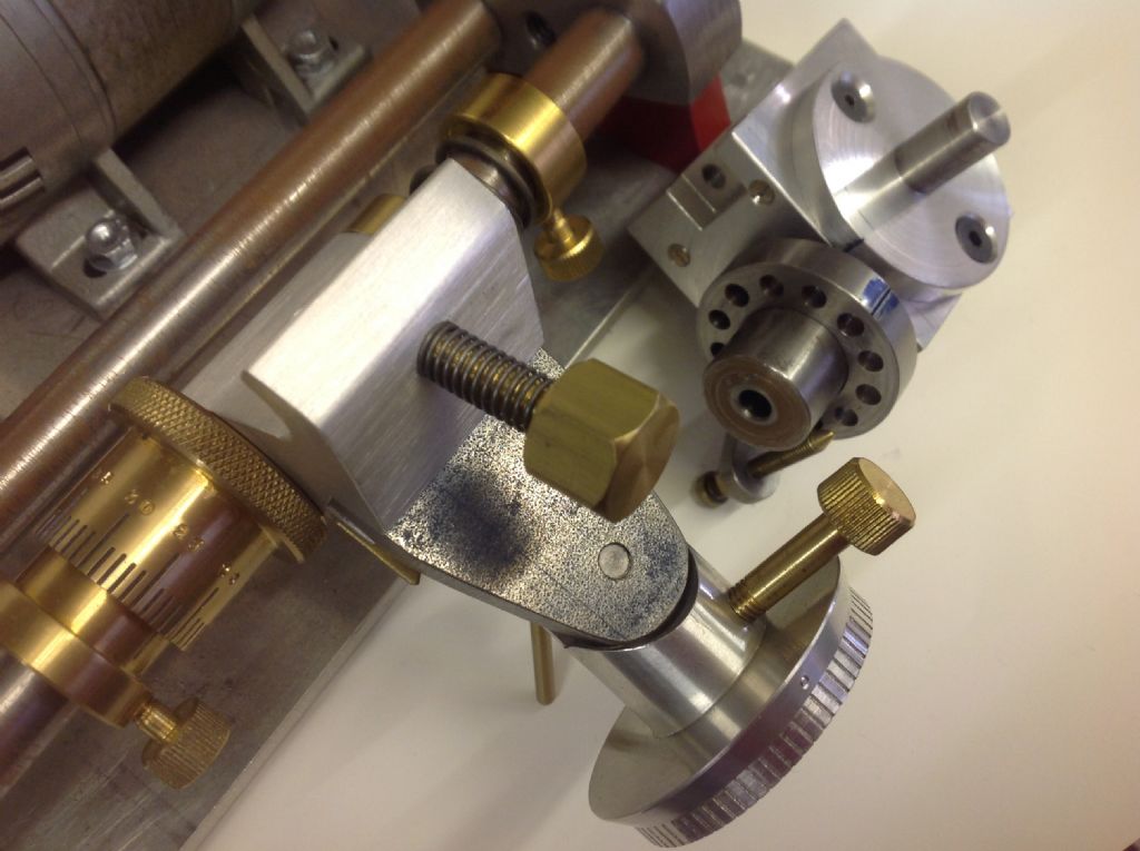

                if you go onto the Bristol model engineers site they do a very simple cutter grinder that I made and sold recently as I can no longer work. It was featured in MEW no 47 and called the Collier Caseley. No castings needed,made from stock materials, driven by 1/8 hp motor and diamond cup wheel. 2, 3 and4 flute cutters can be sharpened ON THE END only – never had the need to do the sides.

                  As mentioned by Pete above. two more pictures in my album. If you have half a brain you can see how it works and make the equivalent out of whatever you have to hand. The tool is swung across the wheel similarly to a Quorn.

                                Hurrah. I found out howto.
                                I made this some 10 years ago
                                pete

                                    Peter asked me to put these pictures on the forum for him of his Collier Caseley. TCG,
