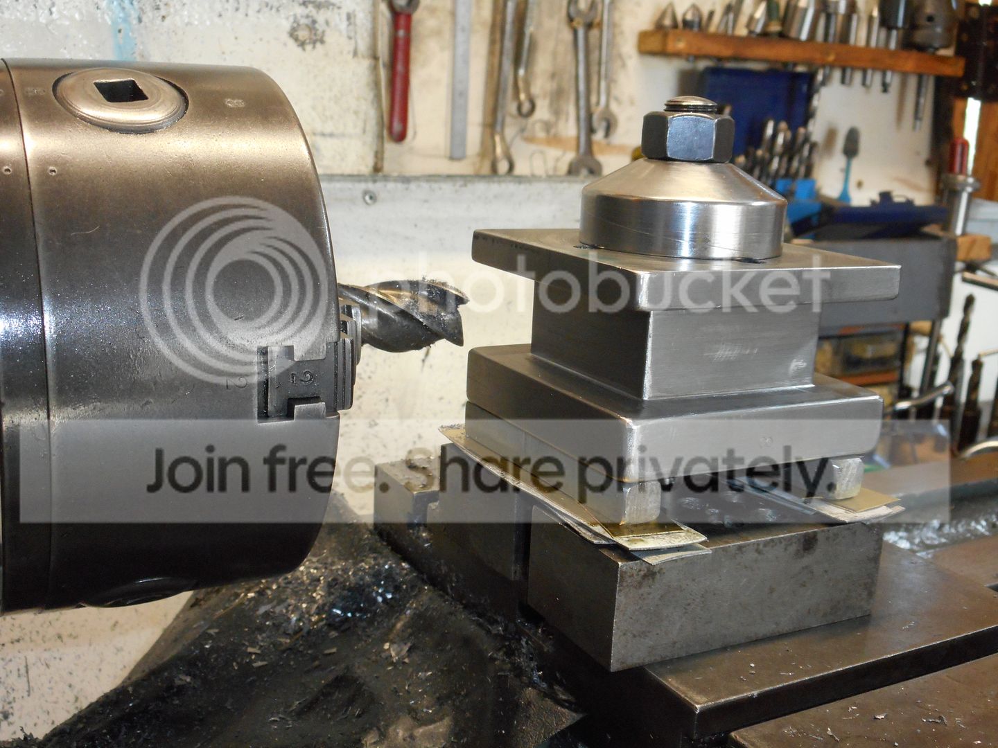

      I'm looking for material suited for making a tool post . i can't find a topslide and base for love nor money so it's been suggested that i use a steel block to fill in the space the topslide and the topslide base would take … I'm going to try this and see how i get on . Would any old piece of steel made to the correct dimensions do . I'll be working out of the yard so i'll have access to their big Colchester lathe i believe it is ,it also has a vertical slide so maybe i could use that to true up two faces of the block … That's my plan anyways ,i'd appreciate any feedback on my plans ….
      Sean

          Hi Sean,
          If I understand you correctly you want a tool holder that doesn't mount on the top slide, but directly on the cross slide. Some time ago I made a tool holder that mounts directly on the cross slide of my small lathe, I used mild steel, it has worked well.
          Thor

                  Cast iron would certainly be easier to machine, as long as the material you use is of reasonable quality – otherwise it may have inclusions of casting sand etc which will do your nice sharp tool no good at all. Other than that, it is dirty stuff to work with, because of the carbon it contains, which will fly to your hands (face, shirt, etc) as though magnetised. But it washes out OK.
                  Of course, as soon as you have a tool holder made up, you can get on with making your own proper toolpost. Cast iron again, I suggest.

                                          I made my "semi-Gibraltar cum rear toolpost" out of pieces of black mild steel bar welded together and machined in the lathe to suit the existing four-way toolpost I scrounged up for nothing in a box of junk at a garage sale. I very rarely use the topslide these days. Pretty much only for screwcutting.
                                          So yes, any old block of mild steel you find lying around the yard of suitable size should do the job, or a stack of pieces of flat plate or flat bar welded together also. Just make it good and solid, so 3" or 4" square is ideal. The clamping bolt down through the middle of mine is from memory 7/16 UNF high tensile, machined to fit the T slot at the bottom and  to fit the 3/8" T slot. Tool clamping screws are 5/16" but 1/4" will do the job if you are using 5/16 or 1/4" square HSS blanks instead of the 3/8 tool bits I use.
                                          If you just make a big square block with one slot milled in it for the tool bit, you can mill it in your own lathe by setting the block in its operating position, but packed up with spacers as needed and hold the milling cutter in the lathe chuck and away you go. I made another four way toolpost  that way. The whole thing was milled from solid like this:

                                              Some years ago, I made a four way Rear Toolpost for my lathe. The raw material was a 3 foot length of 3" x 1" BMS, (declared scrap by R & D). It was made to match the four way front toolpost.
                                              Each of the five laminations was machined differently, and clamped together, internally, by three long Allen capscrews. The fourth position was used for a dowel to locate each orientation. It carries a parting tool and two chamfering tools (front and back chamfer).
                                              1/2" bar was ideal for making the M10 Tool clamp screws.
                                              The base is clamped onto the rear T slot of the Cross Slide, with two small dowels to locate it against the back of the Cross Slide.
                                              Have also made two other 4 way toolposts, for friends from lumps of mild steel. One is on a Little John, the other on a Chester Cub.
                                              As far as I know,like me, they have had no problems. So Mild Steel will do the job.
