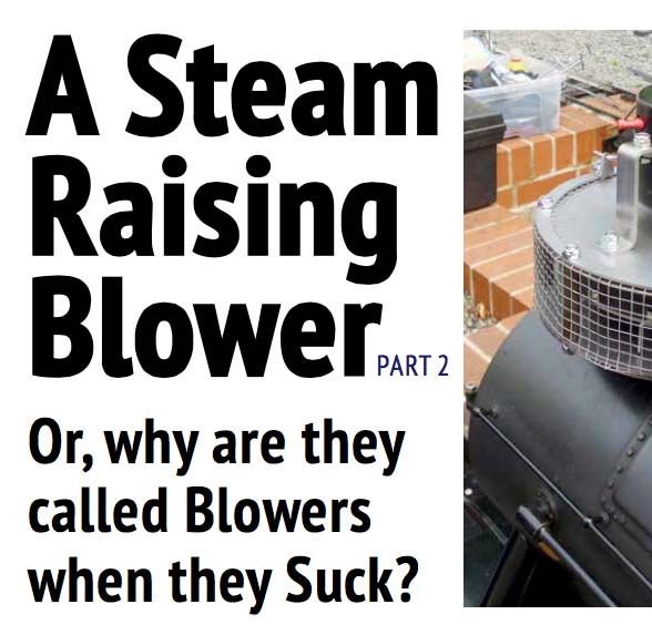

      I am interested in making the Steam Raising Blower described by Brian Baker in recent Model Engineer magazines. However, a comprehensive internet search has failed to find a 12 volt fan motor suitable for a 7.25" loco as featured in Part 2. can you, Brian, or anyone else please advise where I can buy such a motor. Many thanks, Mike

            Haven't seen the article but isn't it more usual to mount a sucker on the funnel rather than using a blower? You then need a fan that is impervious to smoke and heat.
            Where can you fit a blower?

                Posted by Russell Eberhardt on 09/12/2016 11:22:39:
                … but isn't it more usual to mount a sucker on the funnel rather than using a blower? …

                  hi Michael,
                  thanks for your interest in my fan design, and sorry to find the problem with sourcing a suitable motor.
                  I looked on Ebay and found about a dozen, when I built my blower back in June, but today not easy to find. The motor I used was normally used to operate a radiator cooling fan or car heater fan, made by smiths 7 fitted to many UK built cars in the 70s, 80s, & later.
                  However, ebay item 162175639784 may well be suitable, or, perhaps try a car breakers.
                  I will look into recommending a suitable motor, when I can find a reliable source.
                  hope this helps, and please let me know how you get on.
                  regards
                  Brian

                        Greetings Julian, thank you for your comments.
                        In my experience, the compressed air system can use quite a lot of air, and just when you need the most, someone else opens up, thus reducing the supply, just what you need.
                        You are quite right about the plastic fan being next to useless, and my design was to provide a laser cut replacement for the fan & casing.
                        Above all, it was meant to be simple to construct, with a view to encouraging someone who has purchased a locomotive, to start making some thing simple, and thus beoming converted to this wonderful hobby of ours.

                                I'd started making a blower along the lines of the article, prior to it being published. I needed a motor and realised I had one of these laying around.
                                **LINK**
                                Its more than adequate and needs a speed controller otherwise you'll be sucking coal down the firetubes !!
                                **LINK**
                                Seriuosly this motor makes such an effective blower. I was using it for the first time the other day and once I'd got steam up one of the guys wanted to try it. He said "put it on full" as he only had about 10 psi on the guage. He went from 10psi to safety's blowing in less than a minute.
                                OK Jaycar is Oz/NZ but these are Chinese products so I'm guessing Maplins (are they still around?) will do similar, otherwise its Ebay or Alibaba.
                                Pete
                                PS – 7.25" guage locos. The tube for the chimney is 2" I'll do some photos if more details are required.

                                    Here's my nearly finished blower for a 7.25" loco (Dart) with the Jaycar motor (see link above)
                                    The rotor was supposed to be just some flat baldes welded to the two plates. i don't have welding kit so made a hub and copper plades and silver soldered it all together. The other plate is held on stand offs like the main body. Rather than spending time making standoffs I used 1/4" stainless tube and 4ba bolts
                                    By the way the direction of rotation is with the sweep of the blades trailing. I felt that the leading face would swash the air outwards and a vacuum would be created in the concave cavity of the trailing face. The combined effect drawing air from the center
                                    This blower (sucker) is cabable of lifting something the size of a book off the table.
