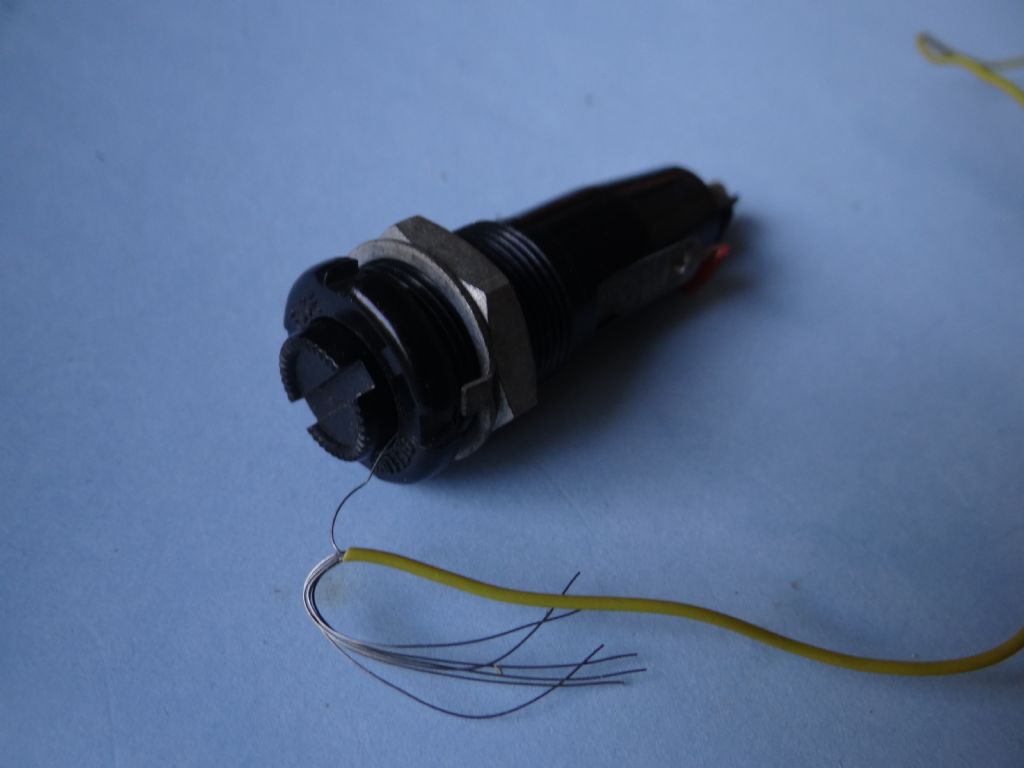

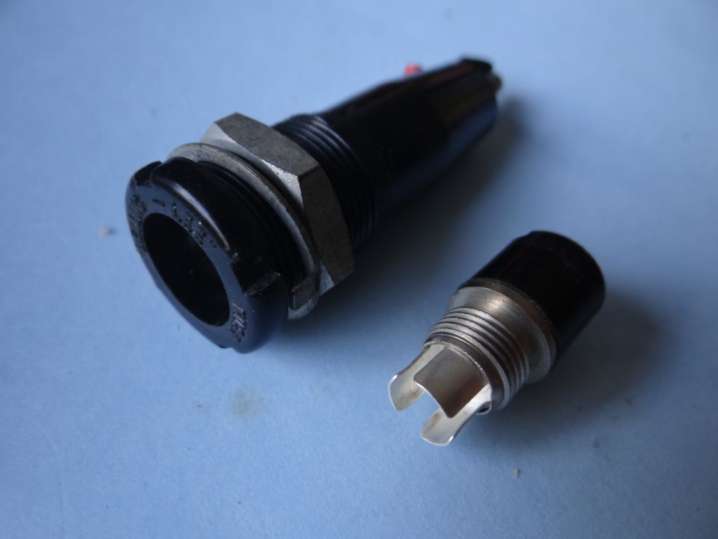

                              Exhibit A is a well-made British fuse-holder of the last century:
                              And here it is successfully rendered dangerous by a whisker of wire despite the cap being fully screwed home.
                              By far the most dangerous electrical devices I grew up with were valve TV sets. Users were protected by a flimsy compressed cardboard back, punched full of long ¼" wide slots for ventilation, and held on with a few self-tappers. Inside, the power supply was super-dangerously rectified direct off the mains, no transformer, and included an 15kV plus Extremely High Tension output to drive the Cathode Ray Tube. Many early TV sets emitted dangerous levels of X-rays too!
                              I've never understood why the safety standard for 13A plugs and sockets was so much stricter than those applied to TVs, Wireless, and Gramophones.
