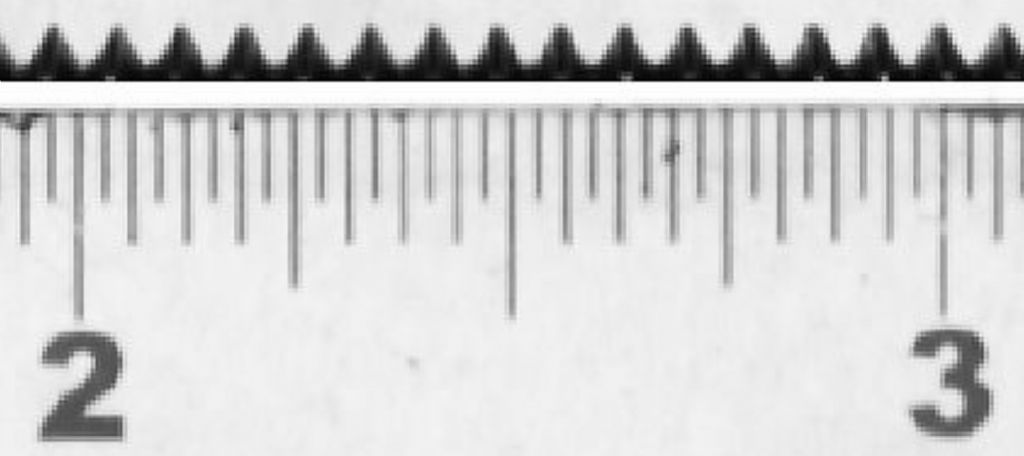

        Fowlers Fury
          @fowlersfury
          This has provided a not-so-welcome break from the trials & tribulations of Walschaerts valve timing.!
          I thought it'd be easy to help the OP as I have a Startrite, as well as an e-copy of their brochure with specs.(PM me if you want a copy). Nothing on the brochure about the depth gauge though.
          However, I removed the threaded depth stop bar and went through an extensive collection of old nuts from BSC to metric with a view to finding a couple to send on to the OP. No such luck, nothing fitted BSF, BSW, UNC etc.
          My thread pitch gauges didn't help with identification either. It looked metric but if it is, it must be between whole numbers. So herewith an attempt to lure the thread experts into an answer:-
          Edited By Fowlers Fury on 21/04/2020 16:45:32

            Thanks, FF
            dont know … That doesn’t look like 14 tpi to me

                          My old Startrite floor standing machine, serial number 73698 has a 5/8" x 14 BSF thread, confirmed with thread gauge.
                          Dennis
                          #466223

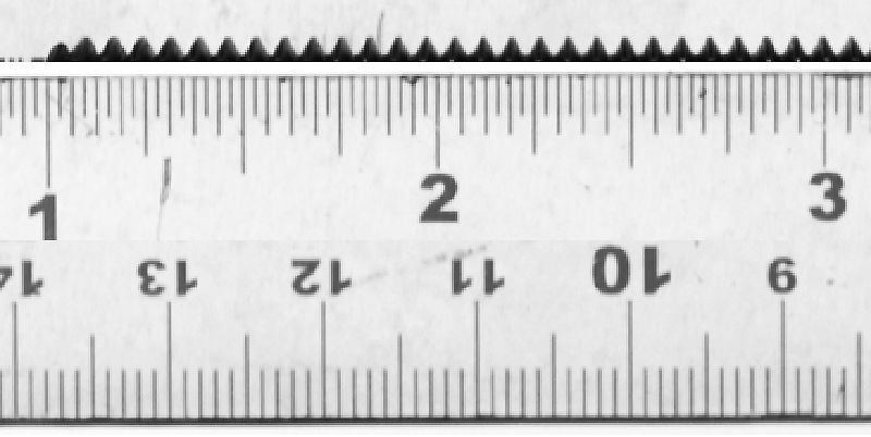

                          Fowlers Fury
                            @fowlersfury
                            My apologies for creating any additional confusion. Dennis R is correct, the thread is 5/8 BSF. I had no BSF taps & dies >1/2″ & obviously no nuts of that thread. I had to place the rule on top of the threaded rod on the scanner and thought there’d be no parallax yet the set up “lost” half a tooth.

                                Posted by Fowlers Fury on 22/04/2020 00:45:33:
                                My apologies for creating any additional confusion. Dennis R is correct, the thread is 5/8 BSF. I had no BSF taps & dies >1/2" & obviously no nuts of that thread. I had to place the rule on top of the threaded rod on the scanner and thought there'd be no parallax yet the set up "lost" half a tooth.
                                … and they used to think that the camera couldn’t lie laugh
                                Many thanks for clarifying that.

                                    Since the consensus among those who actually own the machine corresponds with the measurements in the original posting my money would be on 5/8 BSF. The supplied nuts would appear to be wrong, as MichaelG and others suggest.
                                    I never take anything for granted, but I can't think of any reason the makers would have chosen an obscure thread for such a simple device. A call to Machine Spares might clarify the matter as they do list most of the spares. ( I have no connection with the firm, not even as a customer )

                                          Ok, I think I can finally put this one to bed. I have taken one of the supplied 5/8” -14tpi nuts, and put a large counter sink either side of it to clean up the entry and exit. This nut now goes on the feed thread and runs freely. So I can confirm it is a 5/8 BSF with 14tpi.
                                          thanks for all your help and sorry for any confusion.
