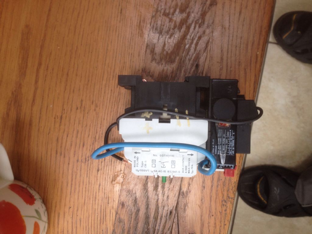

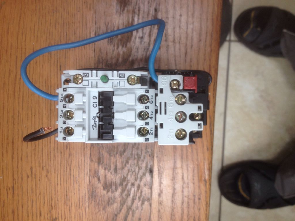

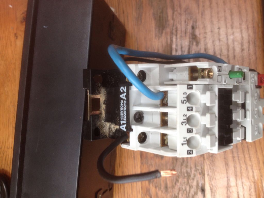

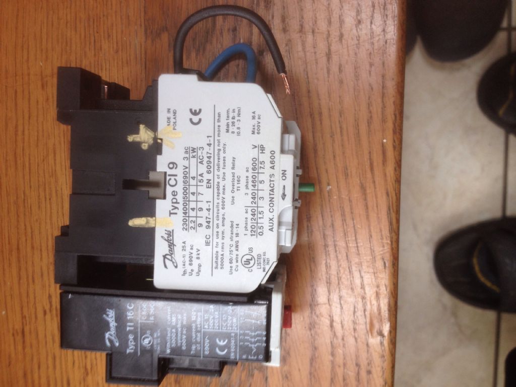

        img_2687.jpgimg_2685.jpgimg_2684.jpgThis starter came with a 3 phase bandsaw which I have now put a single phase motor in. I was told it could be wired to start the single phase motor could anyone tell me how to do this?img_2683.jpg

          Hello Andy,
          The trick is to make the switch think it is receiving voltage through all three contactors.
          Wire live phase to terminal 2 and wire a loop from terminal 1 back up to terminal 3. Wire terminal 4 as the switched live on to the motor and wire the neutral phase through terminal 6 to terminal 5 which you also take on to the motor.
          It is very likely you will need to change the operating coil to one of 240 volt working, it may not develop enough magnetic pull to latch with a 440 volt coil. Your local electrical wholesaler should be able to find a suitable replacement.

              Andy
              Will the rating of the overload unit allow setting to the full load current of the single phase motor ?
              The FLC will be stamped into the motor plate and may be greater than the max o/load setting.
              Brian is correct to say loop the supply through all overload heaters but I think he has the connection details muddled.
              It is normal practise to connect the live supply to terminal L1(1) then loop from the overload term U to L2 (3).
              Connect Neutral incomer to term L3(5).
              Connect motor live to V and motor Neutral to W, both at the output from the o/load unit.
              Don't forget to connect the g/y cpc (earth) to the motor earthing point.
              Unforunately my system won't enlarge your pictures so I can see the contactor markings so do check.

                Ian Parkin
                  @ianparkin39383
                  Brian
                  Why the need to do your complicated wiring?
                  The supply goes into the top contacts 1,3,5 for 3 phase or just any pair of them for single phase live and neutral
                  Certainly NOT into terminal 2 as there’s a overload fitted
                  The starter isn’t bothered about needed a load on all contacts or a load on all overload thermals
                  It would be bad practice to wire a supply through the overload first
                  Then the output to the motor comes out of 2,4,6 on the overload (next to the red button) Or the pair that you have used for a single phase pair.
                  You would have to be sure though that the coil supply’s come off the 2 pairs of contacts you have used

                          Mike Poole
                            @mikepoole82104
                            Some of the overloads by Danfoss have phase failure detection so need the circuit that loops through all contacts. As a matter of course I always use the loop configuration as some starters specify it and some don't but to put it in will do no harm.

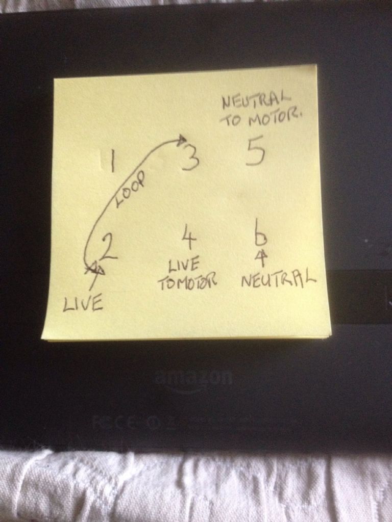

                                img_2693.jpgimg_2694.jpgHi folks thank you for all the replies.I drew out what I thought Brian Wood had said to check if I was correct and have posted a pic.Could anyone do a drawing like this but the way they think it should be it would make it totally clear to me thenimg_2696.jpg .The blue wire from 5 L3 and the black wire from A2 do they stay as they are in new wireing? Is the black wire for A1 to 1L1 done away with.

                                  Stuart Riddell
                                    @stuartriddell45006
                                    Search on ebay for a Danfoss CI9 240 volt coil, that bit with A1 & A2 on it. Change that bit and your good to go as long as the overload is the correct rating

                                      Is the sketch of the wireing correct as Brian Wood described it?The blue wire from 5 L3 and the black wire from A2 do they stay as they are in new wireing? Is the black wire for A1 to 1L1 done away with.

                                        Brian Wood
                                          @brianwood45127
                                          Andy,
                                          I seem to have stirred up a hornet's nest. It would actually be easier to buy a new starter switch anyway, the coil swap will cost about the same. It will be better balanced to the load as well.
                                          I don't think your interpretation of my description is correct, the loop should be brought back to the middle input terminal having been through the whole switch, you show it as a short link For the sake of clarity, the loop should be between 2 and 3 —-not 1 and 3 as you have drawn it.
                                          But be better guided by others, my advice was based on the older thermal trip MEM starter switches and modern versions are much more sophisticated.
                                          Regards Brian

                                              #321187
                                              Andy Sproule
                                                @andysproule22368
                                                img_2720.jpgimg_2715.jpgimg_2714.jpgimg_2713.jpgHigher resolution pics.Sorry to bother you all again
                                                Is the wireing in the sketch now correct?Do the wires already attached stay the same and the black wire from A1 go into 1L1?img_2712.jpg
                                                #321203
                                                  Andy,
                                                  I hope someone else will confirm because my experience is limited in this area!
                                                  I believe that the circuit posted by Brian is correct and it is necessary to use all 3 thermal cut-outs. That's because. if I understand the blurb correctly, the CI9 detects single phase dropouts as well as overloads.
                                                  Ignoring the wiring that powers the contactor itself, I think it should look like this:
                                                  Happy to be told I'm wrong. If I were you I'd test it by wiring a table lamp to the motor L and N with a 3A plug on the input side. If it works the lamp OK, move on to the motor .
                                                  #321209
                                                  Brian Sweeting 2
                                                    @briansweeting2
                                                    SOD, yes that is correct, good picture.
                                                    #321214
