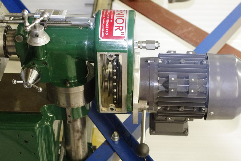

                        The motor is mounted, not without slight problems. I bought a metre of the 10mm link belt, similar to Fenner nut link. Judging from the length of the old belt, I got two from the metre length, one slightly longer than the other. After fitting the longer one, I recon that the shorter one might just fit too. Fitting the link belt caused a problem straight away, we couldn't get it between the housing and the largest pulley on the spindle. I had thoughts of grinding away at the tight area in the housing, but tried an easier solution first. Taking the pulley off and reducing the top flange of the largest vee. I took off 0.042" off the diameter, and rounded the edges, and the belt just fitted with a little help. The link belts must be a bit deeper than a plain one.

                              I have pretty well finished the electrics, except for making a bracket for the second emergency stop button. When I checked the wiring continuity with a meter, there was an inconsistency in the contact resistance in the regular stop button and one of the emergency stop buttons. They are in series, all the inverter controls are remote. The switches are Chinese and there is nothing obviously wrong with their functioning. Not having any Servisol switch lubricant, I gave each switch a good dowsing in AC90 which is similar to WD40. Now they work as they should, and I did the same to the start switch, just in case.
                              The inverter is a Schneider ATV12 0.75 Kw and the motor is a TEC three phase 0.75 KW six pole. I bought them from The Inverter Drive Supermarket and chose one of the inverters that benefited from their quick start guides pdf which Rod printed out. It took me about an hour to get the programming to my satisfaction, it would taken a year without the QSG. I have the frequencies running from 25 to 75 Hz.
                              The link belt turned out to be two links too long and it rubbed the housing in top speed pulley configuration, and the spindle is overheating. It still ran hot after slight slackening, and if one more adjustment does not do the trick without over slackening the bearings, I will have to assume that I have overpacked with the grease, and will have to remove the spindle from the quill to remove some. I fitted a double lip oil seal with the same id as the spindle nose diameter without the garter spring, and bored the bearing housing where the seal sits a couple of thou oversize, so it will not be too hard to push out when or if the spindle is removed.

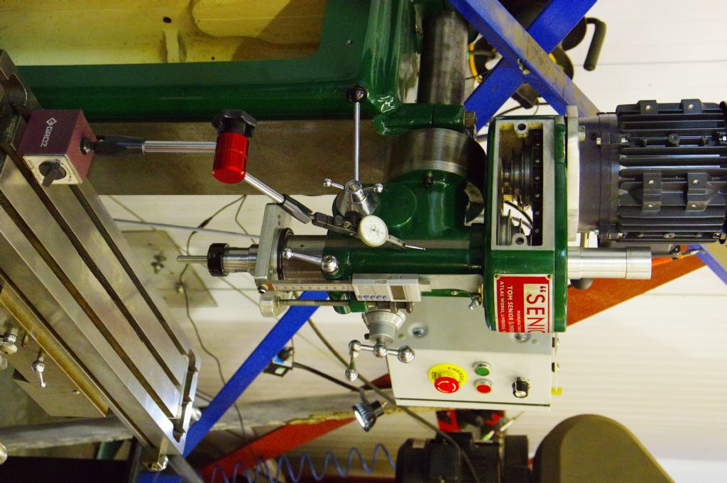

                                  imgp0938.jpgA few more pictures, the machine is close to cutting metal.imgp0935.jpg

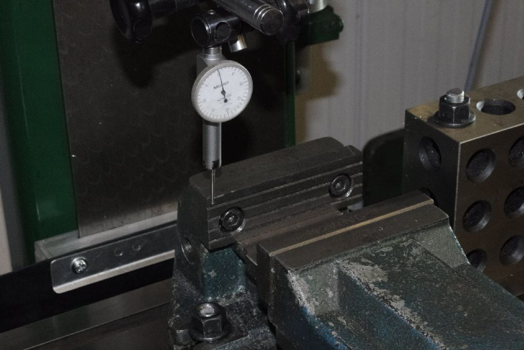

                                      The second picture in todays series shows another way of tramming the mill. There is a ground surface about 6" long on the left side of the head, and I put a lever dti on the bed and used the knee to run up and down it. The VFD set between 25 and 75 Hz results in a speed range using the pulleys of 174rpm to 2900 rpm. The view of the underside of the quill shows the oil seal which caused me so much hassle.
                                      I have one of the 100mm Bison vises up on the bed with a new key for the 1/2" slots, I haven't checked the alignment yet, it may need a skim of the rear of the key.

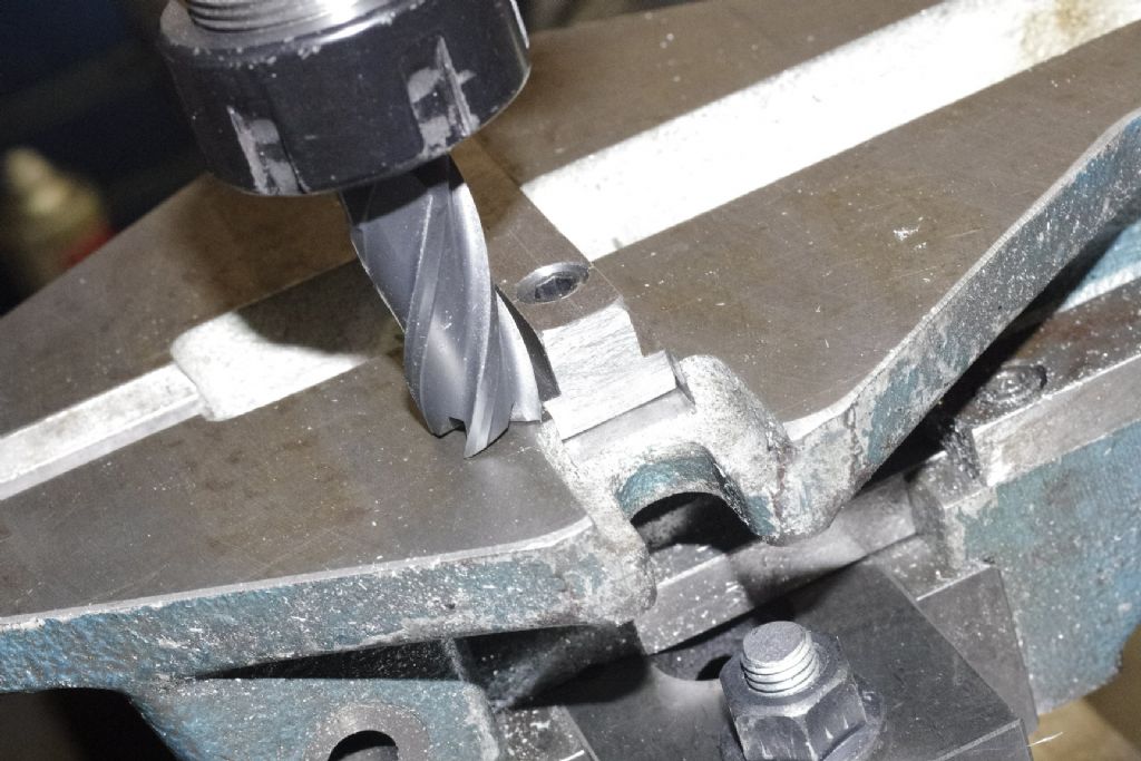

                                          _igp2468.jpg_igp2467.jpg_igp2464.jpgI have cut some metal on the mill at last.
                                          The slots in the bed are 1/2" while the drill mill slots are 5/8". I used the DM to rough out a replacement key for one of the 100mm Bison vises. It had a run across the rear jaw of 0.0015" which is understandable. The pictures show how I got the vise dead on with the X axis, the amount of actual milling amounted to a skim of about 0.002" climb milling on the rear of the key.

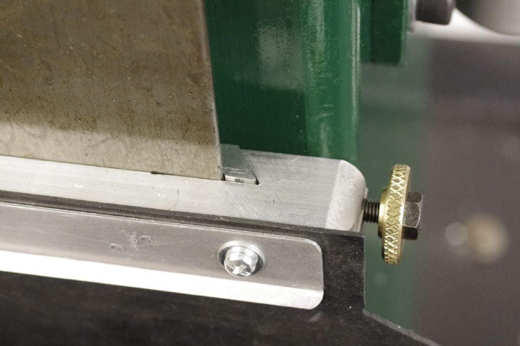

                                            _igp2479.jpg_igp2481.jpgSome more pics of the progress. I fitted the rubber swarf guard which Mike has made. It is a rather poor design which has to be moved up and down when the knee and Y axis are moved, there is really no alternative. The other one has the spindle speeds, please tilt your heads to view._igp2480.jpg

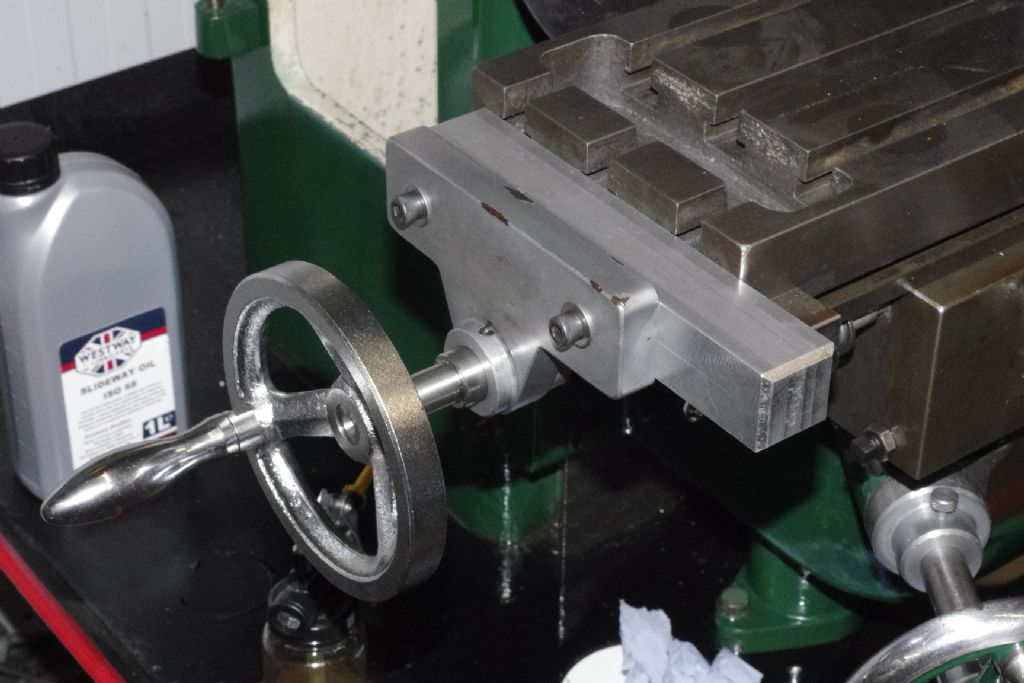

                                              _igp2504.jpgWe pretty well finished putting a handle on the left end of the X axis leadscrew. The aluminium spacer needs to be cut a little shorter._igp2503.jpg
