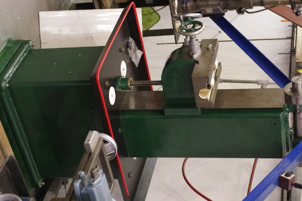

                            The mill is going on a 4" high wood stand with 1/8" aluminium corners to spread the load. This is the maximum we can raise the machine and still just miss the cross bracing for the mezzanine floor above. I'm a great believer in saving my back and the backs of the other oldies who will use it. Short people can make duckboards.
                            At risk of upsetting the purists, I have bought some cans of lawn green Plasticote paint. It is slightly brighter thanTS green, but still has a touch of the grey-green.

                                We have the mill bolted down on the 4" of wood using 12mm studding glued into 4" holes in the concrete floor. The machine is not being fully repainted, just a good abrading of the paint and a spray of Plastikote lawngreen paint. The colour is a brighter green than the top of the can suggests, so not exactly concours, but it seems to be oil resistant. The tray got sprayed Hammerite satin smooth black, and has a red strip surround intended for car doors.
                                We were lucky with the Y axis leadscrew nut, which in conjunction with new metric thrust bearings, seems to have only 0.001" backlash, I haven't checked it with a dti yet. The thrust bearing housing had to be bored deeper and larger diameter to accommodate the larger metric bearings, which are much heavier duty than the originals.

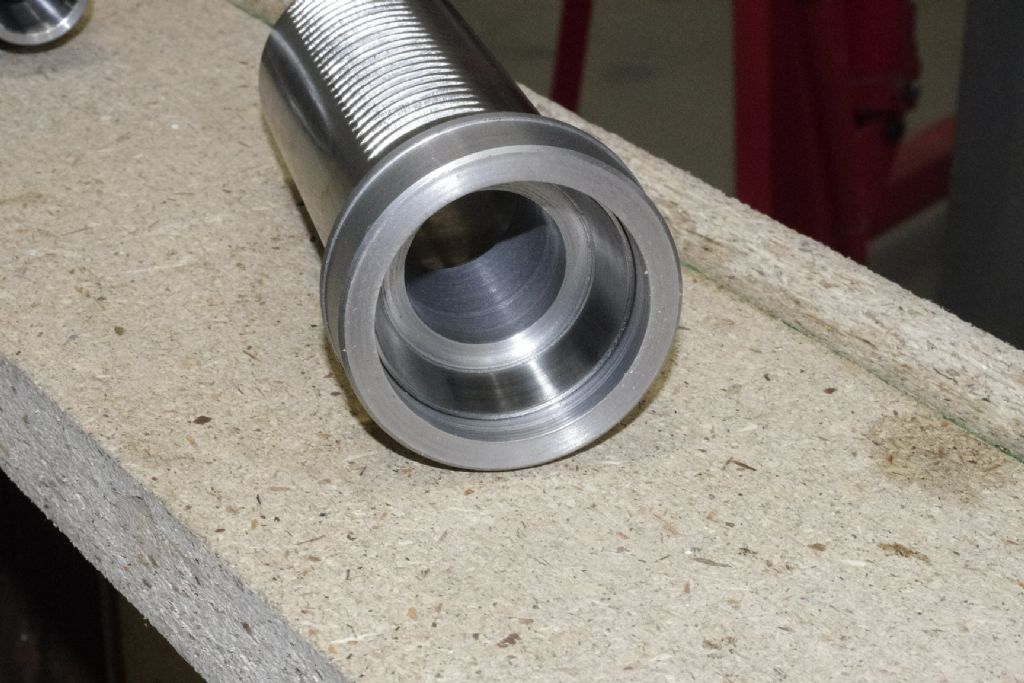

                                              I did some machining on the outrigger bearing holder for the bottom of the quill. It is screwed into the quill body by a 26 W X 2.048" thread, just right for 2" OD taper rollers to fit in the 2" bore. There is a 2" long spigot which just fits the quill bore and a shoulder, which , with the thread and the bore for the spindle, were all turned in one chucking. Trouble started when I turned the work round to finish the external part and the bottom bearing housing. I couldn't quite get everything running exactly within 0.001" tir, even with my best four jaw chuck. Tomorrow I will bore some soft jaws in the Pratt 6 3/4" serrated jaw chuck. Now I am glad that I decided to have a 1.999" by 2" long spigot in the design, plenty to hold in soft jaws, and room to check the shoulder and skim if necessary. Then I will feel confident in getting the concentricity I want.
                                              I have finished the machining of the lower part of the R8 spindle. As the upper half will now be part of the existing spindle, I shortened the lower part, bored it larger, about 20mm diameter and threaded the outer 3/8" long. I used a lefthand threading bar cutting away from the chuck. As the available grooving tools would not quite go down the bore, I used the 16er laydown insert to create a start clearance at the bottom of the thread. There was a quiet ting of the tip fracturing, I had forgotten to put the spindle in reverse. I got the insert turned round and the spindle going the right way and the thread is fine.

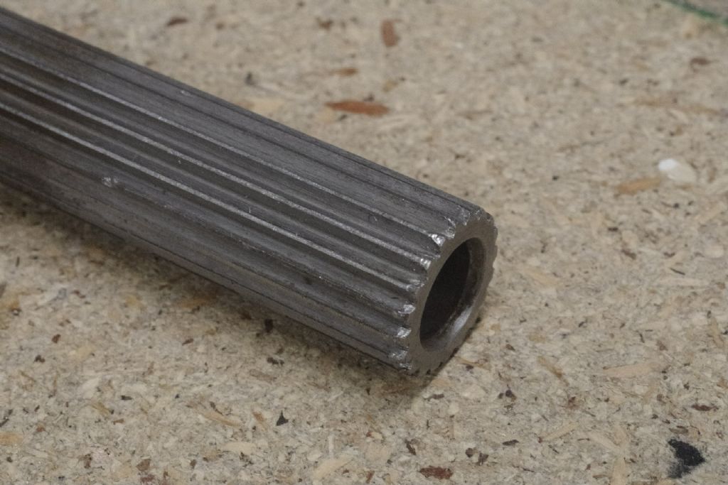

                                              #423315
                                              Simon Williams 3
                                                @simonwilliams3
                                                Many thanks for the fascinating pictures of the needle roller bearing supporting the driven pulley, that looks as if Mr Senior (Senior Junior?) had second thoughts about the bronze plain bearing that I found in mine and went for the needle rollers, presumably for later models.
                                                The other interesting difference is the splined quill shaft – mine is a single long keyway driven by a captive key. I fancy the spline is a much better job, but I guess needs an investment in the appropriate tooling to make it.
                                                Do you have a serial number? Yours must be a later machine than mine.
                                                I've just measured the bore through the quill, I make it 10.9 mm so 7/16 ain't going to go.

                                                    Today, I finished the outrigger lower bearing holder and the spindle. The two halves of the spindle fit with about 0.0006" clearance and screw together. I forgot which thread pitch I had used in the bore of the lower section, and to make matters worse, I have lost my unified thread gauge. I searched the cupboard of unknown measuring equipment and found a little thread gauge with 26 and 28 tpi. It turned out to be 28 tpi. Now I have the two halves screwing together with the minimum of clearance, I now have to wait for the Loctite 620 to arrive.
                                                    Mike made a special spanner to hold the spindle when the drawbar is tightened and released as there is no large pulley to hold in the TS head. He also made a spindle bearing preload adjuster spanner. The design isn't as well thought out as the drill mill as to adjust the bearings, you have to drop the quill out of the head, or take the motor, pulleys and their support off of the head to reach the nut.
                                                    Next week, we will be painting the last parts and I will buy a 1hp six pole three phase motor. The six pole motors run at about 1000 rpm, which with the four speeds by belt and a VFD, will give the range I require, somewhere between 150 and 3000 rpm.
                                                    Now I know that a self extracting drawbar is easy to make when I get round to it. There will be a bronze threaded sleeve with a flange at the lower end, trapped within the spindle and loctited in place.
