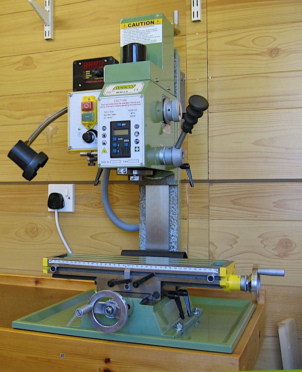

      I recently purchased a Warco WM14 off a friend who had purchased it new but never used it. He kept the Warco stand himself for use as storage so I need to build a stand for the machine; I looked at buying a new stand from Warco however they are out of stock of them, and once delivered would cost more than I paid for the machine itself.
      I still have the swarf tray so was going to fabricate an open sided steel box section stand around the same dimensions as the original stand but try and firm it up a bit and bolt it to the floor (the original stand is to be honest, a rather flimsy affair).
      Are there any do’s and dont’s for building a stand I need to take into account before I start?
      Thanks.

                      I have my WM14 bench mounted. The bench is extremely sturdy built many years ago 4"x2" frame with 18mm chipboard across the whole back and sides. The top is 2 9"x1.5" timber topped with 18mm chipboard. Would take several people to lift it. Bench bolted to concrete floor and the mill on it's tray bolted firmly to the bench.
                      When constructing your stand bear in mind operator access, particularly the height. The Z hand-wheel is on top of the column at the rear. If the stand is too high it can be very difficult to turn. I am 6ft tall and the hand-wheel on mine is only just within the comfort zone the bench being some 35" high. I would prefer it a little lower but the bench came a long time before the mill!

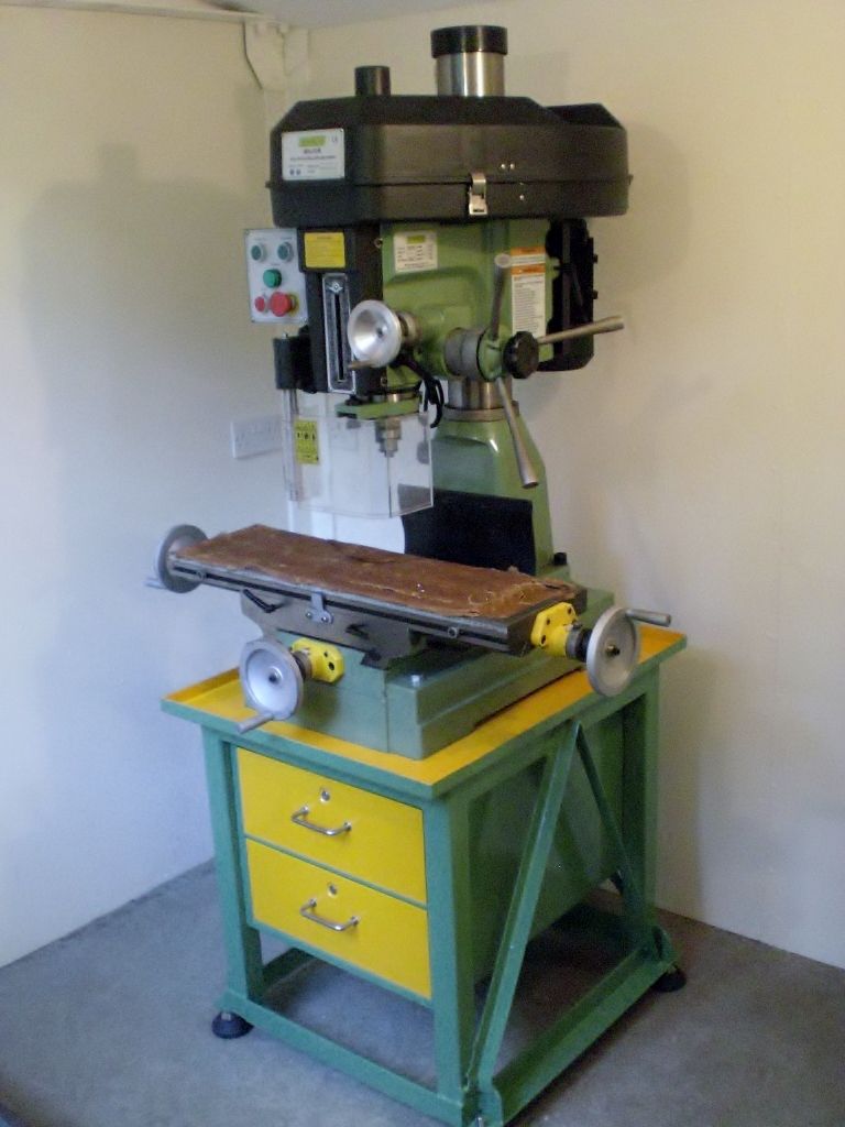

                              Hi, I agree with Andrew Johnston, and here's my stand I made for my Warco Major, it has adjustable feet and is not bolted to anything and hasn't moved during use.
                              I also agree that the footprint on the floor is better when it is wider in both directions, than the machine base.
