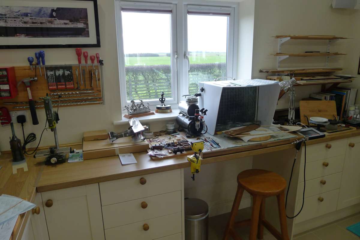

            This is what might be considered a basic set up:
            27-12-22-02FensideBarnWorkshopWorktop2

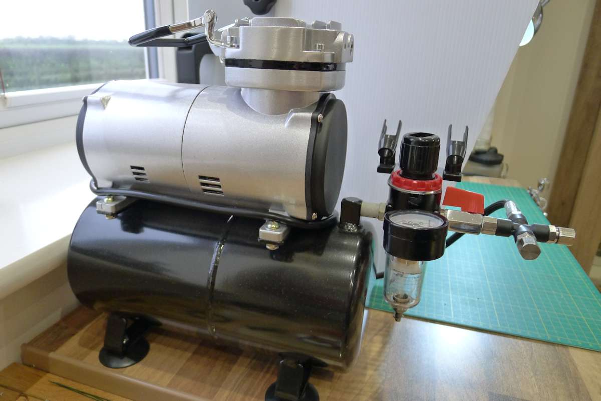

            The compressor is a very cheap diaphragm type but the reducing valve and drier is a much better quality:
            07-12-18-09AirBrushCompressor1

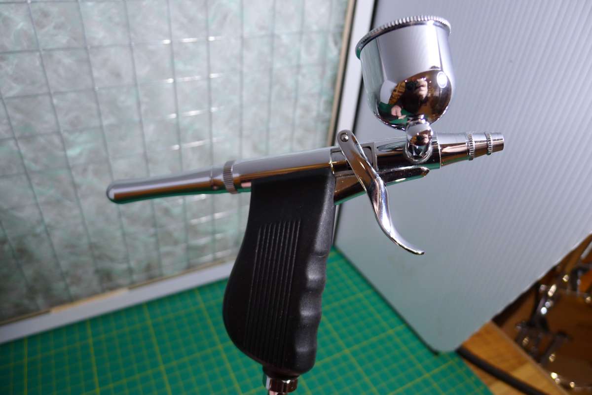

            A really good airbrush for a beginner is the Iwata Revolution TR, which actually combines the dual function into the one trigger and, with the plastic handle, resembles a miniature spray gun rather than an airbrush.  The combined function of the trigger is frequently easier for beginners to operate.  The cup is also a reasonable size for wider areas:
            07-12-18-07IwataRevolutionTRAirbrush2
            Many might suggest a home made extractor, but there are potentially serious consequences if certain safety features are not considered.  The downside of a purchased extractor hood is that they can be very expensive.

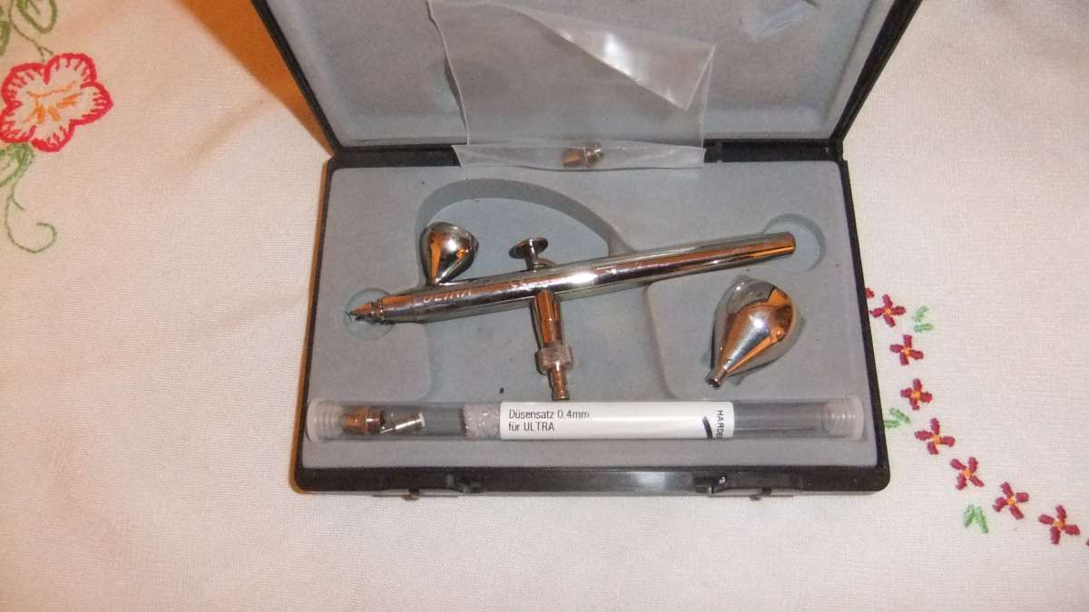

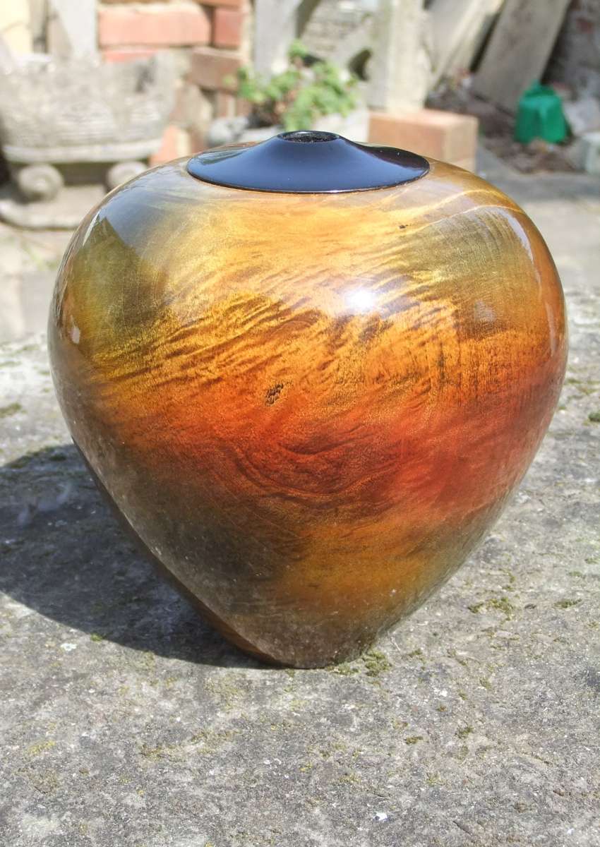

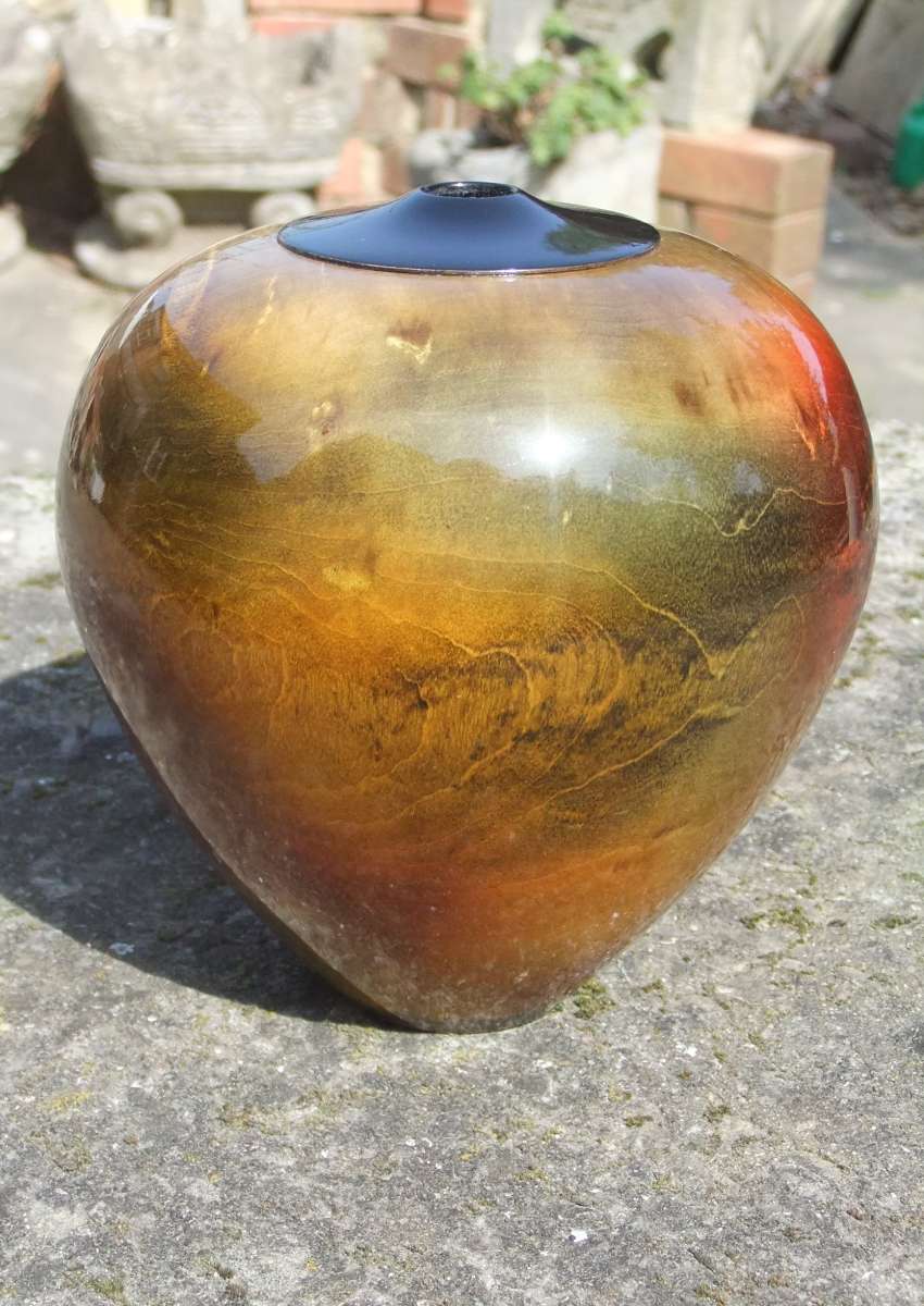

                            I use a similar compressor to Richard, except it has the double head compressor chambers. For things like coloured wood stains I use a cheap air brush. For more elaborate work, I resort to my Harder and steenbeck ultra x.
                            DSCF4493
                            wooden vase using the cheap one with wood stain
                            DSCF1870
                            DSCF1871
