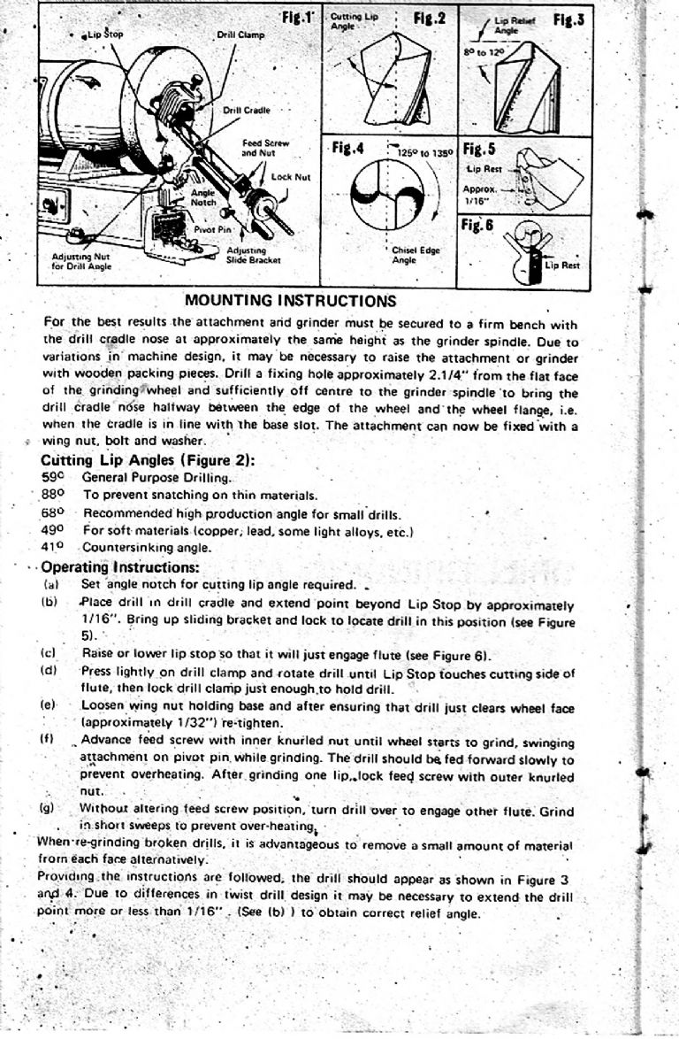

                      John & Sandy,
                      Herewith cover & page 1 of my Spiralux instructions. Apologies for the poor quality, the original is 4″ x 6.5″, scanned by a 1200dpi scanner at 150dpi into Paint Shop Pro, contrast increased and sharpened with the Unsharp mask, finally increased in size to 8″ x 12″ and then uploaded. I don’t know how to make it larger in the forum.  Perhaps if you want a better copy, then we will have to do it by private email – [email protected], but not until Sunday pm at the earliest (going to collect my caravan tomorrow!)
                      Regards,
                      Peter G. Shaw

                          Peter
                          Thank for the instructions – perfectly readable.

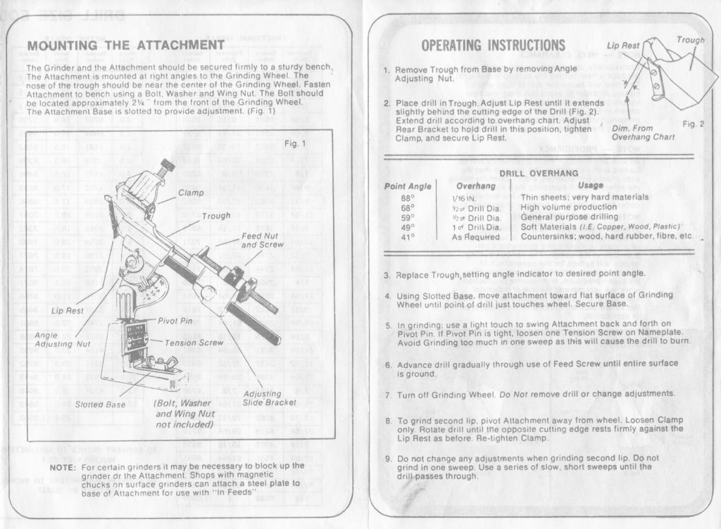

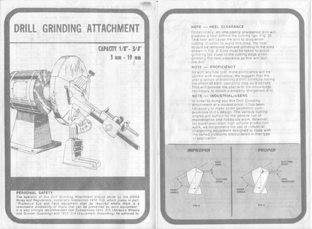

                          _Paul_
                            @_paul_
                            Here is another variation on the instructions:
                            This particular one bought about a year ago from a well known UK vendor.
                            Regards
                            Paul Floyd

                              My attachment is the same as Paul’s.
