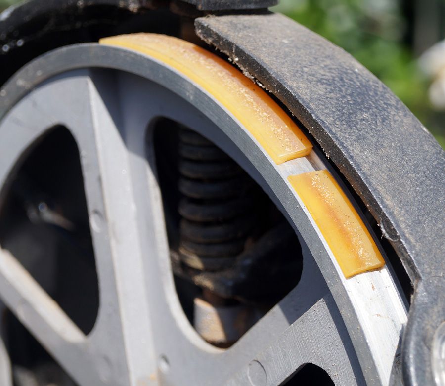

      A picture below of whats left of the drive wheel tyres on my cheapie brand bandsaw. I dug it out of the shed this morning in whats probably 10 years since it saw the light of day. The saw is in very good condition considering the time its been hidden away but as you can see the wheel tyres have dried up and completely perished.
      I have no idea of the make of the saw but it is probably Chinese or Indian. I know there are suppliers where you can get various sizes of blade but wondered if anyone knows if its possible to get hold of other spares and if so from where..?

          Hi Ron. It might be worth letting people know the diameter and width of the wheel then you might get info on other makes that are a similar size from whom you might get a tyre.

            Ron – just had to do a similar repair to my VERY old Naerok. A spare leather trouser belt which had obviously shrunk over the years wink, was sliced to width and scarfed to length, super glued at one end, 'Sticks like…' glued around the wheel rim and finally super glued at the other end. Left to set overnight and all was as JS's mantra!

                I have made a band using sheet black rubber. Cut a strip a touch undersize Scarf the joint with cyano and once fixed pull over the wheel.
                I don't think you have a cats chance in hell of finding a spare.

                  I tyred the wheels on my home-made bandsaw with Pirelli rubber upholstery webbing, cut to suit. Glued it onto the aluminium wheels with Evostick contact adhesive. That was many years ago. Still going strong, albeit looking a bit tired looking by now; (sorry!)

                    It seems that the tyres are made of Urethane and from what I,ve seen so far they are not cheap, depending on size, £50 or more for a pair of tyres….?
                    Will see what tomorrow brings but I may be buying some rubber strip and making my own.
                    The tyres I am looking for are 233 mm dia x 12 mm wide x 2,5mm thick.

                      I used strips of car gasket material, the stuff often used on sumps, made from granulated rubber and cork, bonded together. These are glued onto the wheels with plain old UHU contact adhesive from poundland. The gasket is available in sheet form from some car spares or is often seen at steam rallies.
                      It works perfectly well, with the blade staying on the wheels and doesn't slip.

                          I had the same problem with my band saw. I bought some neoprene rubber strip from ebay and cut it to the correct width and made a scarf joint and then superglue it to make a new tyre. It has been satisfactory for at least a year.

                              Funny – the generic 4×6 Chinesium bandsaw doesn't use these tires / tyres – the blade runs directly on the cast iron drive wheel. Yours may well work without needing a replacement if you remove the perished remnants. Just a thought….

                                I found that it didn't take long for the wheels to flatten the tooth set on the inside of the blade, and yes it was the wheels, not the 45° twisting bearings.
                                Also I'd suggest that with aluminium wheels, the blades might start eroding the wheels. At least tyres, home made or otherwise, have a bit of give in them.

                                    I have a 14" Tauco bandsaw that had the same problem. Tauco was the "overseas" name for Delta, an American company. I searched the internet for replacement "tires" and found them to be readily available from the US but with shipping and possible import duty the price was excessive. I could not find a souce in the UK.
                                    Then the club's Axminster bandsaw tyres disintegrated so I contacted them re replacements. Naturally the particular saw was no longer available but the guy in their spares dept (Kevin?) was brilliant and he managed to sort me out. I asked him about tyres for my Tauco and he suggested ebay but warned about the price as they come from the good old US of A. Then he suggested taking one of my wheels to their showroom and comparing it to their current range, well, you never know!
                                    Well, one machine used tyres of exactly the same width but slightly different diameter, within 5 mm or so. I ordered as set and they fitted like a glove. They are very stretchy and would have fitted quite a wide range of diameters.
                                    There are several youtube videos showing how to fit the tyres involving boiling in water for 15 minutes etc. This was totally unnecessary, It took seconds for two of us to fit all 4 tyres.

                                      I have just spoken to Axminster but they cant help, they have a belt which is the right size but it is a "T" shaped belt and mine are flat.
                                      So I have just ordered some solid neoprene rubber strip from ebay and will give it a go at making my own. The strip I have ordered is reinforced with cotton and sounds quite hard wearing so hopefully it will do the job.

                                            Well at the risk of seeming more stupid than I am, I will own up and say I found the make and model number of the saw. In my defence, when I carried the saw from the shed to the bench the label was facing away from me and as soon as I put the saw on the bench I opened the hinged cover, again away from me. This morning I closed the cover and there was the make and model number label as clear as day.
                                            Anyway, surprise, surprise I have found the tyres and a new toothed drive belt on line from Solent Tools. The make is NuTool and model number HBS9-4, as soon as I googled the make and model quite a few links came up.
                                            I still have the rubber sheet on the way but I can hold on to that for future use should I need it.
                                            So happy I have found the correct tyres and a new drive belt but feeling a bit of an idiot for not looking for the makers label which was in an obvious place.
