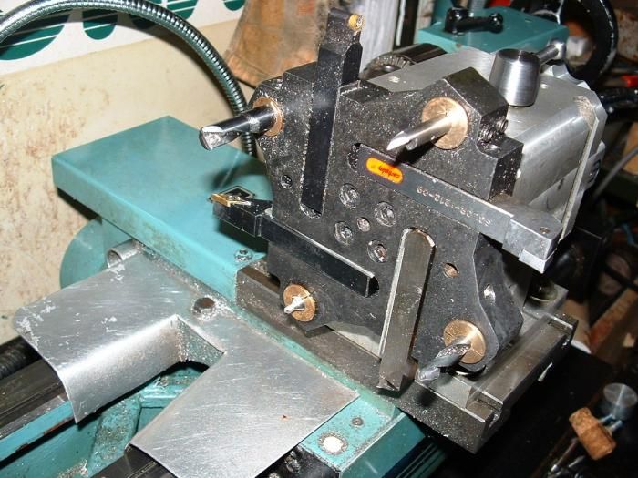

                                #293224
                                Emgee
                                  @emgee
                                  See my Album for more pictures of the manual 8 position Tool Turret mentioned earlier.
                                  #293228
                                  Emgee
                                    @emgee
                                    Posted by Martin Connelly on 13/04/2017 14:06:31:
                                    For the occasional use I can envision a simple tool changer that is manually moved to each position. All that would be required in the CNC code is a pause using M0 with a comment saying something like "change to 60° threading tool then press cycle start". I don't think my quick change tool post is quite up to the repeat accuracy required but that may not be the case with all of them. This is similar to the tailstock turret system where the required tool is rotated into position by hand as it is needed.
                                    Regarding the pawl in the earlier picture I thought there was a possibility that there was dirt on it that looked like a crack. I also think it looks a little too slender for the loads that will be imposed on it and if not already cracked then it would probably happen at some point in the future.
                                    Martin C.
                                    Martin, thats exactly how I use the manual Turret pictured above, time between tool changes is less than 10 secs including the moves off the job and back to cutting position.
                                    It is recommended for users of the Emco 5 cnc turret that the locking plate is replaced with something thicker than 3mm, there is plenty of room for a 6mm thick plate if you want to go OTT.
                                    In use the motor driving the toolchanger is constantly ON, after rotating to the tool position the 12VDC motor reverses at a lower voltage to drive the pawl onto the locking plate and the motor remains ON but at the lower voltage of 6VDC
                                    Emgee

                                          There is one thing of particular interest, how the lathe tools are retained. Presumably they are jacked up against the 'top' face of their slot (machined to be at or slightly above lathe centreline) by two grub screws passing on either side of the axial tool collet aperture. Which would imply all cutting forces going through the screws. Possible, but I wouldn't have thought it 'good' practice as the tool itself is given relatively little support compared to standard fitting methods. The other option of clamping the tool down would need a wild muddle of long holes through the body of the plate.
                                          Regards,
                                          Richard
                                          #293274
                                          Emgee
                                            @emgee
                                            Hi Richard
                                            Yes the tools are retained by 2 upward facing 6mm grub screws which does not present any problems. You can machine wider slots and use a tapered wedge to force the tool upwards, this would be a better method but much more work for in my case no gain as no really heavy cuts are made, this is a hobby for me.
                                            The round tools are held in 1/2" diam split brass collets, clamped by 2 M6 grub screws.
                                            The design is not mine, the drawings on HIMEM site are from the Emco PC50 lathe tool turrett and is ideal if using a 3" chuck, if using anything larger care is needed to ensure no tool projects to clash with the chuck, especially if the jaws extend more than the chuck OD. More likely to happen when turning small diameters.
                                            The problem of tools clashing when using chucks larger than 3" can be overcome by making a larger diameter tool plate placing the tools at greater diameter than the chuck OD.
