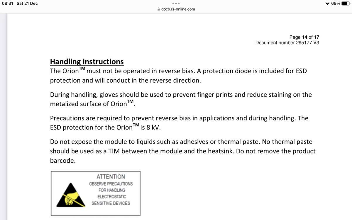

      I have never understood why, Noel … but please note that the use of such membranes is explicitly rejected in the data-sheet.
      Ref. [repeated for convenience]
      https://docs.rs-online.com/3995/0900766b8161ece2.pdf
          MY ERROR ^^^
          It is Thermal Pastes that are explicitly rejected

            Thank you Michael, It was because I had studied the data sheets that I am intent on using membrane rather than the paste I have tubes of ! The machined faces of both the heatsink and the LED unit are a very close fit but in an effort to avoid the risk of my lovely LEDs producing strange smelling smoke I would rather be safe. The 3 holding screws will ensure a good contact but a small dob in the middle would do little harm – the risk of paste creep is in the context of a LARGE DOB I fancy ? Time will tell. Noel.

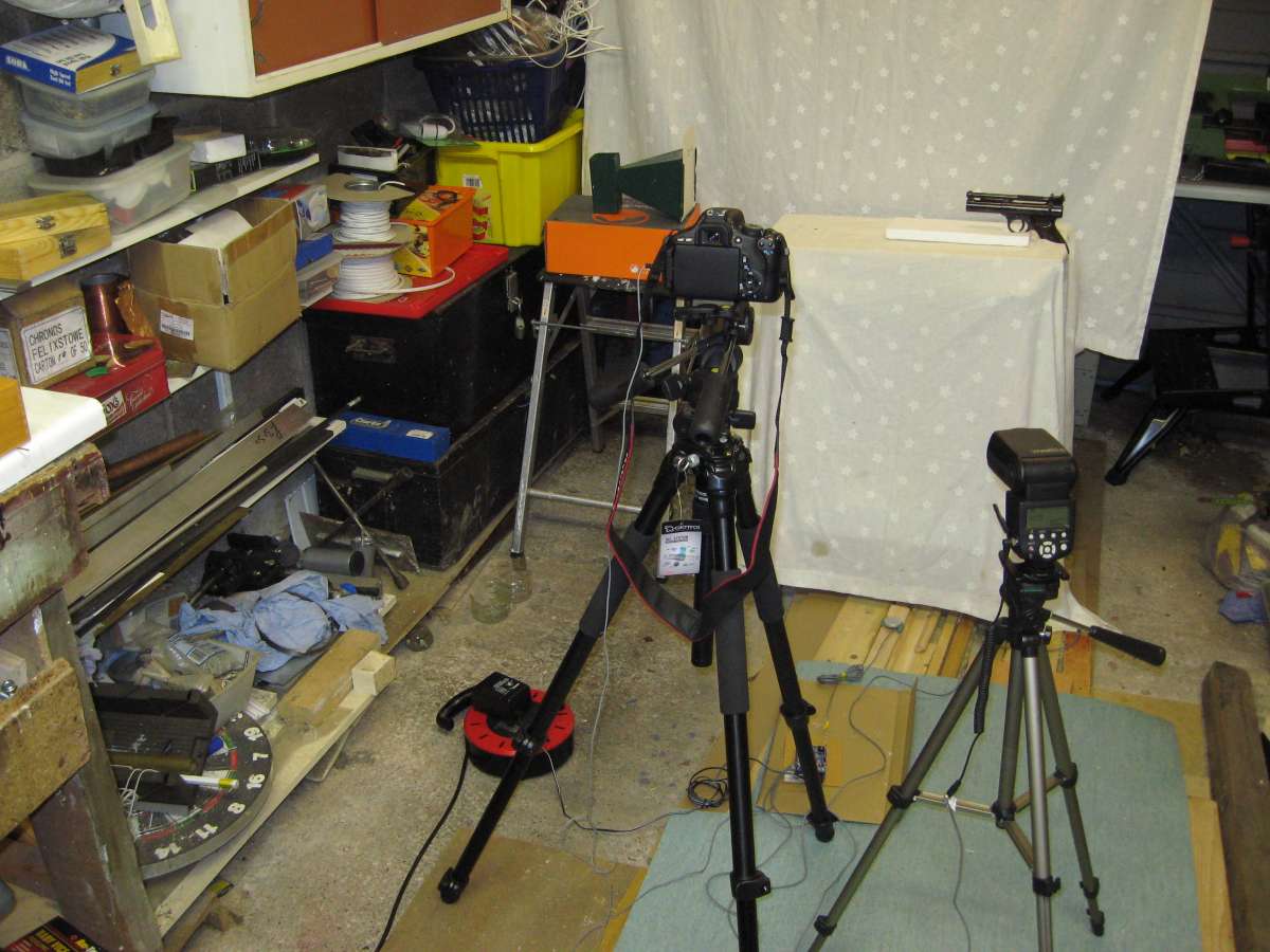

                Could you provide more detail please Robert?  I’ve been dithering about using one or more of these lights in an attempt to improve on my early high-speed photographic experiments, for which a high speed flash is needed.
                I used a camera, flash, Arduino, and microphone to catch events like this airgun pellet destroying some water filled plastic tumblers – can you see the pellet:
                IMG_1630
                Here’s the setup:
                IMG_2719
                Operation: The room is darkened.  Starting the Arduino opens the camera’s shutter in ‘B’ mode.   Firing the pistol is picked up by a microphone connected to the Arduino, which having heard the pistol fires the flash, closes the shutter and puts the lights back on.  The exact timing can be varied by the Arduino, and with luck and judgement the flash catches the event at the right moment.

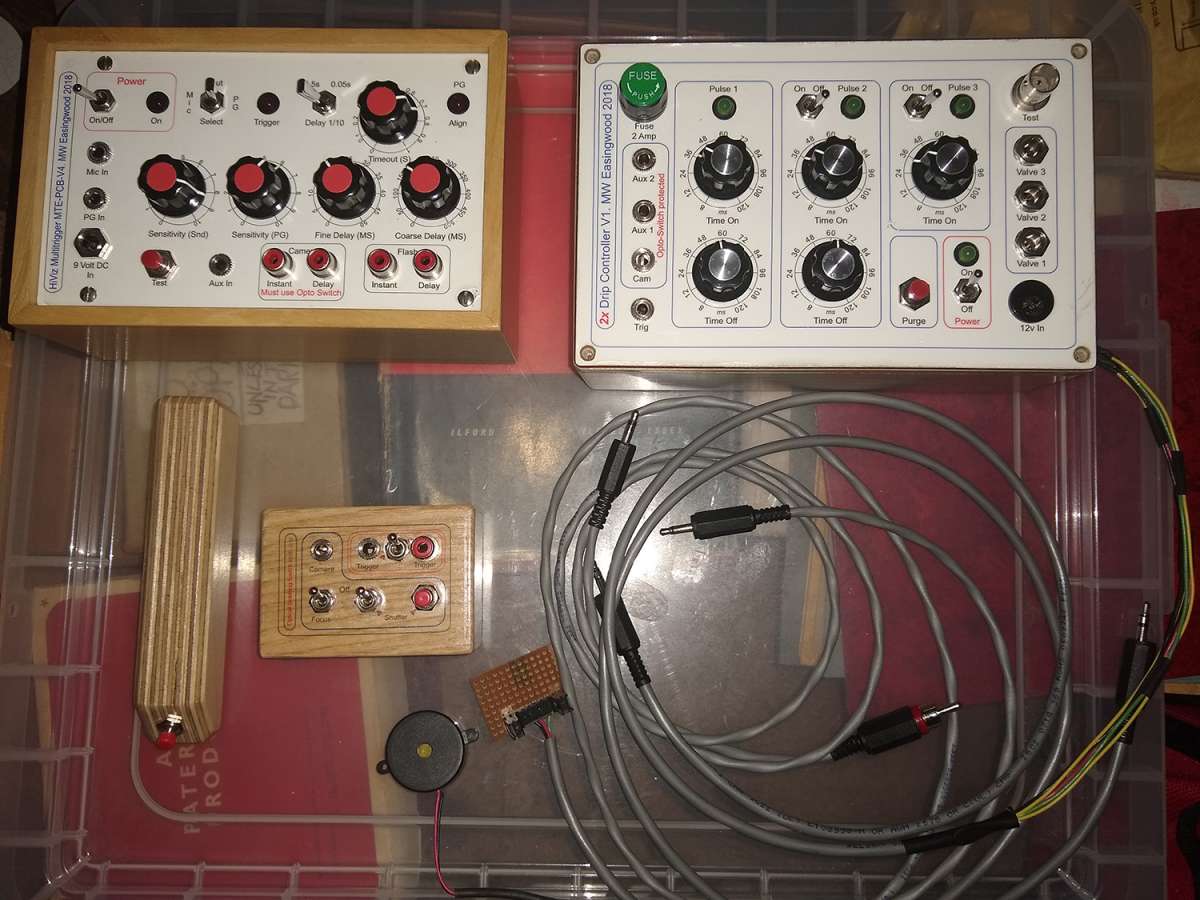

                        Dave, I have no knowledge of electronics, and can’t help with your LED’s, but I have had some experience with triggering off camera flashes.
                        I bought a trigger kit from Hi-Viz in the USA back in about 2011, then decided my soldering skills were not good enough so it was left on a shelf. Then about 6 year back I had a few days at home due to a work related left hand injury. I decided to solder some electronic items, including assembling the trigger device, as self prescribed hand physio, a bit of a challenge with bandaged fingers!

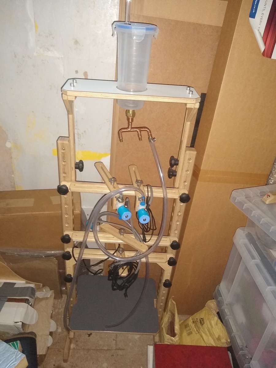

                        I then went on to build a triple solenoid water drop device and controller, drawn up in KiCad and built on strip board. I took some pictures using this equipment, but then it got packed away before I fully utilised it’s potential. I think I also had a reliability issue, bad connection, or my dodgy soldering.
                        I think the trigger unit has been upgraded since 2011. Lots of info on this site Hi-Viz. Either sound or movement can be used as a trigger.
                        IMG_20241223_150018359
                        IMG_20241223_145835321
                        IMG_2445[1]
