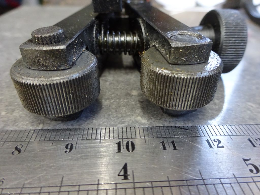

                  I would call the ones that I used in the above photo Fine, there is nothing written on them. Work is 14mm dia
                  If you set the tool a Rod describes by clamping it onto the work, retracting and tightening the clamp screw before feeding into the slowly rotating work you may find it best to do this a few times slightly turning the screw each time to make the knurl deeper. This will strain the machine less that trying to do it all in one go.

                    Thanks Jason, Yes they look similar to mine. I am going to try on some narrower stock and see if that improves also since I have been trying on 20mm which is just beyond the maximum limit (which is stated as 19mm for this design If I recall correctly) I had to reverse the clamping screw to squeeze it so I could get a decent bite on the threads.
