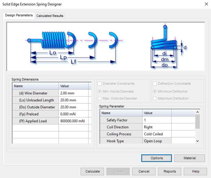

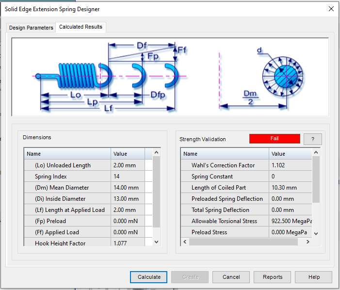

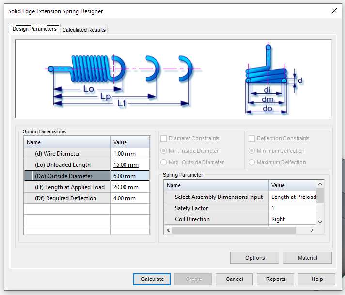

      Anyone understand how SE’s Extension Spring Designer tool works?
      It’s in the ‘Tools->Engineering Reference’ collection.  Looks straightforward.  In this example I’ve told it to calculate the load needed to extend a given spring:
      SEspringdesigner
      Problem is when I press calculate, I get a red FAIL error and SE won’t create the spring.
      SEspringfail
      The other design options fail too.  Either my spring requirements are breaking a hidden rule or maybe I don’t understand what I’m doing.
      The spring I want is nothing special, a hooked extension spring 5mm diameter about 15mm long fully extended in 1mm wire.

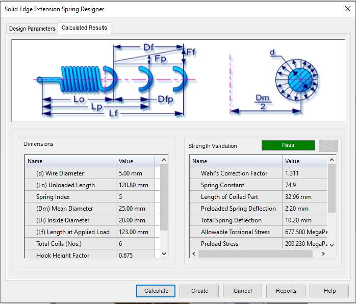

      The tool isn’t disabled: SE’s default settings for a large spring work:
      sespringOK
      Result: Green Pass!
      SEspringOKPass

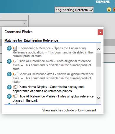

              On David Jupp Said:
              Doesn’t the Help button do so?
              Er, what Help Button?

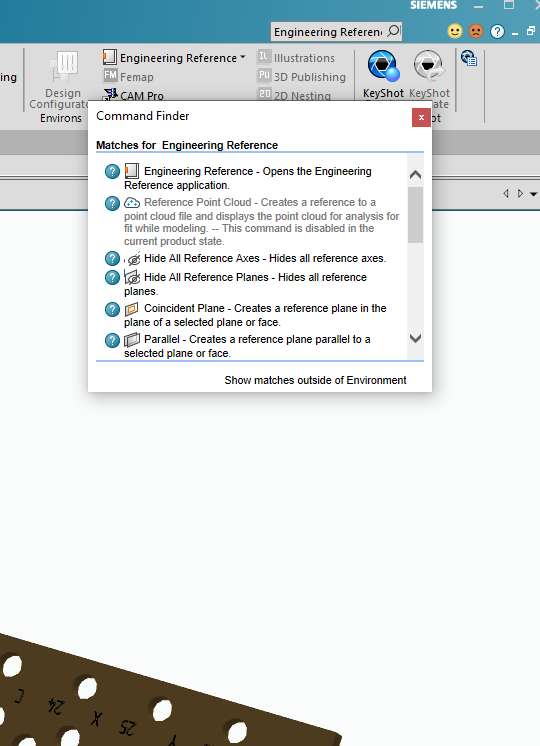

              With a part open for edit I looked Engineering Reference up with the command search and got this result:
              sespringfinder
              Greyed out and tagged ‘This command is disabled in the current product state’.   Might be because the tool creates a new part, and dropping onto an existing one is daft.
              Switch to an Assembly edit, and it comes alive:
              sesprindalive

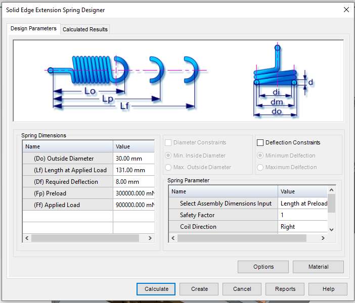

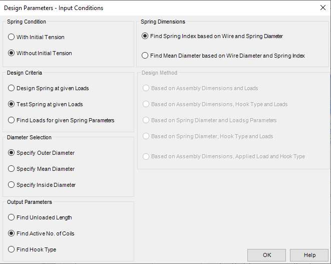

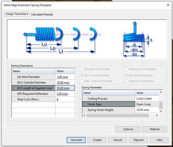

                Managed to get to the tool, and can get a green PASS if the number of coils is specified (actually defaults to 10) and the hook type is one of the things you are looking for?? Not sure if this helps?
                Options selected were:
                SEOptions
                EDIT – whilst creating this post, Dave posted again – maybe the Help referred to is the little question mark near the Pass/Fail result?

                    Remembering my requirement is ‘The spring I want is nothing special, a hooked extension spring 5mm diameter about 15mm long fully extended in 1mm wire.’
                    Playing around this is the smallest PASS spring I could make, 55mm long, way too big:
                    sesmallestspring

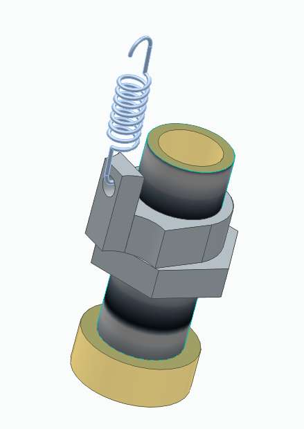

                    The spring is part of the socket assembly, and it’s gigantic in comparison:
                    semassive
                    Looks like the SE Spring designer may not be able to generate small springs.  I guess the parameters have to be met within the Lo, Lp, and Lf dimensions, with a minimum wire diameter of 1mm (too big for me really), and meet the other spring requirements.

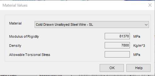

                      Dave – try changing the material. I’ve just swapped to phosphor bronze and you get a choice of much smaller diameters.

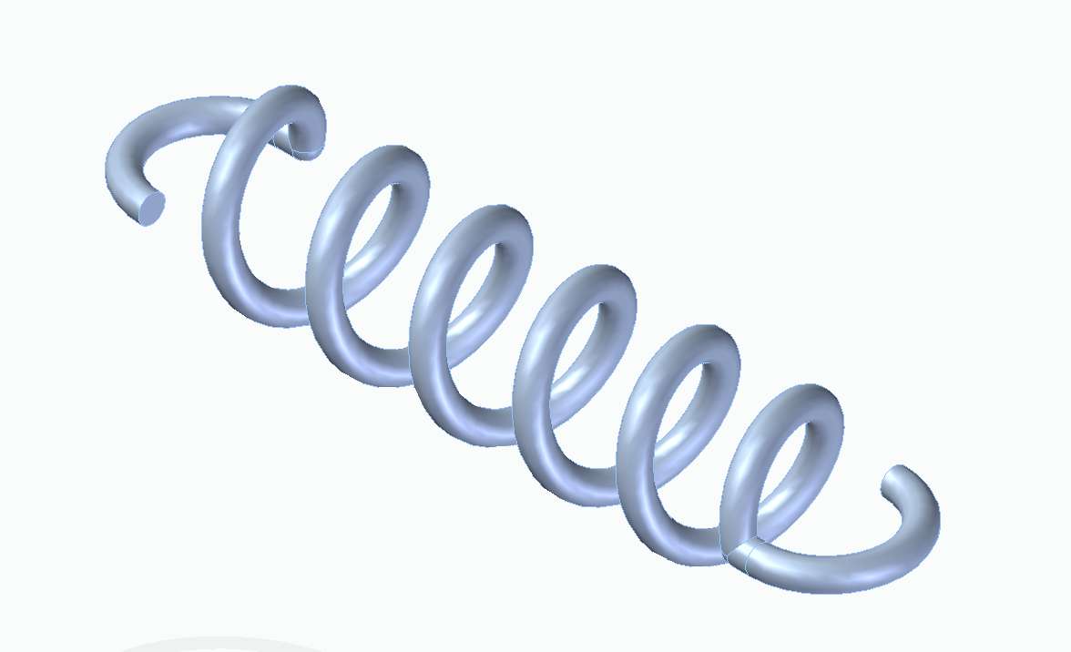

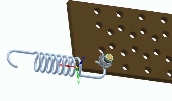

                        Scaling works, x0.15, as does hooking the spring in place with SE’s steering wheel tool.
                        enigmasocketwithspring
                        New, problem.  Now the result is on screen, it’s apparent the sockets are very cramped.  The whole model is about half scale, causing various problems.   Looks OK, except I might have to start again.   I suspect simply scaling all the parts by x2 will break most of the assembly constraints.   SE doesn’t appear to support scaling an assembly with sub-assemblies all in one go.

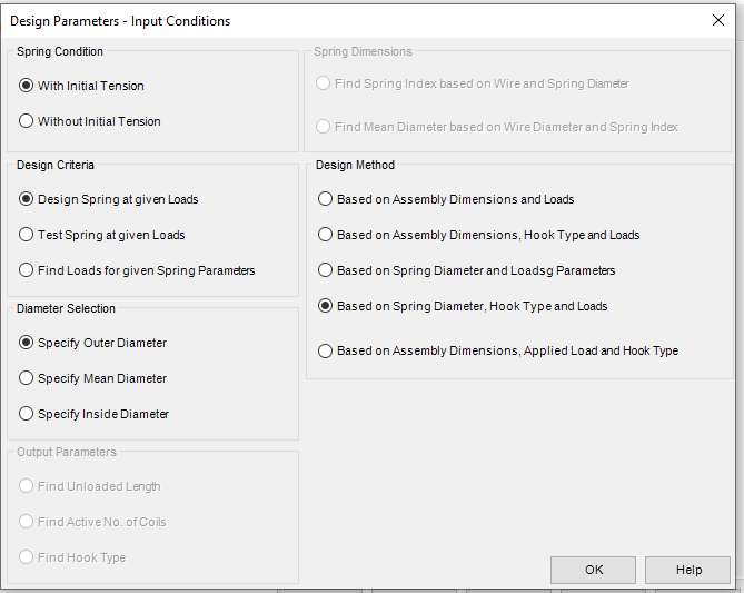

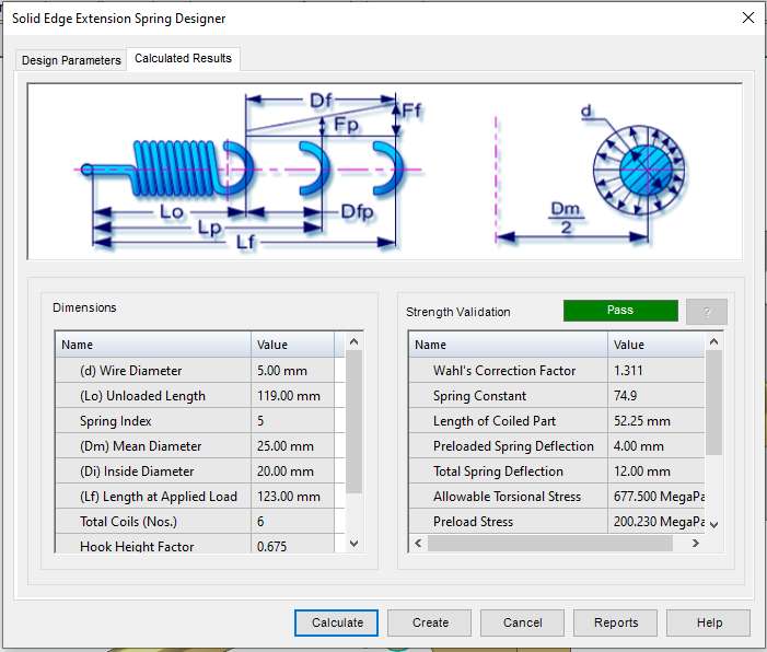

                                    Here’s an example that works with SE default inputs:
                                    First the start conditions:
                                    springOptions
                                    Second, the materials, a long list:
                                    springmaterials
                                    Third, the input parameters.  These are SE defaults and work, note the spring is huge compared with what I want!
                                    springSEexa
                                    Pressing ‘Calculate’ produces a shower of numbers, and a PASS:
                                    springCalcResult
                                    Pressing ‘Create’ generates the expected big spring:
                                    bigspring

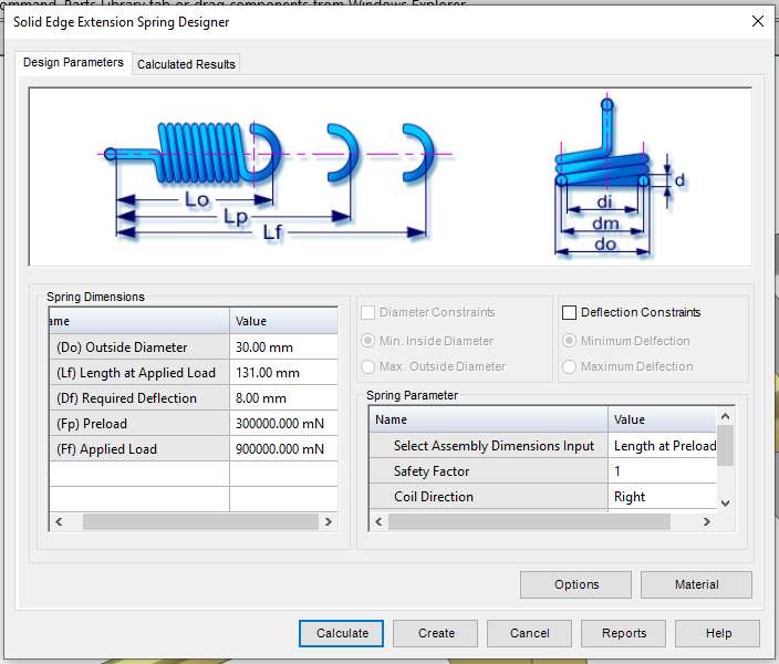

                                    My problem is, what inputs should I specify to get a small weak spring.  And then, cos I like to understand if I can grasp it, what do the inputs mean?  This attempt fails, and it doesn’t seem unreasonable to me.
                                    springSmallFail
                                    Delighted to be told I’m doing something obviously daft!  Not had anything to do with springs since Hooke’s Law over 50 years ago, when I was thinking about girls…

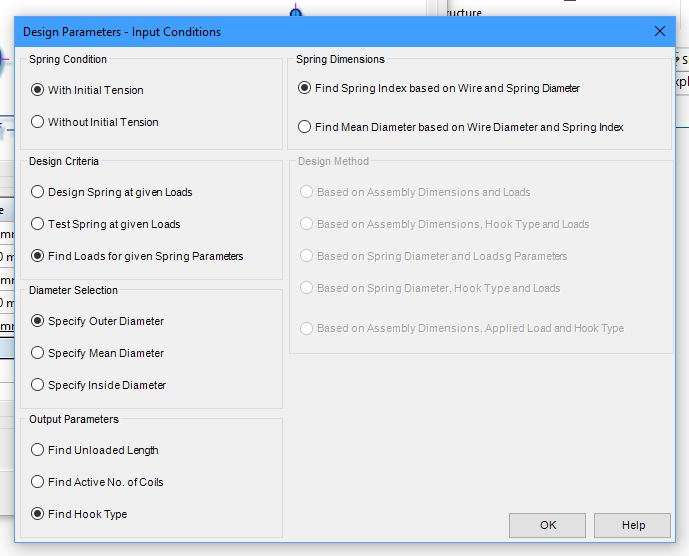

                                                Reporting back after a couple of hours stretching my brain yesterday!
                                                As far as I can tell the Solid Edge Spring Designer doesn’t accept the parameters Chris lists, so no joy.   Looks as if the software doesn’t support the design method allowed by Chris’s nomographs.   Instead, and depending on the option selected, SE offers a list of mandatory parameters. I can’t pick and choose from them.  For example, wire diameter is usually an output, not an input.
                                                Here’s an example that takes wire diameter as an input:
                                                springOptions
                                                Asks for:
                                                springParsAllowed
                                                The values suggested by Chris result in a FAIL calculation, possibly because they were massaged by me so they can be plugged into the calculator.  And I don’t understand what I’m doing…   Time to think again.

                                                      Thanks for trying Chris.  I feel better now someone who knows about springs can’t tune into the SE tool either!
                                                      From what I see, I think the SE tool is inflexible. It designs springs starting with the load, preload and some dimensions.  And if the load cannot be met within the dimensions and other parameters, it won’t create a spring, and doesn’t highlight why not.   Might be because it calculates big springs, and my springs are all small.   I’m baffled!
