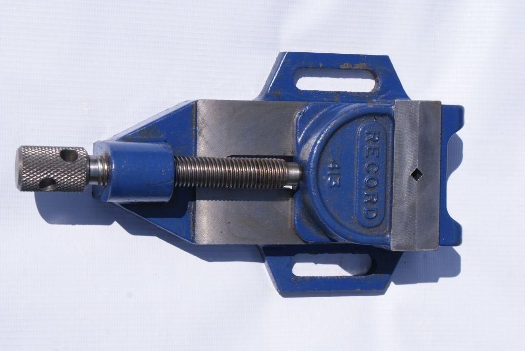

                      That style of vice doesn't have the long guides required to keep the moving jaw 'square', instead it will have a small amount of play. This makes it almost inevitable that the jaws will not close parallel with no impact on the vice's function.
                      The 'narrow guide principle' basically means that if that vice was made the short guides (compared to the distance between them) close enough to stop the jaw moving out of parallel, it would jam at the drop of a hat.
                      If you want a drill vice that does close parallel, you need one like I am testing at the moment – the kind with long guides, more like a milling vice. You can see the guide sections are about the same length as the distance between them. So far I would say this vice is better made than many cheaper vices sold as 'also suitable for light milling':

                          A vice of the type linked to in the original post is not generally meant to close in a perfectly parallel manner. The moveable jaw is usually a loose fit on the screw and in the guiding slots at the bottom so it can tilt from side to side a few degrees. This means the job is held firm against the fixed jaw, regardless of whether the job is perfectly square or not.
                          What you probably need to do is have a look at the ball joint — or whatever it has — on the end of the screw where it goes into the jaw and make sure it is loose fitting and allows the jaw to pivot. Then check where the moving jaw fits into the guiding slot on the bottom and make sure it has clearance there to allow it to pivot a few degrees. Sometimes its the plate that bolts onto the moving jaw underneath the vice body ways that needs adjusting too. Best to set that up so it is neat fit vertically to stop the moving jaw from lifting when tightened but so it allows a few degrees of movement when viewed from above so the moving jaw can self-align to the job.
                          You can see the principle taken to extreme on the Record drill vice below. The screw does not attach to the moving jaw, just bears on the half-round casting, allowing the jaw to cant to whatever angle is needed to match the job. BTW the pic was picked up from Gumtree UK so you could buy it for 15 quid and have a decent vice. (No connection to me etc other than having used one myself for years with complete satisfaction.)
                          But I think that if you loosen up the moving jaw on your present  vice so it can self-align when tightened, you will be ok.
                          Edited By Hopper on 11/06/2018 02:52:51
                          Edited By Hopper on 11/06/2018 02:59:05

                            In this case a 'precision ground base' which I read to mean that its is well finished and parallel top and bottom.
                            There is no need or requirement for the jaws to remain parallel on this type of vice.
