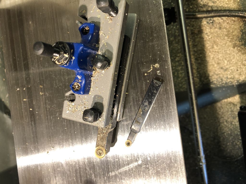

      Help needed please.
      I am trying to turn down a small length of 22 mm diameter brass bar on my Myford super 7. As I am getting closer to the 12 mm diameter size I want, the surface finish is looking more like thread cutting . I have a new cutting tool in the quick change holder but I cannot get the cutting edge to go down to the center line. Could this be the problem. I get the impression that the cutting tool is trying to push the brass out of the way as apposed to cutting it. I have tried several different shaped cutting tools but all with the same result. Anybody else had this problem. Mike

                Almost 100% sure the tool-height is the cause. (too high is worse than too low).
                The problem is the curve of the work fits into the rake under the tool effectively removing it and rubbing the end of the tool on the work. At large diameters a small height error won't matter much, but the bad effects become more severe as the tool gets closer to the centre. Eventually the tool tip would be above the work and not cutting at all.
                Can you post a photo of the tool and tool-holder? You need to get the tool point down to centre height, perhaps by grinding off the bottom of the tool shank, or it may be a QCTP adjustment.

                    When I started cutting, the brass was coming of as a fine chips , so I assume its the right brass. I tried a flat topped tool but results where the same. It would indeed seem the trouble is the height of the tool. I am only about half a millimeter above the center line but I have no more adjustment in my holder. I am trying to find a thinner tool before I can try again.

                      Have you surfaced the end of the bar with the cutter in use? That will easily confirm if the tool is not exactly on centre height by leaving a nipple at the centre.

                        0.5 mm on dia 12 is a massive amount too high, but less significant at dia. 22 that’s the problem. And why the chips flew off correctly at the start of machining.
                        What type of tool is it carbide, interchangeable it Hs?
                        What shape is the tool?
                        what is the tip radius? Is it flat topped?
                        More information required for a proper answer. Perhaps if the shank of the tool is soft (test with the corner of a file, it should not slide over the tool) so it can be machined down so your tool post can use it otherwise it’s probably junk to you

                            I managed to find a thinner tool ,with this adjusted to a center height the finish is now like glass. Thanks so much for your help, this really is a great forum for novices like myself.
