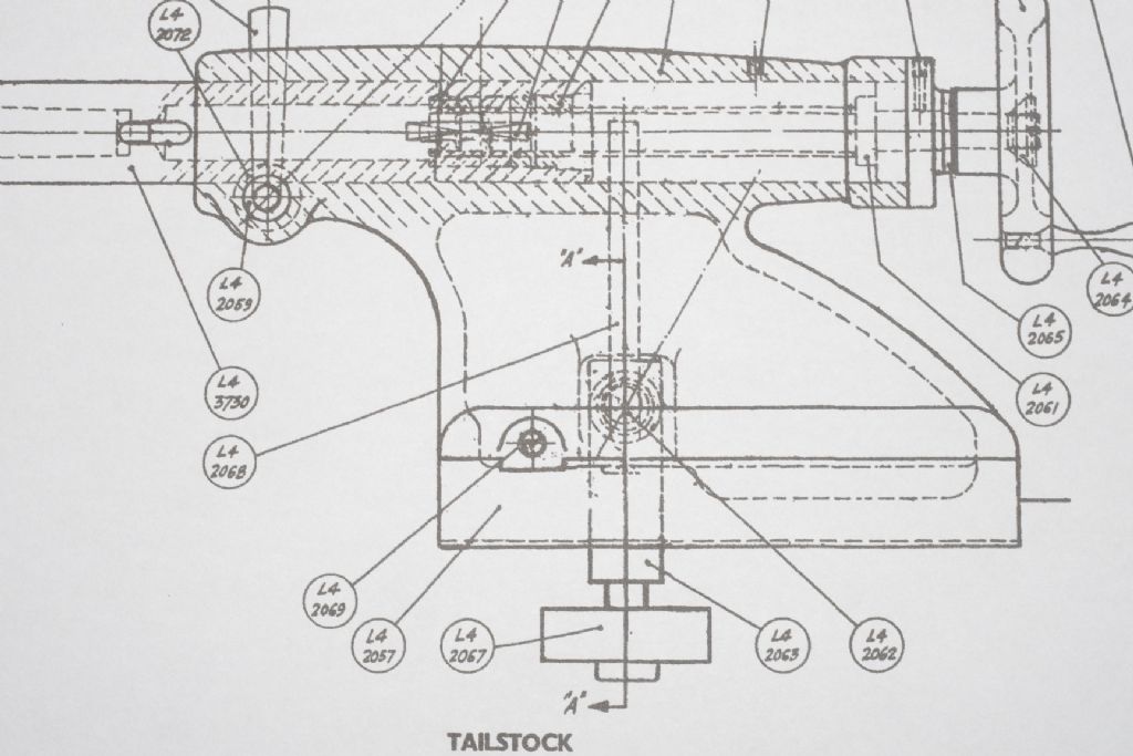

      Hello to all. I am in need of either sourcing a lever or making a eccentric lever for my Smart & Brown tailstock ,,clamp To bed.. Does anybody have a drawing I can copy please?

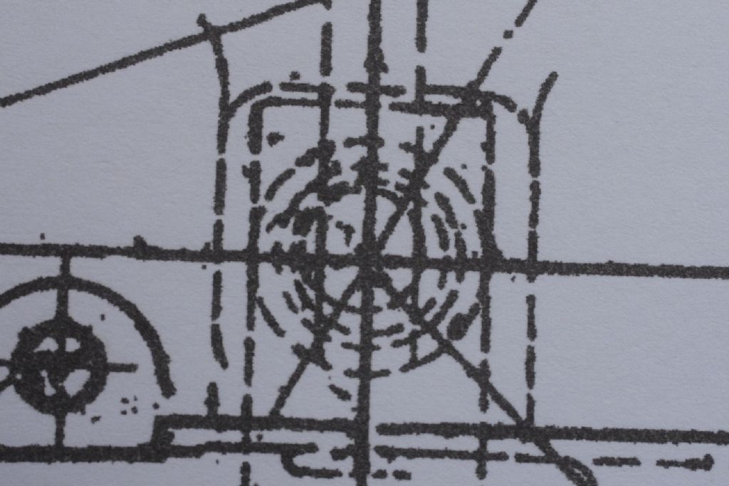

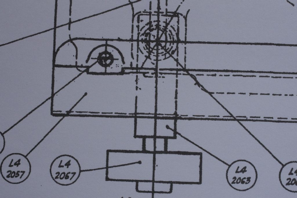

                  _igp2924.jpg_igp2923.jpgI have a parts drawing of the model A tailstock, no dimensions unfortunately but it probably is similar to yours.
                  #597187
                  Bootlegger Blacky
                    @bootleggerblacky
                    Thank you for posting the parts drawings..looks like I need to make the…L4/2062 bit.
                    Although my S&B is a simple model “L”. Most of the castings have a number that start with “L4/xxx” so I do think there are similarities between models.yes,Clive..eccentric is more difficult to spell. Thanks.

                          At the bottom of the model A drawing is shown the head of a SHCS which is used to adjust the point of clamping, it screws into the L4 2063. Unfortunately, I would not want to take the museum's tailstock apart to measure the mechanism as there are a number of bits of shim steel inbetween the top and bottom castings to get the tailstock aligned with the headstock because of wear and it was not a job I want to repeat. We never change its alignment, with a taper turning attachment there is no need.

                            Managed to find some time to look at my tailstock for you. Unfortunately no drawings because I'd have had to take the bottom off to disassemble the locking mechanism, hence loosing the on centre line adjustment of the tailstock poppet. Which I'd rather not do.
                            The mechanics are essentially as for the Model A shown on Old Marts post so it shouldn't be too hard to convert basic dimensions to a real design.
                            The locking action is via a simple circular eccentric cut into the cross shaft giving 0.070" travel.
                            On the 1024 the actuating cross shaft and connecting shaft between eccentric and locking plate are 7/8" diameter. The head of the connecting shaft will be of larger diameter to accommodate the eccentric. Its many years since I had it all apart but head diameter of 1 1/8" or 1 1/4" sounds about right.
                            The connecting shaft projects about 0.75" below the base of the tailstock.
                            The locking plate is 1" thick with the top 0.45`' made a loose sliding fit between the bed shears whilst the lower part has 3/8" overhang each side to clamp against the bed shears. Counterbores provided top and bottom for the connecting shaft and the 1/2" BSP socket caphead connecting bolt. No locking on the connecting bolt. Just screwed up or down by hand to get the locked position of the operating lever somewhere convenient. About 35° to 30° shy of vertical works for me.
                            I imagine the hefty locking plate is to give a nice positive weight actuated release. Unlike some machines I've had no issues with the plate hanging on the shears.
                            The actuating lever is 1/2" diameter with a 3/8" BSF thread on one end to fasten it to the cross shaft and a 1/4" BSF thread the other for a 1" Ø ball. The official operating lever is 3 1/2" long between cross shaft and ball. Mine is longer, 6 1/2" to be precise, as I got tiered of having to reach behind the tailstock for the locking lever every time. The longer lever sits up past the tailstock where I can see it. Less pull needed for a firm grip too.
