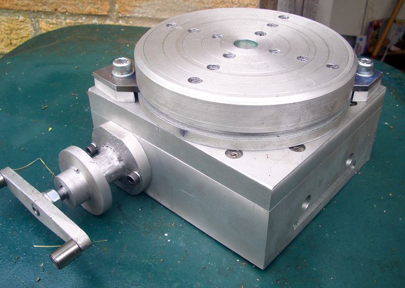

                  #164733
                  norman valentine
                    @normanvalentine78682
                    28.jpgI wanted a small rotary table and decided to have a go at making one for myself. It is now nearly complete, I have just got the division plates to make. Here is a photo of it, if you are interested in how I have done it you can find a build log on the Madmodder website in the "Projects" section.
