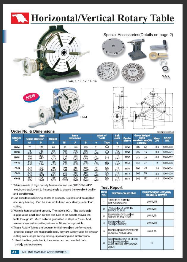

            #63031
            The Merry Miller
              @themerrymiller
              The HV4 “Vertex” 4″ table from Chronos looks very similar to the HV4 “HBM” from RGD albeit some minor detail differences are apparent, the colour being the most obvious.
              Comments would be most welcome.

                    @themerrymiller
                    I’ve gone for the 4″ Vertex from Chronos, good value with an extra 5% discount using a loyalty card they gave me at Ally-Pally.
                    I already have the 6″ Vertex table but I couldn’t adapt my Myford ML7R to accomodate it!!
                    The final clincher was the available data for Vertex whereas data for the cheaper tables was virtually non-existent.
                    Haven’t found a page 2 yet but am still looking.
                    Below is the link to the data above.
