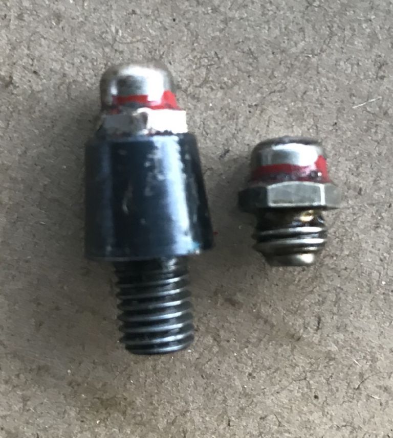

      A newly acquired Hauser milling machine is missing the two oiler assemblies on the headstock. Before I either drill out and re thread M8 x 1 or make a new extender as in photo to take a M8 oiler:
      1. Does anyone know of a source of any M7 x 1.0 oilers?
      2. a source for M8 oiler similar to those in image?
      Thanks, Jon

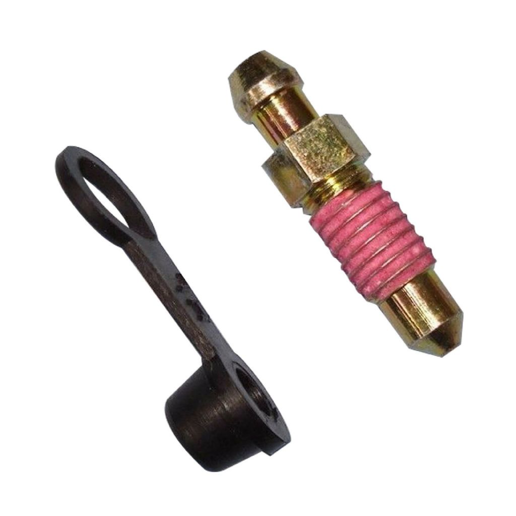

            bleed nipple.jpegThanks Chris. Not much online there and phone call is international for me (Aus).
            However, I may have found a simple possibility – motorcycle brake bleed nipples (seem common in M7 x 1.0)

                Now that I have found the automotive link, M7 is used a "fair" bit – brake nipples, rocker arm adjustment, Vespa scooter bolts, etc
                I too have m7 taps (and possibly a die) but not necessarily the time I would take for a small fitting!
                I think a modified brake nipple is first choice (especially as I leave the Hauser "intact&quot
