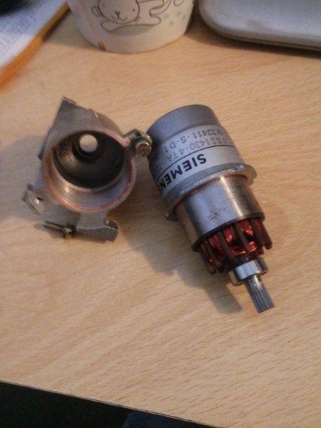

      G'day all.
      Photos are of one of a number of motors which I have just re-discovered!! Unable to find any relevant info on the Web and would like to know what input would be correct and what connections should be used. Dimensions are approx. 1" diam and 2.5" long.
      Any help much appreciated.
      Rgds
      Bill

            Seimes throws up several results for V224411 all in the article here
            These suggest it is a brushed 220V/50Hz asynchronous motor with a number of variants and the brushes listed as parts.

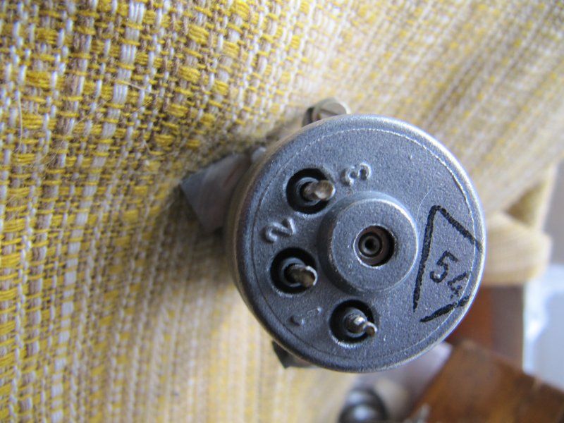

            One or two sources suggest it may be three-phase, which would explain the 1,2,3 terminals. It may be a very small high-voltage servomotor, rather than a stepper.
            Don't just dive in and apply the mains though – check the resistance across the terminals is above, say, 80 ohms first.
            Some people find these in printers, someone else is selling one as 'possibly a stepper motor'.
            If its a stepper, you will probably be able to feel a sort of 'cogging' effect when you turn it.
            You could check the ebay hits for V22411 but don't rely on ebayers to know what they have scavenged!

              Suggest you search on the other number as well 1BS1430-4TA plus the other nyumbers that are going round the side. Some suggestions from Polish site seem to be 15 volts but wther ac, dc or which pins – no idea.
              At least they are out there and known about!

                      It's a curious stepper motor if it only has three terminals, unless that's a fourth on the front.
                      A complete guess think it's a small servo motor rather than a stepper, possibly brushless for three-phase control or perhsps it's for two phase AC. The terminal on the gearbox being a position encoder of some kind. If so it is probably quite an expensive bit of kit.
                      It probably is lower than mains voltage.

                        I think the pin at the front is some kind of pivot as it seems to have a groove at the end for a circlip. I too have not heard of steppers with only three wires but I think they may exist. I could not find any reference to them with Google. (Only a quick search.) I think your three phase could be correct. It could also be a brushless DC motor requiring a controller. If the resistance between each of the three pairs of terminals is the same then it would be evidence for this theory. This is why I suggested taking resistance measurements.
                        Les.

                          I am curious, as I have just re-built an AC motor from Hoover, that has the same Three terminals, on opening it up, Marked A, B, and C, to drive my Myford ML7. I can't see a capacitor bolted to the outside, but there may be an internal One. It may be a Two-phase motor. I am familiar with most stepper motors. These usually have 4 wires, Each pair (Meter them) usually control 2 separate coils. Therefore, it's not a stepper motor. There maybe, probably, however, 2 coils, within said motor. One of the Three terminals is common for both coil A and coil B, The other Two terminals feed in to either coil A or coil B from the other end of the winding. To make it go in a certain direction, One will lag behind the other, via capacitor, or larger winding, to make it go in a certain direction. Take it apart and I am willing to bet you will find 4 terminals! Bit like riding a bike and which pedal do you push first…I t could be a delta winding Three-phase, but probably not at that size. Don't trust me, investigate further. K.

                                Again, many thanks for all the helpful suggestions – have to admit that some of the more esoteric advice joins reactive loads as 'knowledge gained'!!blush
                                This, obviously, item in question opened up . There are 12 separating pieces and rotation of the shaft is 'lumpy' – seems to correspond to the number of separations (haven't counted them!)
                                Resistance measurements (on an AVO digital meter) are :
                                1-2 – 6.76 ohms
                                1-3 – 6.80 ohms
                                2-3 – 6.79 ohms
                                Will follow up some more of the above advice and report back

                                  Looks nicely made … therefore must be worth investigating !
                                  Incidentally, I think that V22411 is just an identifier for the Siemens company.
                                  #114343
                                    From your measurements, it seems most likely to be a Delta-wound DC Brushless Motor
                                    See this Wikipedia article
                                    If so, you might get suitable controllers from the RC aircraft suppliers.
                                    … I reckon you could have a "High Speed Drill" project in there somewhere.

                                      Still puzzling over these things but it would seem that brushless DC is correct. An even greater puzzle is how some of you have search facilities which produce results that don't come up for me!!blush It's embarrassing 'cos it appears that I'm too lazy to do a search and rely on you kind souls to do the work for me – AND IT AIN'T SO!! So, please, guys, what is the secret? Search engine, search syntax, insider knowledge … what??embarrassed
