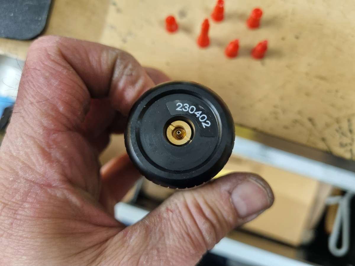

      So I’m clearly doing something wrong, because I can’t work out how to refill this little Butane hand torch.
      torch

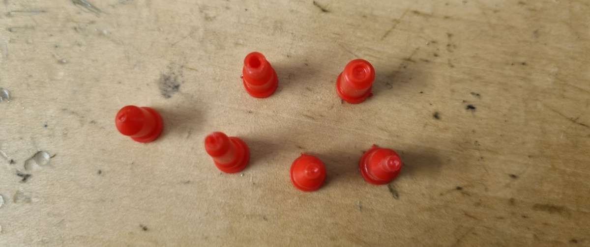

      I have a can of Butane and some adaptor nozzles:
      adaptors
      but none seem to do the right thing – the little refill tube on the torch leaks gas from around its base when pushed in, and the screwdriver slots around the aperture would appear to prevent a seal in any case.
      What am I missing (figuratively or physically)?

        The similar ones I have don’t use the little orange adaptors, just the tube straight out of the bulk refill.
        Yes is does vent around the base, so as soon as liquid butane emerges, stop filling.
        Yours may of course be faulty.

              I generally crack open the nozzle end of the mini/micro torch and refill vertically downwards.  It lets out the pressure and seems to allow a better recharge.

                As NDIY has said, I refill in the vertical down position. There is often some leakage. Mine has a clear tank so I can see what’s going on. Only using the spout on the can no adaptor. Good luck. Noel.

                  The plastic bits are mostly for alignment to help users with no mechanical understanding or poor eyesight to get the tube on the tube. You must make sure the receiving element, be it torch, kitchen gas lighter etc is cooler than the refill tank. Put it outside at this time of year. Have the tank inside in a warm room but not on the radiators, or inside your coat for an hour if operating outside.
                  Hold the receiver with a glove to avoid hand heat warming it and hold the tank in you hand to warm it. Fit together with tank upside down so that it is liquid that is transferring. If you have adequate dexterity move the two together to swirl the tank liquid with your hand at the upper end so that the gas in the can is pulling heat from you to keep the pressure up.
                  The top of the receiver has to vent gas to let the liquid in. The bigger the temperature difference the better. It will not transfer at all if the tank is cooler than the receiver.

                          To the best of my knowledge [as a non-smoker] , the adapters are designed for compatibility with various cigarette lighters … and this is a convenient reference:
                          https://www.newport.global/adaptor-guide-version-2/

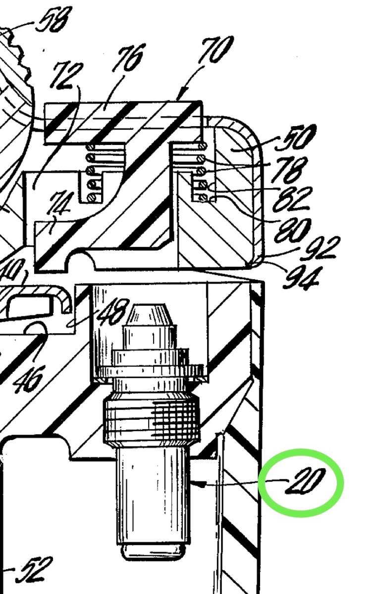

                                Is a cross-section of the valve arrangement available anywhere? I’m trying to get my head around how it works given there must be two paths for the butane, one in, and one out for the “I’m full” overflow.

                                    I struggle a little with how that works – as soon as you  push down on the valve stem the seal is broken, and (because there is of necessity clearance) gas from the torch reservoir will escape around the side of the stem.
                                    Is it the case that the whole affair relies on what’s coming out of the filler canister is liquid and thus will go more towards the torch reservoir than up the (narrow but present) clearance around the stem? Seems very crude…
                                    #782008
                                      Yes … That is my understanding
                                      Yes … very crude, but used relatively effectively in the multi-millions !
                                      I wonder what the Worldwide daily leakage must be ?
                                      Edit: __ See Ronson’s US Patent 3,895,904

                                        See also, the earlier Patent 2,882,940
