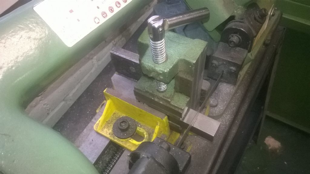

            I have had a Warco CY90 for a number of years and I can honestly say that it's done everything I've asked of it. A few points to note, however. The supplied blade didn't last too long. I replaced it with a bi-metal one from Tuffsaws (Well, two actually for when the first one broke – I'm still waiting for that to happen!) Then I found that its vice is not very good for holding short pieces of material. There are a number of solutions to this common problem. I modified an old drilling machine vice held in the saw vice, like this:
            Mounted on band saw
            It copes with the bigger stuff as well and saves physical effort enormously. If I remember correctly, this was a chunk of 75mm diameter BMS:
            The bandsaw earning its keep
            The price has gone up considerably since I bought mine, but I still consider it a worthwhile investment.
            Just remembered – I had to spend an hour or two, fettling the blade guide bearings etc to get it to cut square.

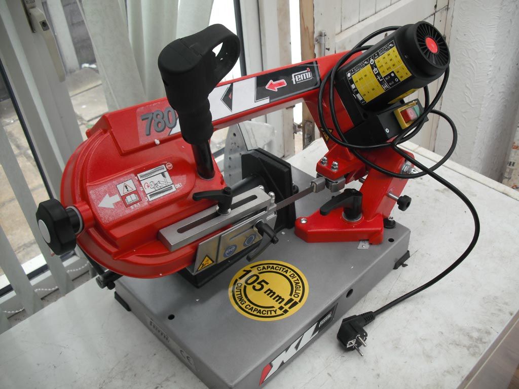

                                          You can always buy a Femi stand if you don't have any bench space. Mine sits on the bench

                                                Its Femi for me, delighted with mine. Cuts accurately.

                                                  Got a Femi too, great little saw, lives on top of some drawers when not in use.

                                                    Also have a Fermi. Quite expensive, but worth every penny.
