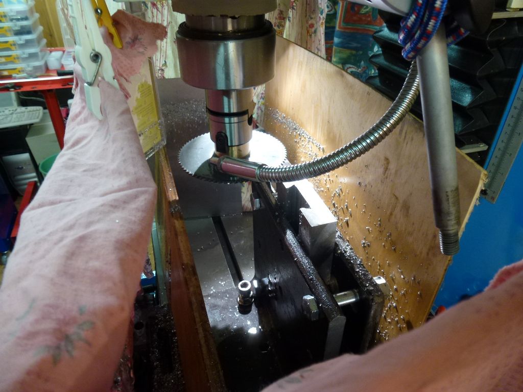

                          Higher feed rate did the trick. 125x2x27 72T, 600 rpm and a feed-rate of 4mm/s or 240mm / minute. No vibration, almost no sound, just a healthy sawing one.
                          I had my fingers on all three stop buttons while cutting , so I took a picture after the cut and after resetting the X-axis for a new cut. I’m making 5 holders for a BXA QCTP so there are 3 more cuts to do. This really worked!
                          Thank you for all help!

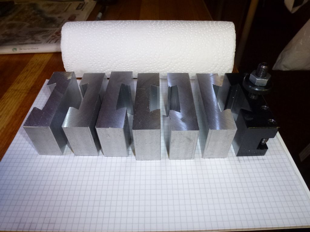

                            Finnished cutting of dove-tailed blocks for BXA QCTP.
                            Each cut was about 10 seconds, although the setting up took much longer!

                                I have 3 plates 370mm square and 25.4mm (1″) thick. They are marked “ALLA PLUS PLATE” and “P1115”. From what I can find out, the 1115 means that it is essentially pure aluminum. This is what I had from the scrapyard, so that’s why I’m using it.
                                If you make holders for AXA or BXA, the dimension for the dovetail is very critical. Even a cut of 0.02mm makes a real difference to the fit.

                                                    After I got the feedrate right, thank you Andrew, I now feed 4mm/second and cut 370mm 25mm thick Aluminum in 90 secoonds, with a saw 125x2x27mm 72T at 600rpm, I see no reason to use a cutting disk for this kind of task. The finnish is really good. As long as I can put it on the mill table, I’m OK. If it’s too long for that, I’ll guess I will get a Aluminum cutting disk for the angle grinder.
                                                    I think cutting oil is a must though. I’m using rapeseed oil with no additives myself.
