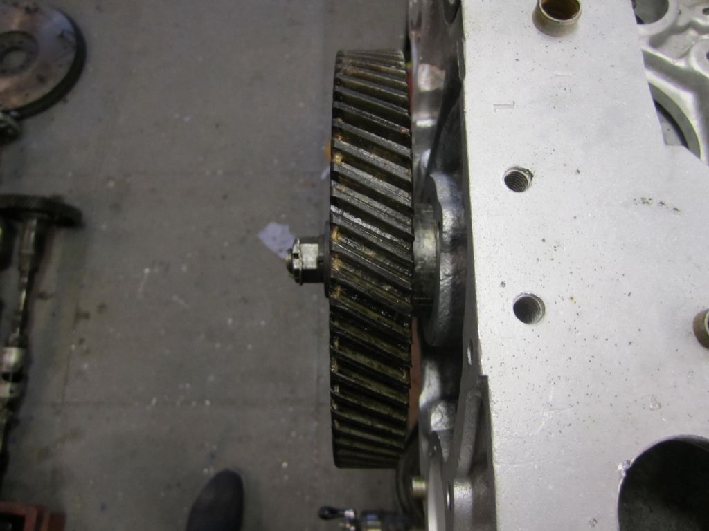

        I am rebuilding a 1914 petrol engine that has twin cams. One of the timing gears is missing. I need to make a replacement, I have measured them and they appear to be cut at an angle of 14 1/2 degrees but are straight not helical.
        I assume I can cut the gear the same as straight spur gear but at the correct angle.
        Anyone has come across this type of gear before?

              #284692
              vintagengineer
                @vintagengineer
                I will post some pictures tomorrow. They are cut in a straight angle ( I have clocked them to confirm this) rather than a helix and they alternate lefthand – righthand so that they mesh. But because of the angle they have thrust washers on all the gears.

                  #284800
                  vintagengineer
                    @vintagengineer
                    #284809
                    John Stevenson 1
                      @johnstevenson1
                      That is a helical gear.
                      I'd suggest that you get hold of a copy of Ivan Laws fine book Gears and Gearcutting, No 17 in the Workshop practice series and all will become clear.
