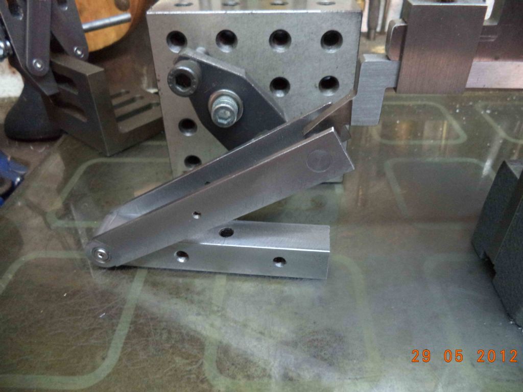

      Just completed this sine protractor.
      Its simple to use the distance between the centres is 100mm so to set it to desired angle its just the sine of the angle times 100 move the decimal place two jumps to the right.
      This is how you set it:-
      Zero you digital height gauge on the top of the roller.
      For 30 deg the sine is 0.5 so the height to set the roller is 50mm
      Then just use it to set your work at the angle
      You can obviously work the other way and use it to measure angles.
      Stew

            Looks a clever idea Steward, simple, but then the best ideas are often the simplest.

                              The thing i really like about Stewarts design is it doesn't need agauge block set which a lot of people don't have -including me but a height gauge i do have .
                              I do have a cheap distance block set that the required parts are held together with or mounted on a long grub screw which it is a PIA to use but my suface plate is there along with my height gauge ready to go any time i need it .
                              Ian

                                Another way to set a sine bar without using gauge blocks is to use adjustable parallels or a shaper gauge to set he height. Use a mike to set the proper dimension on an adjustable parallel or shaper gauge. Use thatunder theuppe roll instead of a stack of Jo blocks.
