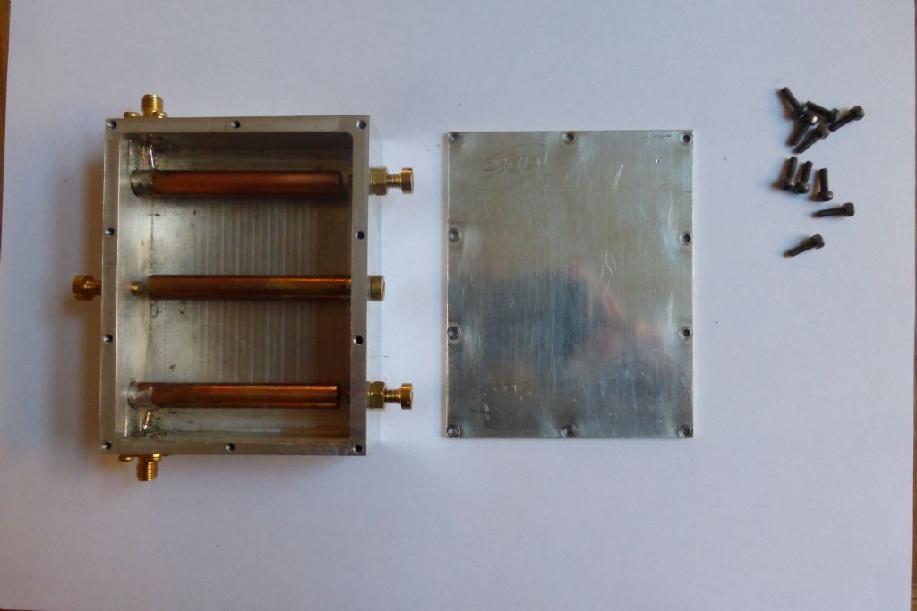

      I'm looking to silver plate some copper rods as part of an RF (1.3GHz) electronics project, and while I can find formulations for electro-cleaning the rods prior to plating, I can only find one source of silver plating solution which is £35 for 250mL, but I can't find any info on its formulation – cyanide free that is.
      I want to coat three rods in about 2-3 microns of pure silver as a test to see if there is any material improvement in performance over the raw copper, if there is then I'd be looking to silver plate upto 30 rods.
      The coating does not need to be a bright finish, which seems to be the difficult bit, but just a nice uniform coat of pure silver.
      Anyone got a formulation I could use make up to do some trial plating?

                #290536
                Steve Withnell
                  @stevewithnell34426
                  This is one I made earlier, without the silver plating…
                  This one has a centre frequency of 1090MHz to stick on the front of one of those SDR TV sticks, to capture aircraft ADS-B signals. (Which when the moon is in the right phase, gets uploaded to Flightradar24 and gets me a free subscription!)
                  Silver plating the rods should improve the filter performance, the interest is in measuring by how much.
                  From a hobby machine shop point of view,  I took Jason's advice and mounted the aluminium blank on the face plate of the lathe and bored out as much of the waste material as possible.  The advantage is that the chips just fall out naturally,  whereas on the mill,  you end up with the task of continually clearing out the chips.
                  Steve

                      Can't help with the silver plating but I can give some pointers on high frequency performance:
                      The resistivity of copper is 1.72 microohm/cm, giving a skin depth at 1.3 GHz of 1.83 micron.
                      The resistivity of silver is 1.59 microohm/cm, giving a skin depth at 1.3 GHz of 1.76 micron.
                      So, while the resistivity of silver is lower the current flows in a thinner layer and the improvement is less than you might expect. In fact the resistance will only drop by 4% and the Q factor of the resonators will thus only improve by 4%.
                      Silver plating can give a long term benefit as the tarnish on copper can be semiconducting however a thin coating of lacquer is easier and cheaper to apply.

                          Further to the excellent quidance from Russell:
                          For loss in synchronously tuned filters, in the time when I was (less) gainfully employed, a couple of extremely useful reference works were written by Seymour Cohn, specifically see ‘Dissipation Loss in Multiple-Coupled-Resonator Filters’, Proc. IRE August 1959 if you can find access.
                          I don’t now have access to my paper copy, but I remember something close to:
                          Filter loss in dB = 4.343*(reciprocal of fractional BW)*sigma(gi/Qi)
                          Where Qi is the Q factor of the i’th resonator, and gi is the normalised value of the i’th resonator (for the low pass prototype at a frequency of 1 radian/sec and impedance 1 ohm). I cannot remember whether the fractional BW relates to the half-sided BW or the full BW as a ratio of centre frequency.
                          But anyway, the passband insertion loss in dB is directly proportional to the inverse of the resonator Q factor (simplifying to assume the resonators are all the same). The stopband performace is not significantly affected by the Q factor.
                          Note that silver oxide is electrically conductive (hence silver use in switch contacts and general electronic use), but copper oxide is significantly less so, see use in copper oxide rectifiers, **LINK**
                          I agree that coat of lacquer will give much of the long-term benefit of silver plating

                                            Yes, the diameter of the rod matters but a 1% increase in diameter will only reduce the resistance by 1%.
                                            The current is flowing within a thin skin, the skin depth doesn't change with the diameter so the cross sectional area of the conduction region will also change by 1%. The length of the rod remains the same. So the resistance will drop by 1% and the Q will increase by 1%. The box size would also need to be increased to maintain the same characteristic impedance of the resonators.
                                            So, scaling the design up by 4% should give the same reduction in passband loss as the silver plating.

                                              Here is the design programme I'm using. Changing the rod diameter does not change the Q, so I'm assuming (!!) that the rod diameter does not make a material change to the overall filter performance, so the maths isn't included in the code.
                                              **LINK**
                                              So far I've made a 3 pole version for 1090MHz and a 4 pole version for 1249MHz, both close to the design spec. Sounds like polishing the copper rods and applying some lacquer solves all sorts of issues!
                                              Steve
