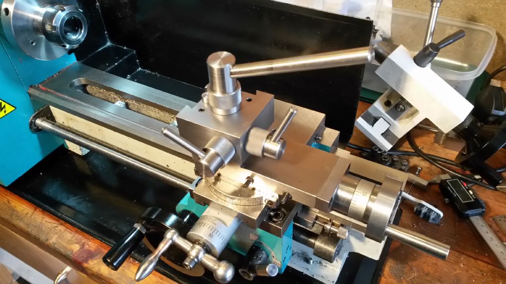

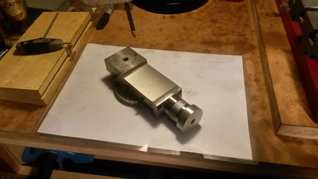

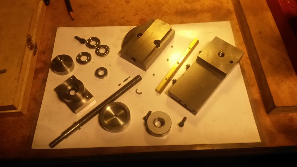

                  Hi Jack, I had the same problem on my sc2. If I tightened the gib the graduated dial would bind. If I slackened off the gib everything ran smoothly, but then everything was sloppy.
                  I sorted it out by fitting a couple of bearings so that the compound screw would always move smoothly. This entailed designing and making a complete replacement mechanism, including the compound screw. I re-used the original graduated dial.
                  I did this a fair while ago and it's been a massive improvement. The only downside is that the cross-slide handle can foul on the mechanism when the compound is set at an angle, but it can be got round and I wouldn't go back.
                  I've a couple of pictures of all the components and the assembled result.
                  Hope this helps.
