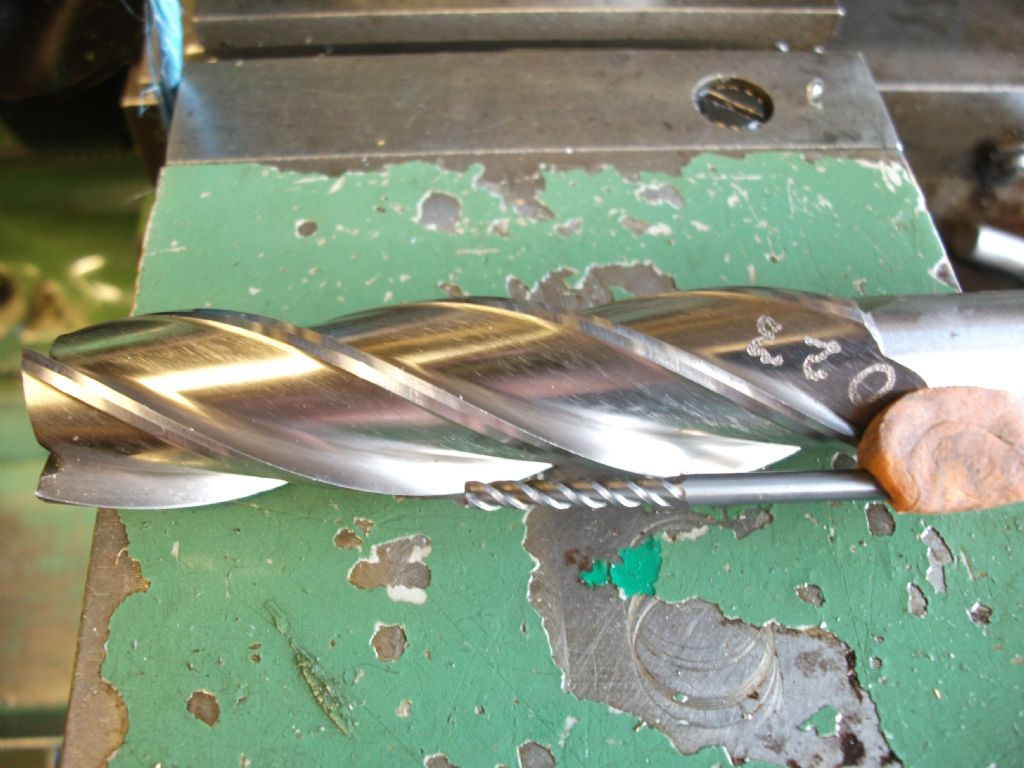

        I would like to ask how you measure the helix of the cutters for sharpening.
        I have tried all manner of devices (mechanical ) but have failed miserably .
        The area I am trying to address is that of sharpening the sides of small end
        mills when the usual mechanical guide does not work.
        your use of an electronic solution looks to the answer but the helix variation
        has me stumped.
        An article that was in MEW 143 through to 147 "A cnc cutter grinder "
        may be worth a look,it describes the construction of a machine and its use.
        The photo here shows a 3/4 inch long endmill and a 3 mm 3 flute carbide
        endmill alongside ,both have been sharpened on this machine.
        It is important that the cutter should follow the original lead of the cutter, as
        can be seen the lands on the large cutter form a parallel edge along the length
        of the cutter,any deviation from this would mean the clearance angle would
        change or the cutter would become tapered.

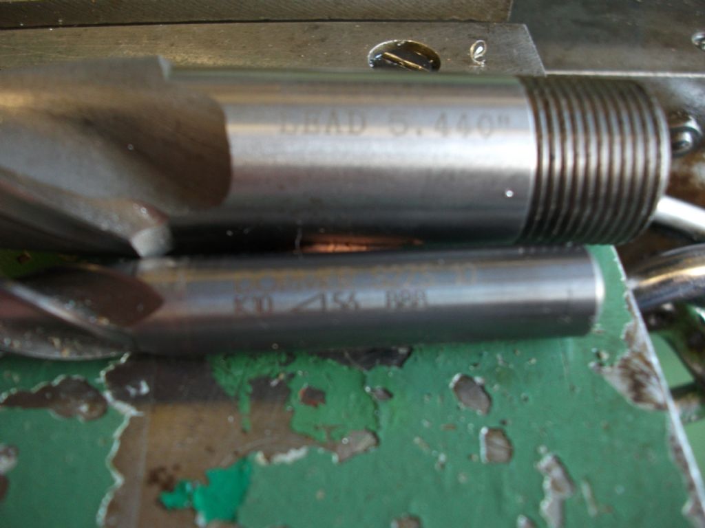

        Some cutters have the lead engraved on the shank ,as can just be seen
        the imperial cutter is marked 5.440 inch and the metric has 56 next to the
        small triangle indicating the lead is 56 mm.
        Much more sophisticated machine seen here…
        http://www.youtube.com/watch?v=qxU0K-TmEvI
        They use the same method as i do to measure the cutter but their
        system is much easier to use.
