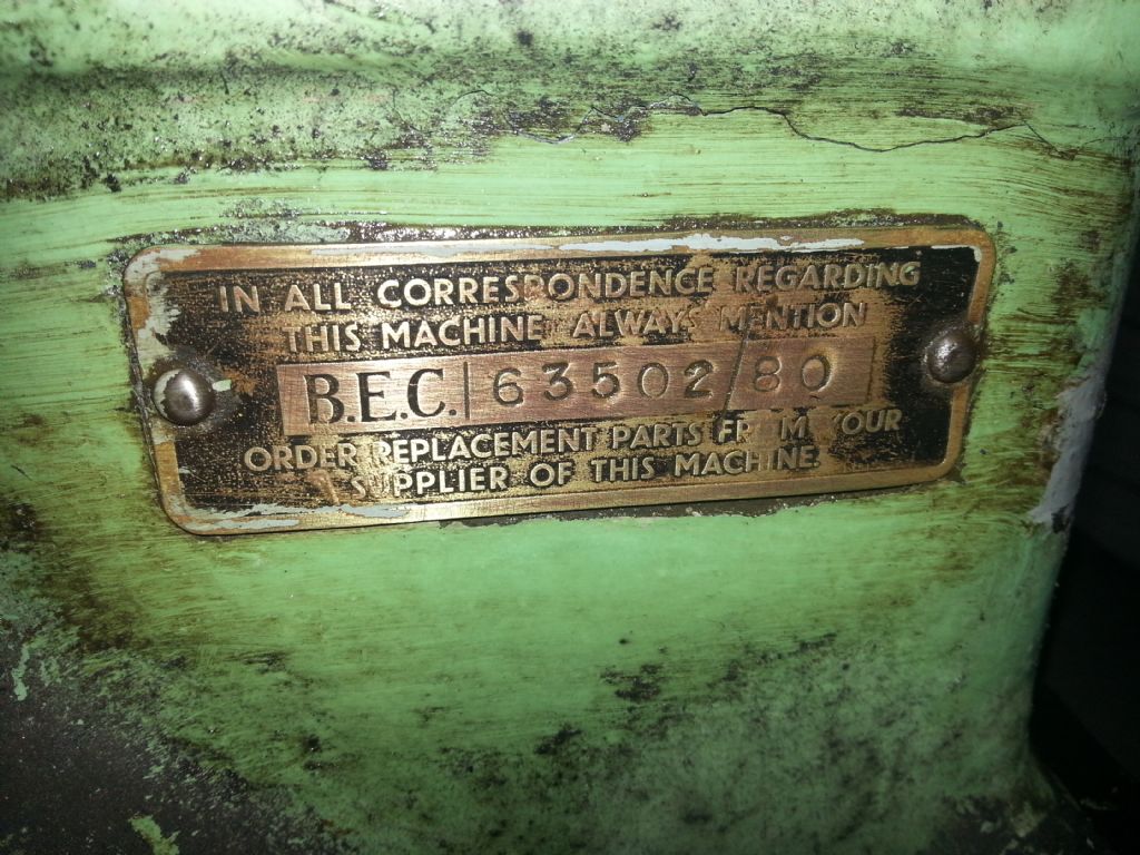

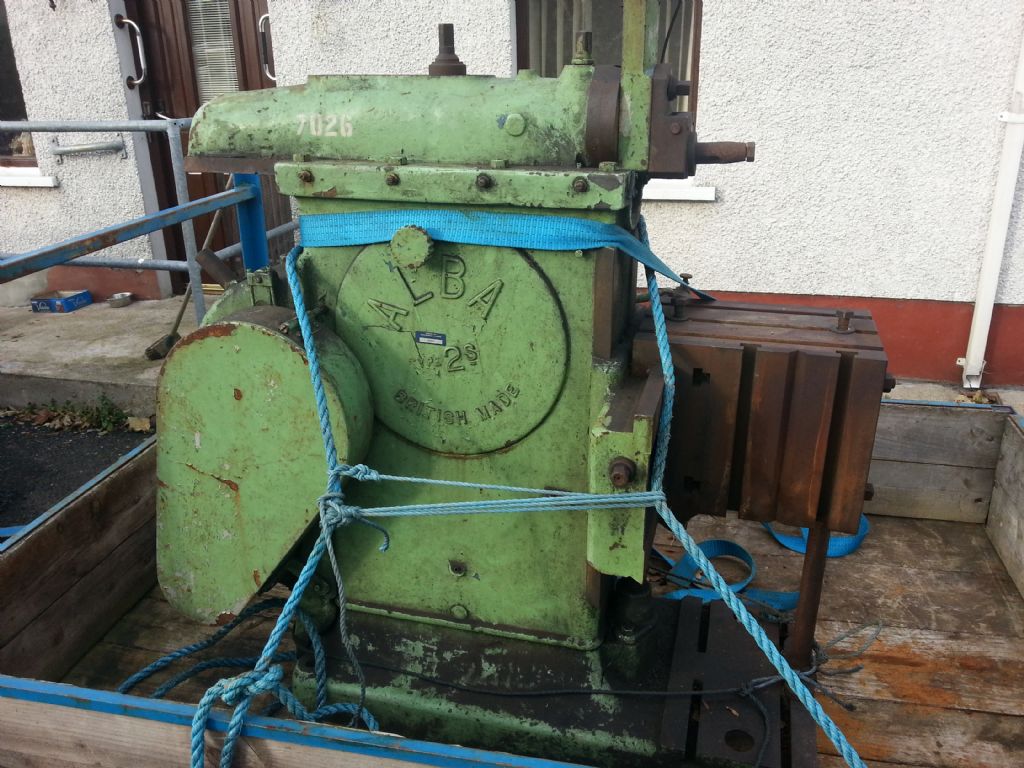

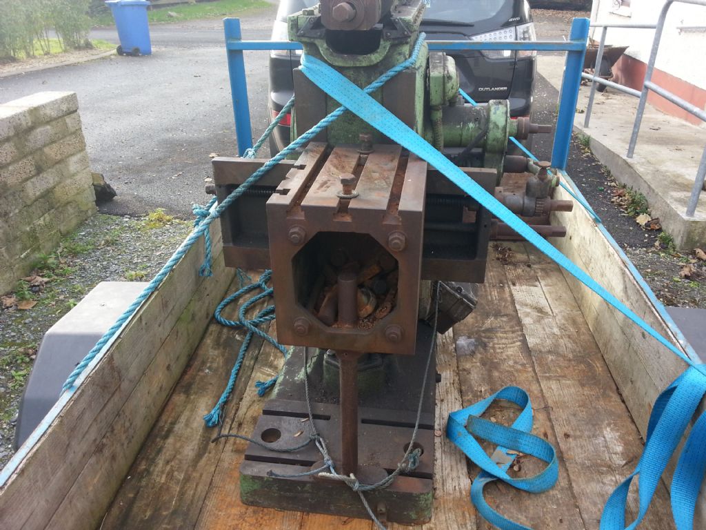

                                  20131115_120052.jpg20131115_133851.jpg20131115_120040.jpgYea my baby has arrived, dam its a star only motor oh well, still its only 2 hp. Time for more shopping. Got it of the trailer and in the shed time for some cleaning. Can any one tell from the serial what year it is? also its a alba 2s not a 4s. Its actually not that bad under all the crud. Anyway some pics for yens.

                                    Looks very useful, Mark !!
                                    #135614
                                    _Paul_
                                      @_paul_
                                      Great find your machine looks complete.
