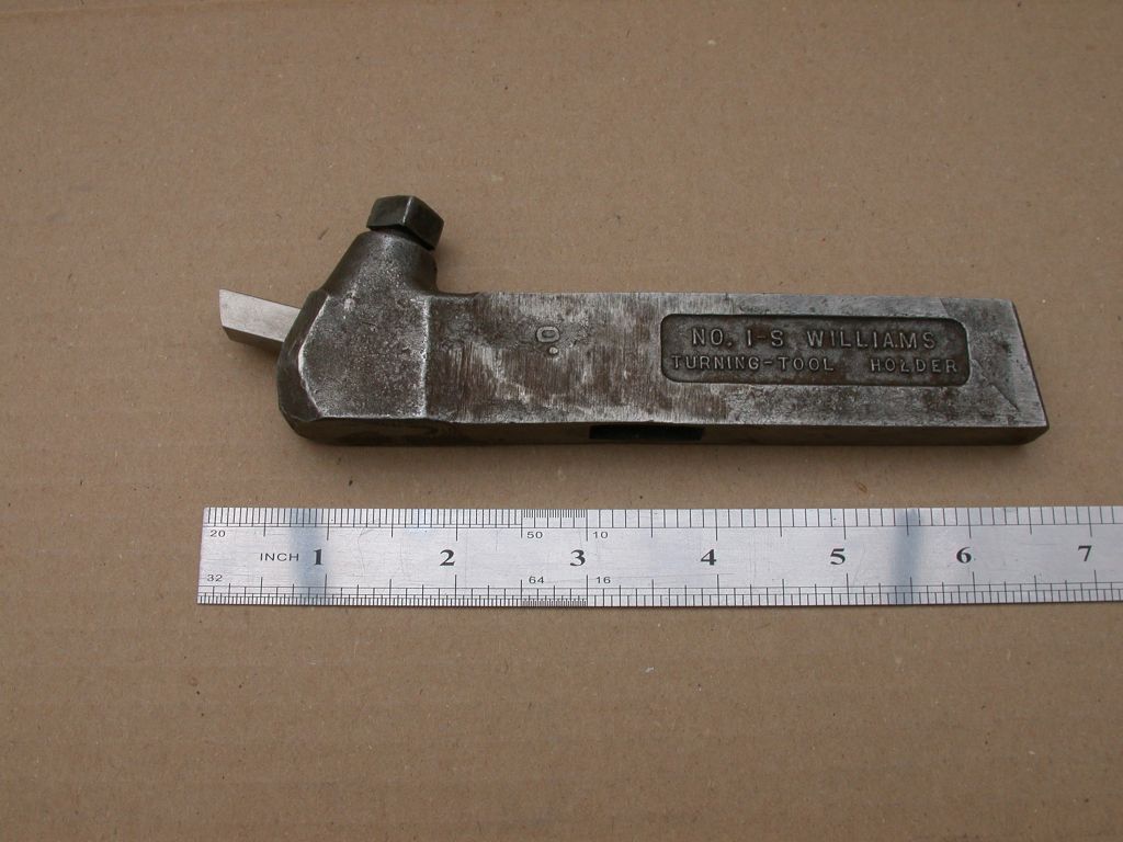

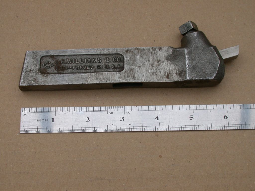

                      american toolholder-r.jpgLee,
                      In case you're not familiar with them, the type of toolpost referred to by Martin is shown above and below. As he says, this enables you to use smaller HSS tooling – this one takes 5/16" – and saves a lot of work and waste compared to grinding a full-size tool that will fit the clapper box directly.
                      These are often available on ebay, but be aware there are left and right handed ones as well as straight like this one.
                      If you are in the UK and want one I could probably find you one that I'm not using.

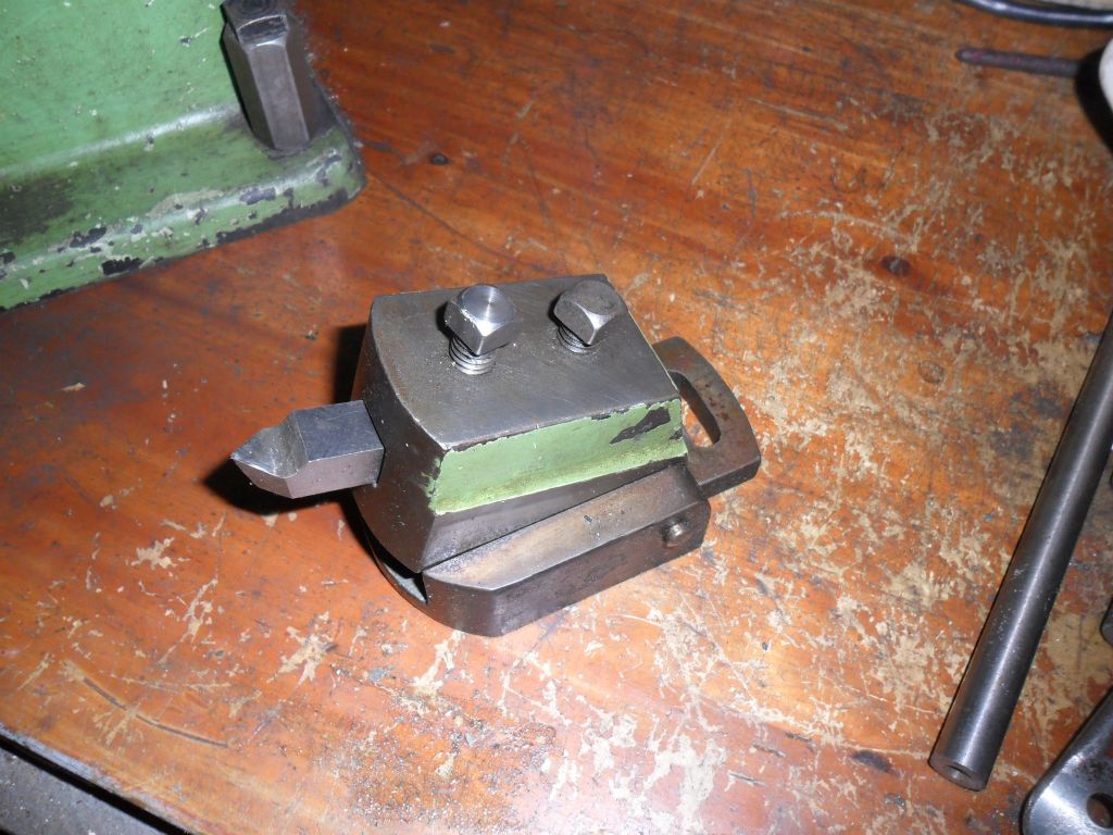

                                      Hi Lee & Guys
                                      Here is a 1/2" square toolbit I use in my Drummond hand shaper . Similar to the one that Lee described for flat
                                      surfaces . works well . as been mentioned shape may vary depending on the job . it cutting down the side of a block the claper box must be tilted so the tool swing away from block on return stroke
                                      Regards Nobbyclapper box

                                      #138991
                                      John Olsen
                                        @johnolsen79199
                                        You can use the same tools on a shaper as you would on a lathe, except that sometimes on steel you might want a little less top rake than a lathe tool has…as I just said on another thread, if there is too much top rake the tool can sometimes pull down into the job.
                                        The Williams tool holder that Robbo shows above is actually a lathe type. The ones of this general style that were made for shapers held the HSS piece parallel to the base so that you did not get the built in top rake. One reason for this is to avoid the problem mentioned above with too much top rake, the other is that with a shaper, if the HSS or the holder flexs ( and it will) then it tends to increase the depth of cut. However, before anyone else jumps in, I will say that one of my shapers, a 10 inch Alba, came with three of this type, and they work fine.
                                        The type that Paul shows shouldbe used with the nut toward the operator. This means that any flex will reduce the depth of cut, while if the tool is in front flex would increase the cut. They are quite good and the Bradley book tells you how to make one out of a steel bicycle crank. They don't let you use really short pieces of tool steel like the Williams (or Jones and Shipman) type does.
                                        The V shaped tool that Nobby shows is a good general purpose tool for planing down flat surfaces, since it lets you work both ways across the job. That saves having to wind the table back all the way by hand, just add on the new cut, reverse the ratchet and away you go again. For side facing a tool like a left or right hand lathe facing tool is better. I've used a half inch square one much like Nobby shows to take cuts of up to quarter of an inch depth on my 18 inch Alba. You can take a slab of steel or cast iron down to the desired thickness pretty quick at that rate.( but not with a hand shaper!)
                                        Do take care with the chips, they do come off pretty hot and will lodge in all sorts of unexpected places. If they are coming off blue and smoking you are probably pushing things too hard and should reduce the speed a little.

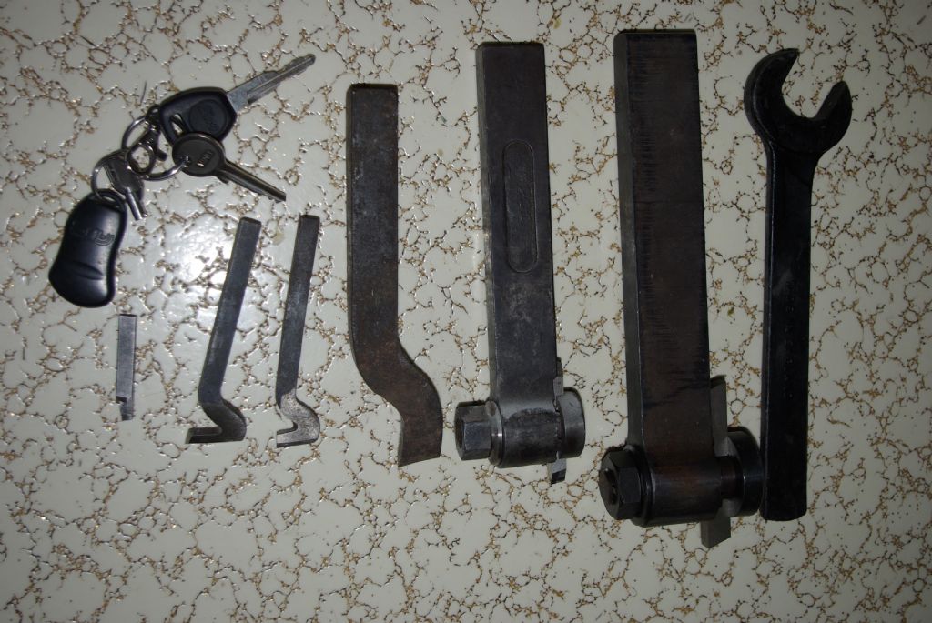

                                          Shaper tooling
                                          Here is a selection of shaper tooling, from the sublime to the ridiculous if you like. These are all set in the photo as if they were going to be cutting to the left. Starting at the left, we have one of my home made carbide tools, an uncoated insert brazed to a key steel shank and sharpened with a diamond wheel. They are not supposed to like an interrupted cut although they seem to cope OK in my experience.
                                          Next we have two really old tools. They used to favour gooseneck tools like this for shapers, and for lathes too. When the tool flexes it tends to reduce the depth of cut, helping to avoid a dig in. It is not really necessary to go to quite that sort of length, although these still work fine. This is a left hand cutting tool and a facing tool, the latter being the V shape mentioned in my earlier post. The right hand one unfortunately got dropped and broke at the lower bend. These came with my 6 inch Ammco machine, a design which dates back to the early thirties.
                                          Next we have a tool made for a somewhat larger shaper…I am not sure where I picked this up. You will see that they went for a less extreme version of the gooseneck idea, but it will stll help avoid the tool digging in when it flexes.
                                          The last two are the Jones and Shipman style. The smaller one is for my 18 inch Alba, and that tool has taken cuts of up to .25 inch in cast iron and mild steel. No problem, no fuss, well within the machines capacity. Just don't get in the way of the hot "toenail clippings" as they are flung across the workshop. The bigger one is brand new, I still have the box and as you can see, the spanner, but the shank is just a little too big for the toolholder. Still, it was very cheap, I got about twenty pounds weight of miscellaneous tooling including this for about NZ$50, including reamers,taps, broaches…you name it. So it doesn't owe me a lot. Maybe one day I will thin it down so I can use it.
                                          But don't feel you need to try to find stuff like this, that was actually made for shapers. For getting started, take an ordinary piece of HSS, say 3/8 for a small machine or half an inch for a bigger one. Sharpen to the V shape, with a little bit of side clearance on each side of the V. Put a small flat, again with a little clearance, on the tip. Leave the top unraked for now. Fit in the tool holder, with a bit of packing on top if needed. A tool like that should work pretty well. You may find it cuts a little better with a little top rake, but if you over do it it might try to dig in. That will all depend on how rigid your machine is, and how good the slides etc are. Of course if you need to cut brass or bronze you might want to put some positive rake on.
