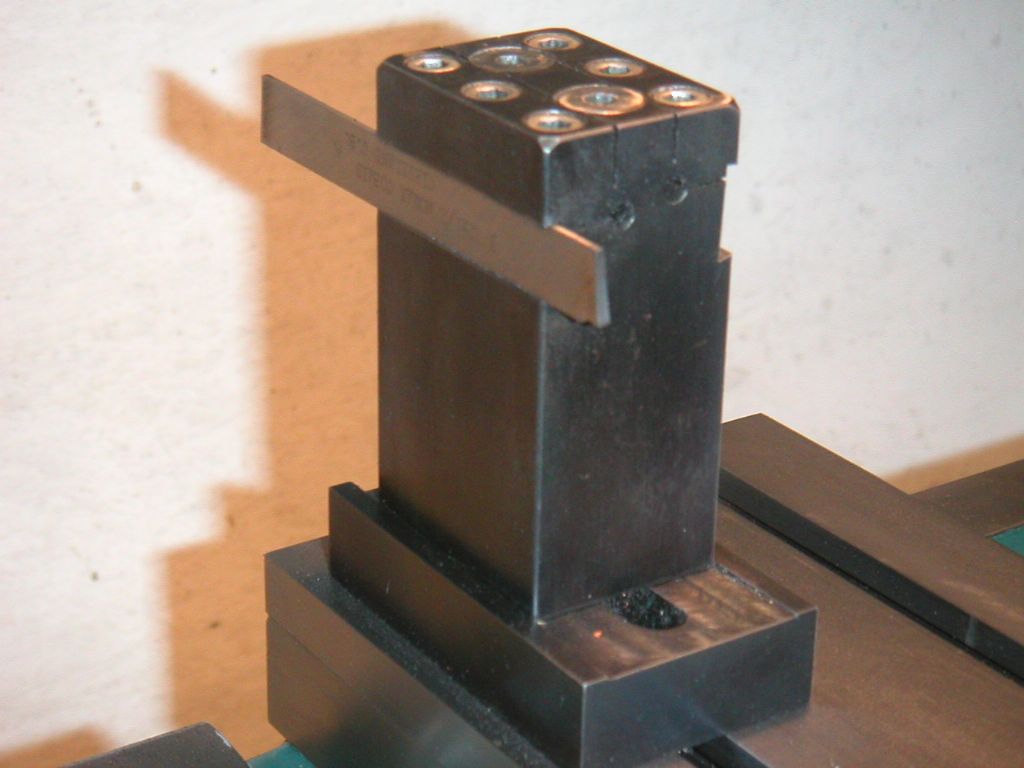

        Dear all,
        I'm using a rear toolpost parting tool and it's generally very pleasing to use – but one thing I've noticed is that occasionally I will part off some work and notice that one of the faces is very slightly convex.
        To me, this indicates that the tool is crooked in the toolpost, or the toolpost itself is crooked. Now, I'm using a toolpost which has a very positive key onto the t-slots of my cross slide, so I think it's less likely to be that, and more likely to be the way the tool is held.
        The toolpost has a boat shaped cutout on the bottom, onto which sits a boat with grooves ontop. The tool sits on the boat, and then there's another plate which sits (seems to sit?) between that and the adjustment screws.
        However I seem to secure the HSS tool, when clamping down it always seems to twist – either away from perpendicular, or rotating around its axis.
        Clearly, I am doing something wrong here!

            The first picture looks 'wrong' to me, the tool boat should be nearly horizontal, maybe like that to get the centre height right? As it is the 2 clamping screws are going to have edge contact only & will not be very secure. More detailed advice from others will follow I'm sure.

                    Hmmm, got to say I don't care for those boat adjusters. Sworn at rather than sworn by! They're prone to wander, fiddly to set to height and mess with the rake.
                    Wandering will be worse used that way round because the cutting forces lift the boat and bear on the two fixing screws, which are also canted where they press on the spacer, yuk. If the lathe is run in reverse, with the tool the right way up, the cutting forces press down and the post is more rigid. Alas, Myford lathes aren't top dog for rear parting because the chuck is likely to unscrew when they run in reverse.
                    I'd dump the boat in favour of a flat rear tool post which is shimmed to height. The plain post eliminates a lot of problems, even used upside down. (I expect to be told boats are easy when you know how. Even if it's my fault I don't trust 'em.)
                    Parting off tends to wander at the best of times. The tool has to be straight and stiff.

                      The tool has a top rake ground into it and is then mounted in a toolpost which provides further rake..
                      I would suggest minimising rake, and just setting the tool on the centreline, with minimal overhang to maximise rigidity.
                      If the face is concave, or more likely convex, the blade is flexing, which suggests that the end of the end of the blade has not been ground absolutely square, and possibly the feed rate is a little too high..
                      I used to grind the end of mu blade at an angle, to avoid a pip on the work, but found that the angle caused the blade to flex, and because the swarf produced is wider, a greater tendency to jam in the groove.
                      Howard

                        This is much more rigid than the boat toolholder. The base block has a shallow slope enabling the cutting tool height to be adjusted.
                        Alan

                          The face of the tool holder shown in the top picture should be facing the chuck, so it looks as if it is set up for the lathe going in 'forward'. This confirmed by the second photo. No chance of the chuck unscrewing, but the tool is canted the wrong way, hence the need for the notch. I think this is simply the wrong tool holder for the job. Boat tool holders have a very poor reputation anyway

                            The rear tool post shown by. A J is a far preferable set up. Mine,I think, is even better. It is of fixed height – made that way for my particular lathe, I expect. I can remove or replace the whole caboodle, without fear of altered cutter height.
                            With the blade always held parallel to the cross slide, any extension (or retraction) for parting different diameters is a simple affair. I always keep the extension to a minimum. Nor does sharpening the blade alter the cutting height.
                            I originally purchased a QCTP with several tool holders (supposedly better value by an amount, but not in hindsight). I wish I had not because the parting tool holder was at an angle – just a PITA in use! I’ve since modded that particular tool holder for a different purpose.
                            As an aside, I’ve never used the push-type knurler, either, which was also bought at the same time – as part of a set of tools to fit that QCTP). I was caught out twice in the same day, but won’t make the same mistake again.

                                  One of the advantages of using a rear toolpost is that the swarf falls away downwards, and is less likely to jam in the cut, to cause problems..
                                  The consensus seems to be:
                                  Mount a proper parting blade, with minimal overhang, square to the lathe axis, the front clearance ground square to the blade, with Zero top rake and at centre height, in a rigid toolpost.
                                  The set up that you show satisfies very few of those requirements.
                                  Like S O D, I dislike boat type tool holders; they are a compromise with ease of use as the priority, with rigidity and correct tool setting a long way down the list of attributes.
                                  If you want to see a rigid rear toolpost, take another look at Alan Jackson's, or at MEW 306
                                  The very least that you need to do is to set the upper face of the boat to horizontal (Preferably dowel / clamp in that position )
                                  Get a proper parting blade, don't grind in any top rake, clamp it square, shim it to centre height, with minimal overhang, and then try again. Don't let the tool rub, just keep up a steady gentle feed.
                                  Do those things work? Lots on here will tell you that they do.

                                    I re-set the grooving tool with the packing piece between the boat and the tool, instead of ontop of the tool – and it was almost bang-on centre. It is still flexing a bit – for example if I part out halfway then I can see the tool generate a little swarf on re-insertion.
                                    I have a parting blade tool and holder (the kind that is inserted into a normal toolpost, rather than integrated into the toolpost) but the tip of the blade is way over the centre height, so I've had to grind down the top of the tool so it's got a chance in hell of cutting. In this view, it looks like I've inadvertently got some positive rake…
                                    It looks like I need to fabricate myself a dedicated 'blade'-type rear toolpost holder like Alan or John? I can't seem to find anywhere to buy one!

                                      William, as your tool bit in the second photo is parallel along it's length it will not suit any degree of positive rake as the tool will become wider the more it is fed into the work which is not good. It needs to be ground flat or with slight positive top rake.
                                      Better still the tool holder can be modified by milling some material off the bottom of the bit that fits into the tool post so the whole thing is lower.
                                      Either way that grinding looks a bit rough and the edges rounded, you want the corners nice and crisp.

                                          Some more experimentation including fixing the rake on the front parting off blade:
                                          It parted off without much fuss at all – so maybe it's as simple as that? I do see some other holders for 8mm blades but it looks very similar to what I've now got above? i.e. ebay 265202611958 or 373410105832 – is it worth getting one of that design intead or am I going to be alright?

                                            Whether a grooving tool, or a parting tool, each SIDE of the tool needs to have clearance. (Which is why a parting tool narrows from top to bottom if you look at it from the front. When mounted inverted in a rear toolpost, it narrows from bottom to top )
                                            Assuming that you intend to continue using the boat holder:
                                            Rather than grind the top face of a parting tool to bring it down to centre height, I would grind the whole length of the bottom face. If need be make up a holder with a deep enough groove so that when the holder contacts then grinding wheel, the tool is at correct depth. In this way, any errors will have minimal effect on the angle at which the tool sits.
                                            You could mount the Boat in the 4 jaw chuck and turn the required amount off the flat face on which the tool sits. This might be the more accurate way of lowering the tool to centre height.
                                            How much to remove?
                                            Since the blade is tapered, you will need to make a clamping piece with a taper to match that of the blade so that when clamped the wider, cutting face, is horizontal in BOTH planes.
                                            The clamping screws will bear on the upper face of this clamping piece.
                                            If you do not have milling capability, you will need to file the taper. The blade can act as your gauge.
                                            Mount the parting blade on the boat, using your new clamping widget, (to cater for the taper ) and measure the distance between tool tip and centre height. If in doubt take off a little bit too much. You can shim UP but not DOWN.
                                            (Although the tool is mounted inverted, the logic is still to start with the tool below centre height and shim to bring it UP to centre height, just as in a front toolpost )
                                            Remove too little and it will still be below centre, but cannot be shimmed to bring to centre height..
                                            Grinding a parting tool with the front face at an angle (viewed from above ) should allow parting off so that there is no pip on the parted off piece. BUT the swarf is wider than the groove being machined, and so liable to jam, particularly with large diameter workpieces as the groove deepens.. Hence the advice to grind the front square to the blade. So when presenting the blade to the wheel to grind the front clearance, keep the blade at right angles to the wheel. The radius of the wheel will provide front clearance, without it being excessive.
                                            Excessive clearances leave less metal behind the cutting edge to conduct away the heat so that the tool heats up, softens, and wears more quickly.
