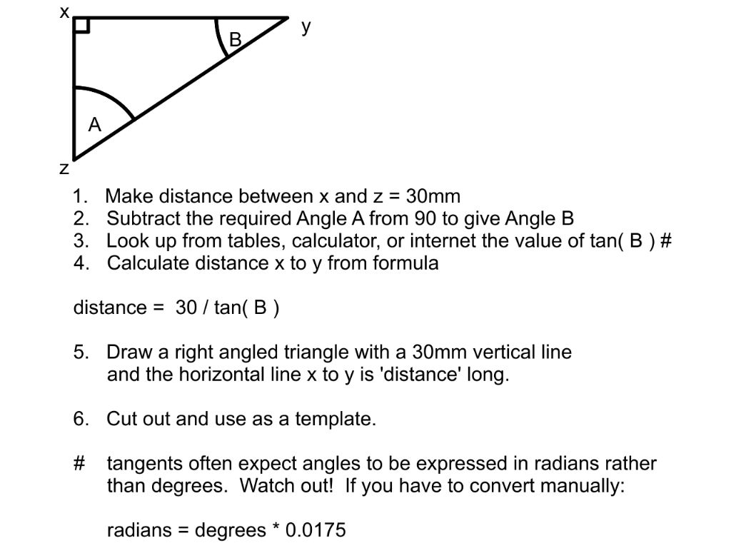

                      Depends on how precise you need to be – see Sine Bar and DTI solutions above for good answers.
                      In a home workshop cruder methods may be more appropriate. I use a CAD package to draw a right-angled triangle with the wanted angle, print it, and then use it as template to align the tool-post. Sticking the template on card makes it less floppy and easier to use but it's not necessary.
                      The triangle can be drawn manually, in this example I chose 30mm as the baseline, any number will work.
                      This calculator may help. Note the slider switch between Rad and Deg
