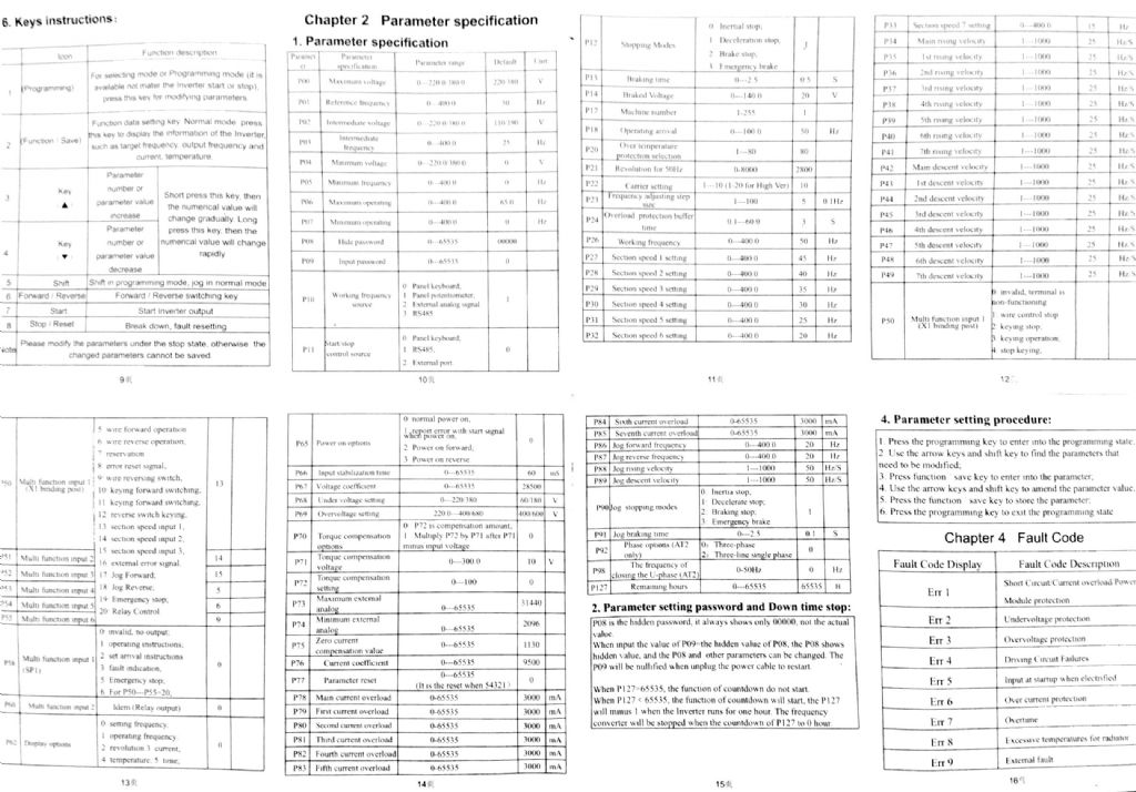

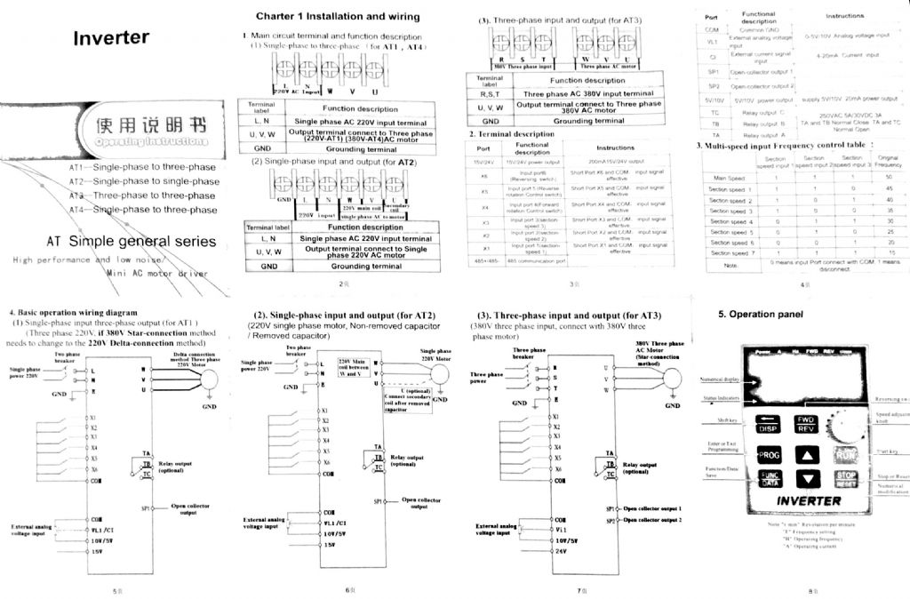

      Posted by Daniel Grant on 04/01/2019 17:26:59:
      Here’s a couple of pictures from the ‘manual’. Not the most thorough document I’m afraid.
      Pics are illegible Daniel. Do you have a scanner? If not and if you're taking them with your phone try an app called CamScanner – it's fantastic at cleaning up documents, can output to JPG or PDF.
      #389393
        Have you got an AT1 or an AT4? ( or even an AT2 or AT3 ) Should be a label on the back. I guess you have an AT1 which is the ordinary one, it's the AT4 model that does 220 to 380V (according to the advert).
        The instructions are too blurry to read properly – can you zoom in, perhaps 4 pics?
        What I can see suggests the instructions cover 4 different VFDs from the AT family, although similar not identical. Also, the current maximum looks to be defaulted to 3000mA, which may be too low for your motor.

          The model is an AT4, but the motor has to be converted to 220v to run. Well spotted on the 3000ma max current Dave, that could well be what’s tripping it. I’ll try changing it tomorrow.
          Struggling to get the images uploaded after using camscanner, I’ll try to get some clearer pictures.

              Those images still aren’t really clear enough, I’ll try and sort out a link to a higher res image.

                  Below are 2 links to better copies of the document that came with the VFD.
                  https://drive.google.com/open?id=1xtYxfrR5KKBleoASucNfbk-hPAjYU7U0
                  https://drive.google.com/open?id=18n3MvYKNO6jzCumfbEpYmpHxiQDFrnMi

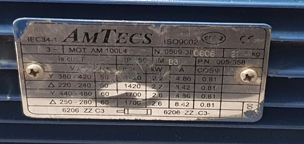

                        The motor is connected to the VFD with U,V and W going to the correct positions, the first picture was with the wires removed.
                        Mike – P21 was set to 2800, the motor is supposed to do 1420 RPM so I changed it accordingly.
                        P24 – 3.0 Seconds
                        P34 – Currently set to 10Hz/S. I haven't changed this but it is different from the 25Hz/S in the manual.
                        Below is the plate from the motor and I'm trying to work out how to share a video I took that shows it running up to 6Hz before cutting out. Hopefully you'll be able to hear what I mean.
                        Thanks again for all the help.
                        Edited By Daniel Grant on 05/01/2019 15:13:25

                                    Well as I read it, on Page 2 of your "manual", assuming your converter really is an AT4. and not a mislabelled AT1, then the motor should be wired 380-420 in star config, not 220-240 delta.
                                    As mentioned above, try it on the other motor, also wired as 420v star and see how it works with that.
                                    The motor sounds very much like one of mine did when I connected it to a dodgy inverter, where one phase was faulty. Measuring the output voltage with a meter was misleading, as it showed about the same voltage on each of the phases; mine was running in delta with a 240v motor.
                                    It was only when I put the oscilloscope across the terminals that it became obvious that I was a phase down.
