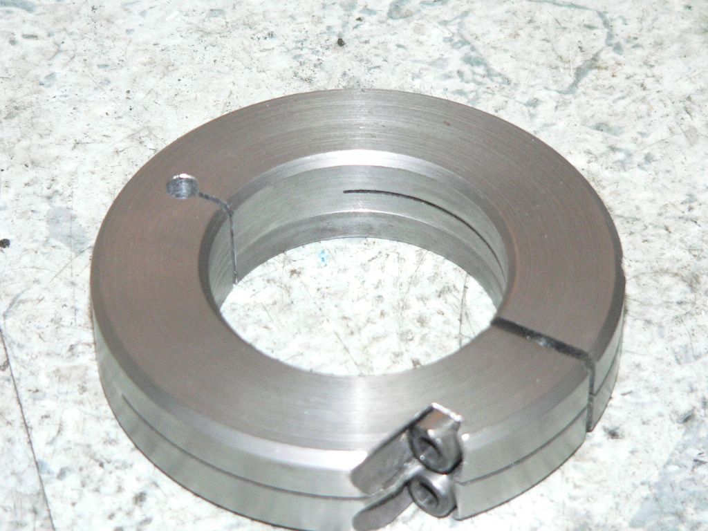

      I'm in the process of machining a backplate out of cast iron, for a new 5" chuck I have. This is for my Myford ML7, and the spindle nose is threaded as you know.
      I have not had any problem with my chucks unscrewing, but it would be nice to have the possibility of running the lathe in reverse occasionaly. And I thought that I might as well make some sort of locking mechanism while I'm at it making the backplate.
      I've tried searching for possible solutions. I've seen some (Schaublin?) use a clamping ring that compresses the chuck spigot onto the register, like this:
      But I was thinking of utilising the collar that is next to the register on the Myford spindle, it's 1/4" wide and 40.9mm in diameter.
      I can extend the backplate to act as a sleeve over that collar, then slit that sleeve part axially. Like this:
      And then use a similar clamping ring, as in the first picture, to clamp and secure it to the spindle.
      What do you think?

          I expect the backplate is typically cast iron ie not very elastic but even if it were steel, you'd have a job clamping it down onto the register on the nose of the spindle, assuming it is nice and parallel and a very close fit.
          Perhaps a collar that is secured to the backplate but still has a small amount of free movement would be simpler – ie held captive to the backplate by 3-4 socket headed capscrews. Then it could tighten onto the spindle nose without having to distort the backplate. This could be pretty secure.
          I'd be surprised if it hasn't been done before on Myfords etc.

            Hi Murray. You are probably right about the stiffness. But Schaublin somehow managed to clamp the backplate onto the register without slitting it!!
            A simpler version that I thought about also, is machining a ~7mm wide spigot with the same diameter (40.9mm) as the collar on the spindle. And then using a steel clamping ring to clamp half on the spindle collar, and half on the backplate. Like this:
            (found at http://www.model-engineer.co.uk/forums/postings.asp?th=47650 )
            Your idea of a collar that is secured to the backplate but still has a small amount of free movement, is a good idea. I too thought about bolting the clamping ring to the backplate, but didn't think of the captive mounting and leaving it free to move, to avoid distortion. I wonder how important that is…?

                  I would not even countenance the idea, let alone try something, that may allow any (even minute) loosening of the backplate from the register. Fretting could destroy the register in no time at all.
                  If you actually need a lathe which operates in the opposite direction to normal, buy one with a suitable spindle, not a threaded one, is my advice.
                  I would think these 'extras' are still only 'belt and braces' protection against the possibility of a chuck unwinding on deceleration, not against possible intermittent cutting forces in the 'undoing' direction at high speed. I may be wrong, but that is my take on it.

                      Just to make it clear, I will not clamp on the register, but on the 1/4" wide collar to the left of the register.

                        +1 for Roger's suggestion. It looks a good idea – especially if the clip clamps around the back of the 1/4" collar.
                        My ML7 has a pretty reasonable gap between the headstock and the 1/4" collar.
                        The other way would be a washer and a draw-bar through the headstock but that obviously has a draw-back in that the bore is out of action.

                            This is a drawing to make my idea clearer:

                                    I like the split collar concept if you have the means to make it. Looks a test of your slitting saw technique!
                                    I try to design things to be as easy possible to make. One option might be to make the collar in 2 parts, connected by some form of pin or bolt. Would simplify the construction somewhat.
