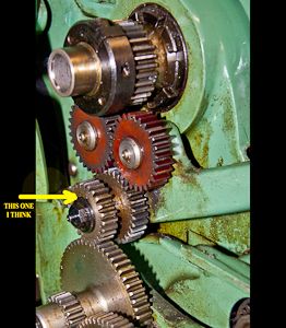

      I Have a Myford Super 7 with a gearbox. As I have never tried screw cutting before I could do with a little help.
      I want to cut some metric threads so bought a set of 33 and 34 tooth gears. The notes said you just have to replace the 24 tooth i/p gear on the tumbler reverse with one of these gears – depending on what pitch you want.
      My question is, on the tumbler reverse, there are two gears. Am I correct in thinking that I just replace the gear that is engaged when its running forward.
      or is it the gear that these two tumbler gears mesh with I should be replacing?
      Thanks for your help

          I too have bought 33 & 34 tooth gears but have not yet used them .
          I understood that they replace the gear shown – but maybe some knowledgeable gent will confirm this.
          ( Looks as if I should do a bit of cleaning up!)

              Hi Andy, I believe Norman’s yellow arrow is pointing to the correct gear to replace, the other three you can see are never normally removed on most lathes with this type of arrangement.

                  That is the correct gear to change.
                  On the Myford chart for metric pitches The 21 gear tooth gear is a good one to get.

                    Yes it is the one Norman posted.
                    You need to select either 33 or 34 depending on the pitch, the chart gives which one and what lever in the gearbox to select.
                    Also as Colin says you need to keep the halfnuts engaged and wind back, either by hand or under power.
                    Ignore the screwcutting dial when doing metric.

                        Just a quick posting to say thanks to everyone that helped me out here.
                        I fitted the ‘new’ 33T gear and set the gearbox to 28 TPI (I think) as per the instuctions.
                        Trying to cut a thread resulted in just a parallel turned bar! The feed seemed way to slow.
                        Having just aquired this Super 7 with gearbox I assumed that everything was ‘in its correct place’ – if there can be such a place.
                        This was the mistake as I found that the 2nd stud gear had been reversed on its shaft. I turned this around and got a lot faster feed rate on the lead screw.
                        Trying not to forget the sequence of events, set to zero on the cross slide, advance the top slide, stop the motor, reverse the direction etc. etc., I ended up with my first M8 x 1.25mm thread. It was only about 10mm long but I was pleased – and so was my Dad and its his lathe!

                          Second stud gear as you call it is made to easily reverse, one way is fine feed [ as you found out <g> ] and the other way is screw cutting.
                          John S.

                            Yes this gear is reversible – one way round for fine feeds the other way for screw threads. You will see from the chart on top of the gearbox there is a box corresponding to the positions of the two gearbox ” levers” There are two numbers in the box – one refers to the TPI with the composite gear on stud ‘A’ in one position, the other to the feed rate( fine feed) with the composite gear reversed.
                            eg . Top L on chart either 8 TPI or 0.0139 in per revolution feed depending on the gear position on stud ‘A’.
