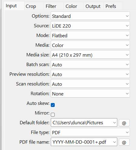

                                          duncan webster 1
                                            @duncanwebster1
                                            Downloaded VueScan, and it makes the scanner do sensible looking things, the carriage moves, the LED bar is on, and I get an image on the computer screen of what is on the scanner. When it opens I just close the window which is asking me to pay. However, the saved fie appears to be 2 files of text, a .cal file and a spreadsheet, no pdf. I’m sure it is a setup issue, but it has me baffled. This is what I get if I click the output tab. Can anyone help?
                                            Screenshot 2026-03-20 204607

                                                #842473
                                                duncan webster 1
                                                  @duncanwebster1
                                                  Just tried te NAPS2 driver, it moves the scanner bar, but doesn’t turn on the LEDs, so black image. Tried the VueScan again, this time it too produced a black image. I think it’s time to call it a day and buy a new scanner
