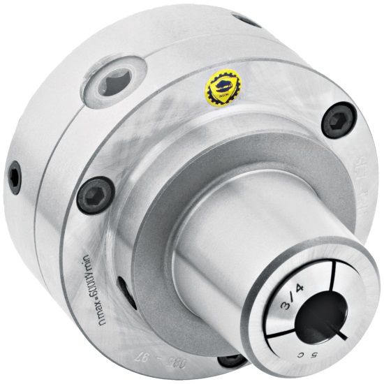

                  #538019
                  Joseph Noci 1
                    @josephnoci1
                    Posted by Ketan Swali on 04/04/2021 10:55:50:
                    Hi Joseph,
                    Surprised to see an EMCO aficionado ask a question about an SC4 headstock. I must be dreaming teeth 2
                    Hi Ketan!
                    Thanks for responding, and your opening line did make me laugh! However you probably realise behind my questions lurks an agenda…
                    What I am trying to do is mechanically unsound, frowned upon and will get me shot on this forum..
                    You may have seen my 'little' CNC lathe project – well, it has taxed all my abilities, including the brain muscle, which has been found wanting…
                    As with everything I do here, the solutions are very much driven by what I can obtain, and what is 'importable' within practical limits!
                    So, the headstock/spindle on this project became a 5C collet setup, with the spindle length dictated by available suitable steel – which ended up being from a section of sheared caterpillar drive shaft…Likewise , the headstock popped out of a chunk of Ali that followed me over the years – no such size material available here! Suppose I could have used a chunk of cast iron from the caterpillar engine..
                    The collet closer is a 120mm diameter handwheel. There is no space for a tommy bar/spanner hole/flat in the spindle nose or rear to hold the spindle whilst fastening the collet with the handwheel. The spindle motor – a 2KW closed loop brushless servo – has a holding torque of around 40NM, so was banking on that holding the spindle while tightening the collet. It works fine..but the manual effort required on the handwheel is too much. I can replace the handwheel with a torque nut, etc, but there are just too many issues that are now turning into a hack..
                    So, I want to remake the spindle, to take a 5C collet chuck ( a Bison unit) – that works like a normal 3 jaw chuck –
                    The chuck is 125mm OD, and 110mm to the collet nose from chuck back. The chuck main body is 125mm OD x 70mm thick. Add the backplate and its space to the headstock and the chuck nose is maybe 125mm from the end of the bearing..
                    My headstock is only 100mm wide…the bearings used are 100mm OD, 50mm ID, taper rollers, which are also an issue – Headstock is oil filled, but is dribbles from the labyrinth seals, and I have battled enough now! So I want to fit 100MM OD, 50MM ID, 30degree sealed, grease filled Angular Contact bearings instead, with a good preload.
                    Intended max RPM is 4000 for short periods, but mostly sub 2000RPM.
                    So, a 125mm OD 5.6kg chuck, 25mm longer than the end to end spacing of the (LARGE) spindle bearings, spinning at 4000RPM….not big loads in the machining, as the stock is limited to what 5C collets can take.
                    I looked at all the links you provided – I looked also at the Little Machine Shop USA site – they have a dimensioned drawing of a C3 headstock – indicates 106mm bearing outer spacing. Don't think a C3 will take a 125mm chuck..
                    Now to get into my bomb shelter…
                    Joe

                    #538035
                    Ketan Swali
                      @ketanswali79440
                      Hi Joseph,
                      Yes I have been following your project… on and off. Always like to see different approaches.
                      I have put all the SC4 rough and read pictures with measurements in the album: SC4 HEADSTOCK. Hope the information will help you to decide your direction smiley
                      Ketan at ARC
                      #538039
                      Ian P
                        @ianp
                        From your description Joe, the problem with your existing spindle is mainly the difficulty tightening the 5C nut.
                        Would not incorporating a spindle lock within the headstock solve that problem?
                        A 12mm or so hole in the spindle wall between the bearings with well supported plunger would not be difficult to arrange as would a few tommy bar holes in the handwheel.
                        Just a thought anyway.
                        Ian P
                        #538041
                        jimmy b
                          @jimmyb
                          My 125mm chuck is a standard size one.
                          Jim
                          #538046
                            Or coul dyou drill two holes into the end of the spindle for a pin spanner to hold it while tightening the collet.
                            A sprung lever action closer would be a another option then you don't have to turn anything just unscrew the unloaded collet when changing sizes.
                            #538065
                            Joseph Noci 1
                              @josephnoci1
                              In some sort of order…
                              Ketan, thank you very much for the photo's – your efforts much appreciated. The C4 headstock is a good 50% wider than my setup. Although the loads and stress calcs indicate the bearings I have are loafing along, somehow I just am uncomfortable putting that 6kg of steel hanging outboard on this narrow headstock..
                              Ian P and Jason – I think a solution is going to be along your suggested options. The Sprung Lever closer may bear some research…
                              Sometimes staring at a problem for too long results in solutions that are a bigger problem!
                              Thank you everyone for your input.
                              Joe
