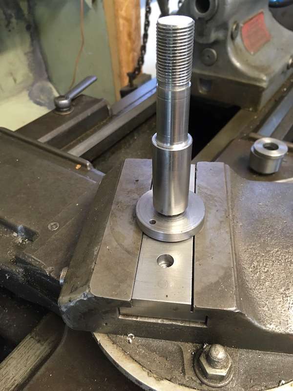

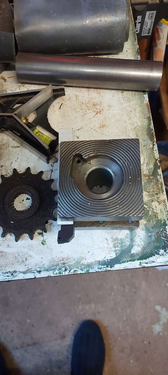

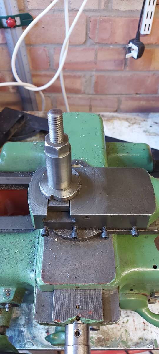

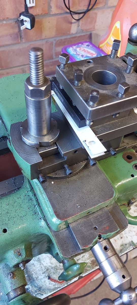

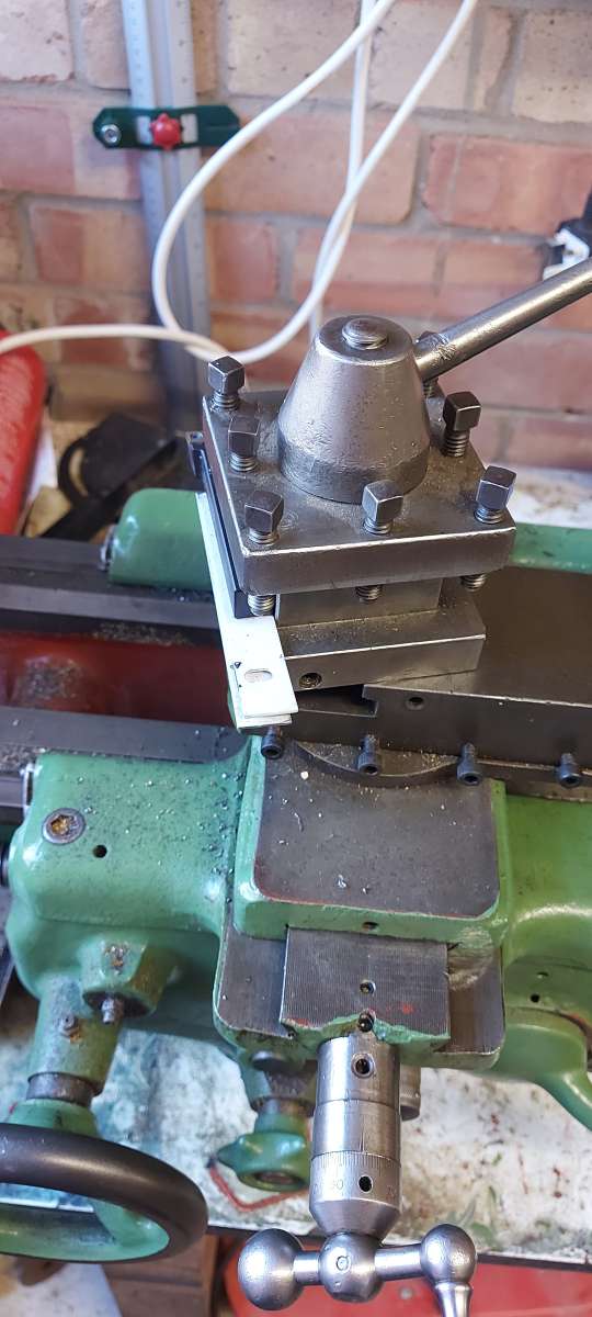

                Thank you for the replies, lots of reading. Here are the photos of what i have. Looks like i just need a quick release tool holder that will go over the existing post. The post is 1 inch diameter.
                Don’t need the rachet it was never there.

                  Objectively the T-nut is still a little short. Looking at the scuff marks on the top-slide surface it’s evident that the tool post hasn’t been sitting quite as firmly at diameters greater than the length of the T-nut. Flatness error is almost certainly small enough to be hard to correct so a thin aluminium washer will take up the difference just fine.
                  With luck a Dickson clone will have recess big enough to go over your ratchet base.
                  However that is seriously good small four way.
                  In your position I’d save myself a small fortune by re-instating the ratchet and making a couple of copies by gluing and screwing together stock sections of plate and bar. Many years ago I made some for my SouthBend’s using steel plate top and bottom with a square section light alloy centre. Worked well and my (Twiggy skinny!) wallet was much happier for it. Made a very effective a poor boys QC system swopping pre-loaded blocks carrying 2, 3 or 4 tools as desired. Never got round to making a nice ratchet, like yours, which would have made it so much better. If you have your shims organised setting up by measurement off the machine is much easier than the “sort through random scraps then cut and try” on the machine process that many less experienced folk resort to. If you plan to use carbide inserts, whether mostly or all the time, the ready height adjustability of a QC is irrelevant anyway.
                  To exploit a QC you will need a good centre height gauge. I like the optical type. Basically a reasonably thick, 6 mm or more, piece of perspex arranged to stand vertically on a convenient part of the machine with a line scribed at centre height on both sides. Use a sharp centre in tail or headstock to get it right. Two lines on opposite sides of the transparent upright make it easy to avoid parallax error it you have to squint across from a distance. The lines merge into one when you are looking straight. Mine can also mount a small mirror at 45° so i can look down from above if need be.
                  Don’t skimp on QC holders. Common consensus is that at least 8 are desirable, plus a parting tool carrier, to give you a useful preloaded set to cope with most jobs. The whole point of a QC is that you change out pre-set tooling. Not merely a slightly easier way to set re-ground tooling back to centre height. I’ve got 16 or so holders to share between my two lathes. Both tool posts have been carefully shimmed so the tooling can swop from one to the other without adjustment.

                    The Sabel is a 4.5in lathe same as the Boxford. So you want the next size up from the ones sold for Myfords. You can use a (cheaper) Myford size but will need a thin spacer plate.
                    However it sounds like you are a bit new to the game so a QCTP is well down the list of things you need. They are a bit of a modern obsession and while nice to have they just are not the solution to any problems you are having.
                    That’s a very nice 4-way so you would be better off making a couple of extra blocks for it. “too difficult to make”? then you don’t have anything like enough experience to justify spending on a QCTP.

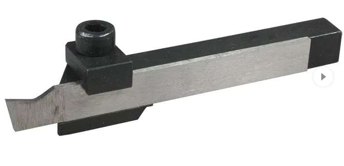

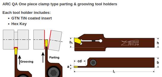

                                      Parting off being the most difficult of the basic lathe operations is a subject in itself.  The cutter is broad and needs plenty of power to drive it. The lathe has to be as rigid as possible, so small lathes are a problem.  Big lathes cope better, but not if they’re worn or out of adjustment.   (Condition matters: where is your Sabel on the “as new” to “beaten to death” spectrum?)   A steady hand is needed, or – much better – a powered cross-slide.   Vital to clear swarf and lubricate, especially so with deep cuts.   Front tool-posts being bendy make parting off from the rear popular.  A “Gibraltar Toolpost” fitted at the rear of the slide is more solid, and it grounds cutting forces more effectively, making it less likely the saddle will lift and twist.
                                      I use three different types, all sold by ArcEuro, from whom I’ve stolen the pictures, other suppliers available:
                                      1.  An  8mm HSS blade. Used mostly on small diameter Brass, though it does steel too.  Not so good at deep cuts.  The example pictured shows a blade with relief, which is awkward to resharpen, and doing so alters the tool height.  I use an easily resharpened flat blade, no relief, that probably doesn’t cut quite as well.   HSS requires a grinder and grinding skills; not everyone is good at it!
                                      parting

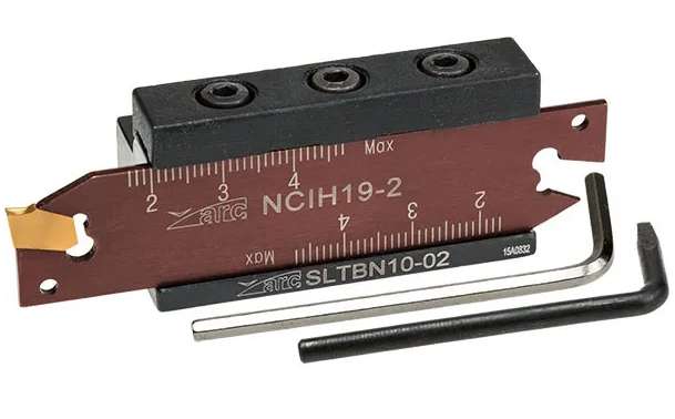

                                      2.  A carbide insert holder.   No need to sharpen, and the tool-height isn’t altered by replacing the insert, but carbide prefers to be run faster and harder than HSS, and older lathes may not be up to it.  (Fast cutting with carbide inserts was science fiction when the Sabel was designed.)   That said, carbide mostly works “well enough” at slower speeds, and it would be good for grooving large diameters on a slow lathe.   I mostly use mine for grooving and parting small diameter steel and harder metals, but not as much as expected – see entry No. 3!
                                      arceuro
                                      3. Is a blade type holder, the advantage being they are stiff enough to take deep cuts, the one pictured parting off up to about 70mm diameter.  I use mine a lot, almost everything apart from fine work in Brass or Aluminium.   It’s rear-mounted in a Gibraltar tool post and the lathe runs in reverse at 2500rpm .   Don’t do this with a simple screw-on chuck, because they come undone!  But reverse is fine with bolt on and cam-lock chucks.   If the lathe can’t do reverse safely, the tool can be mounted upside down and the lathe spun normally – still better than a front tool-post.
                                      blade
