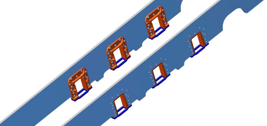

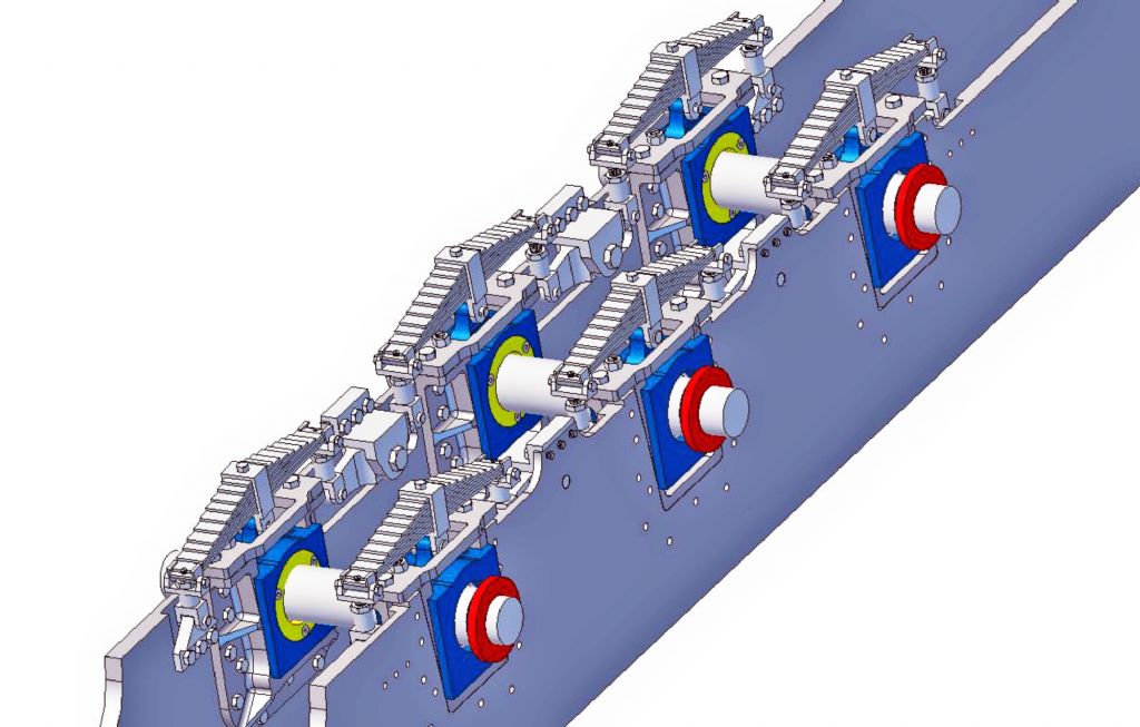

      I am preparing designs and casting patterns for this 1910 South African locomotive model.
      CAD model of frames with hornblocks installed
      **LINK**

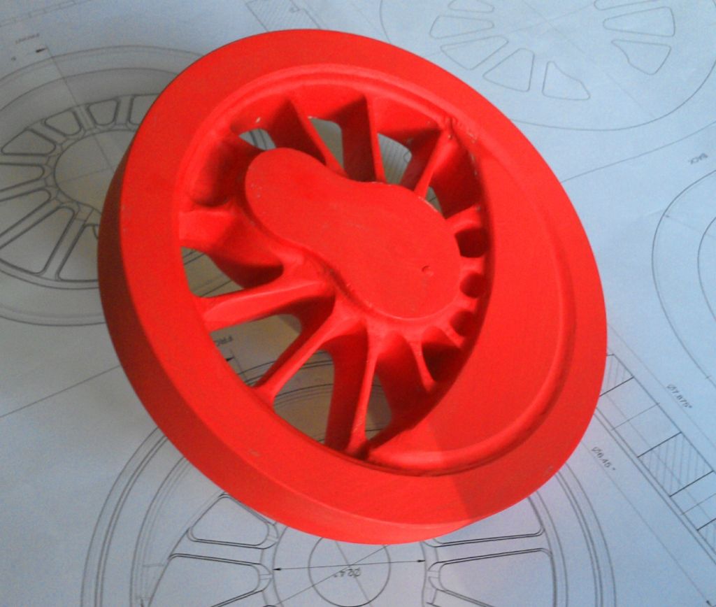

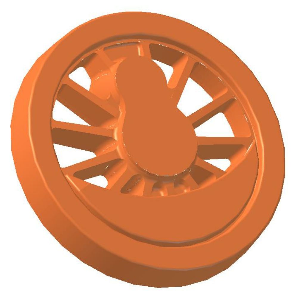

          I have completed the pattern for the driving wheels, this has a bigger balance weight and a larger boss for the crankpin

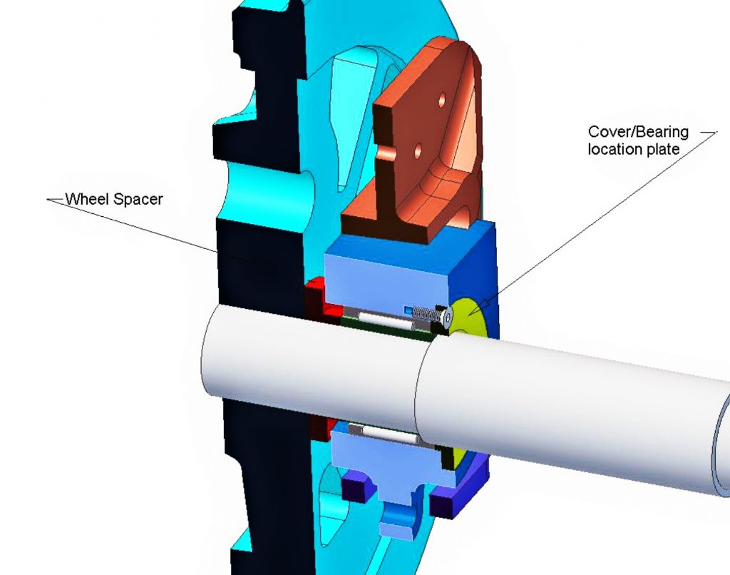

          This is the bearing arrangement for the driver and coupled wheels incorporatingsealed needle roller bearings

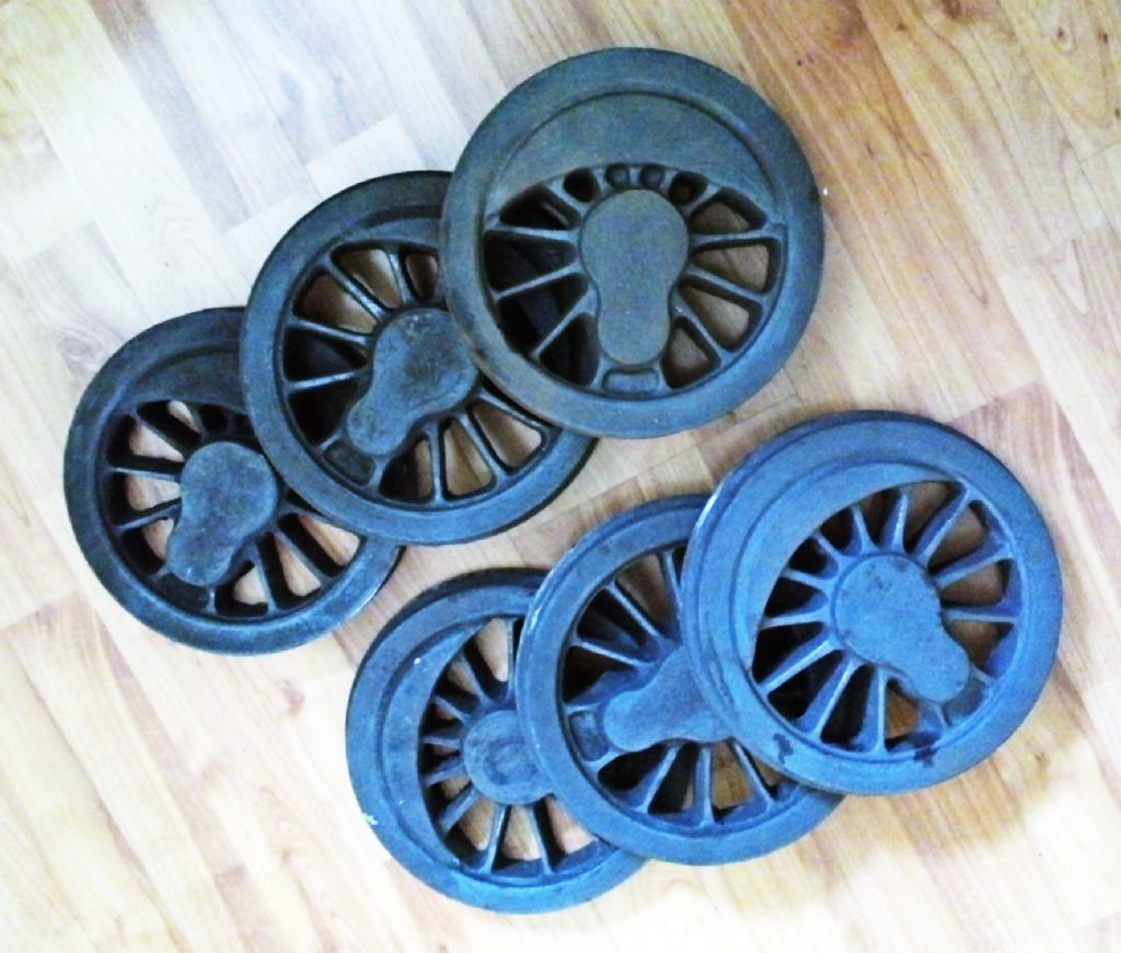

              Full set of Driving and coupled wheels

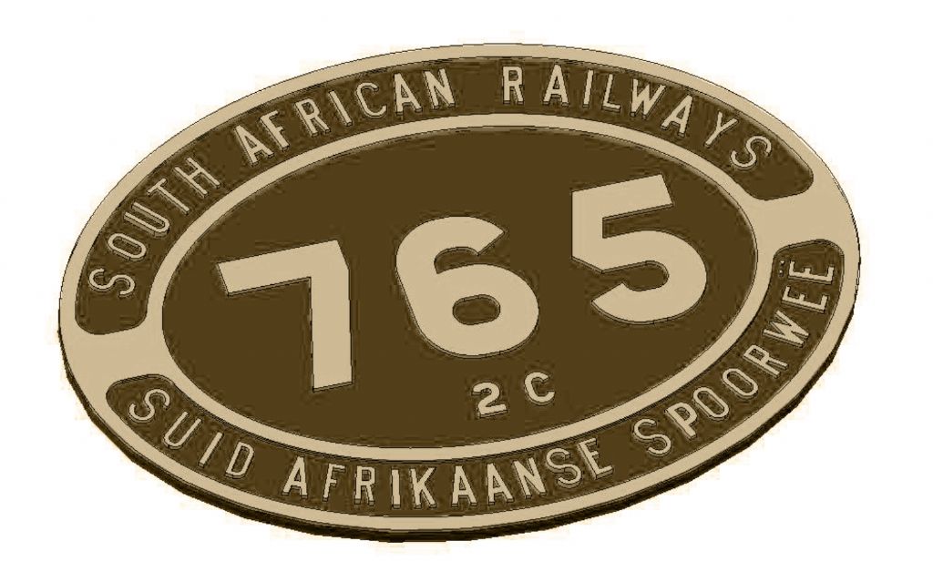

                Cabside Plate design

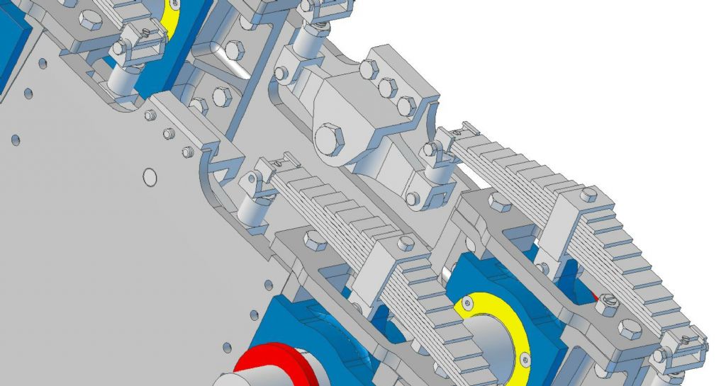

                #146147
                Ennech
                  @ennech

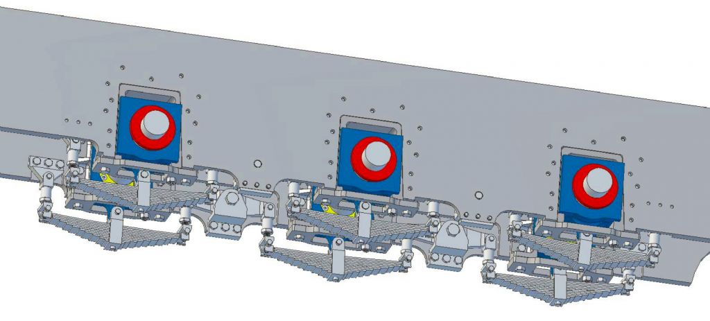

                  sar class 2c assembly 0503 3.jpgsar class 2c assembly 0503 2.jpgMain Suspension design
