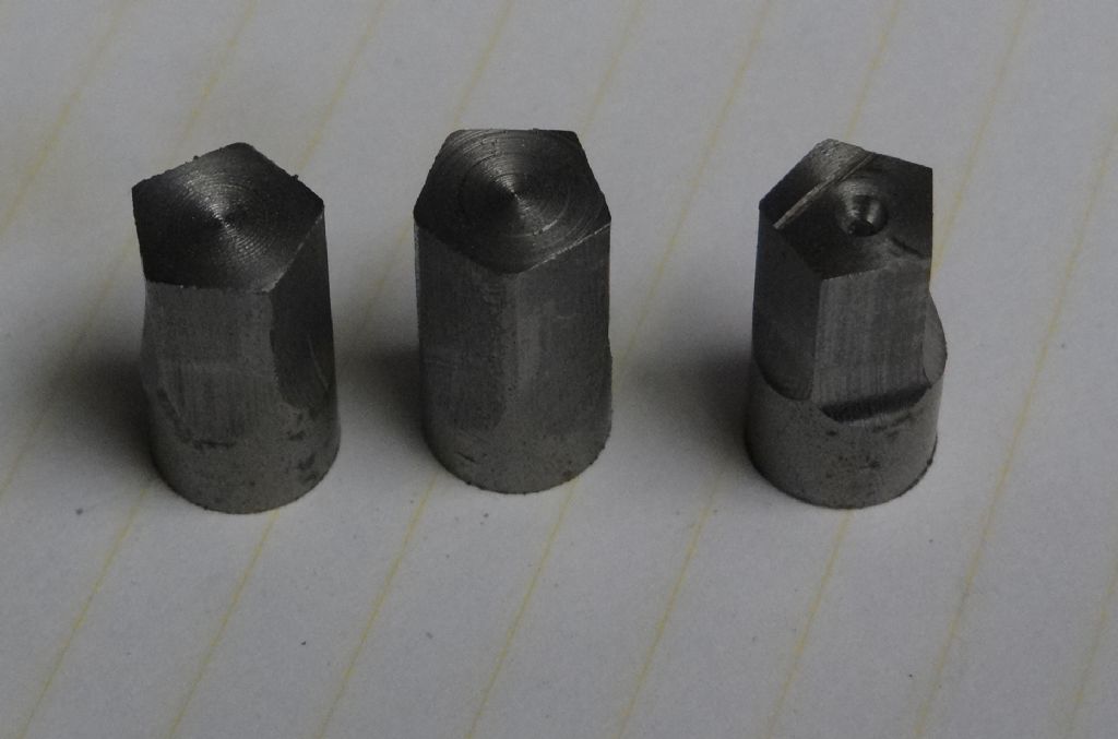

          Final Report on Rotary Table run-out and cutting a pentagon.
          This time I set the table up with no tailstock and with a length of old hacksaw blade stuck between the rod and one jaw in the chuck. This caused a whopping 1mm run-out where I cut the hexagon. On a 10mm diameter rod, this is a 10% error. On a 50mm gear wheel, it would be a 2% error. I used the upper flutes of a 12mm carbide cutter and took a 0.9mm cut at 2000 rpm.
          Results were fairly good.
          The flaws are much easier to see in real-life than in the photo. However:
          • Leftmost was made with the most rigid setup. Finish, centricity and dimensional stability are all good.
          • Middle example was cut unsupported. Centricity is acceptable, finish and dimension stability are both somewhat compromised. It looks rough and is!
          • Rightmost example was cut unsupported and with 1mm runout. The finish is good, demonstrating perhaps an advantage of carbide cutting at speed. However although the pentagon has good shape, it's eccentric, surprise, surprise! This pentagon is also undersized at 8.7mm vs 9.2mm (target 9.1mm) I'm not sure why carbide should cut deeper than HSS at the same setting, unless it's operator error.
          For use as a security key I would say the pentagons are all acceptable. Where it matters only the fully supported example has any claim to precision.
