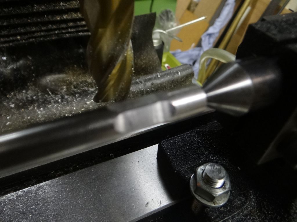

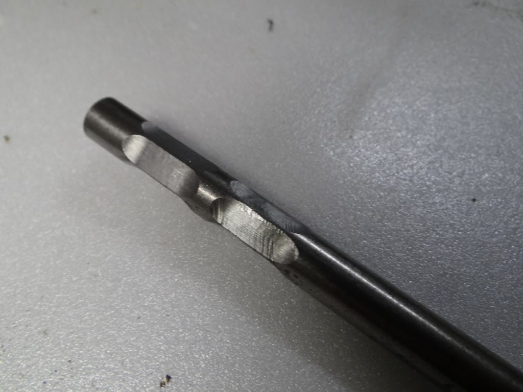

            OK, so this is what I did. I haven't measured the end results like Iain yet or come to any conclusions.
            First I set my HV6-type rotary table up:
            As table is bolted down at the front it tends to twist slightly as the bolts are tightened. I use a set-square to check all is well because of the 'run-out' this causes.
            To discourage tilting, the table is clamped at the back.

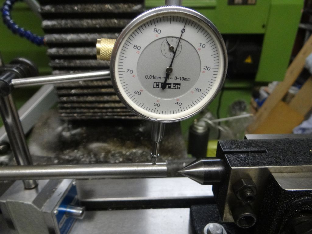

            The test rod is a 250mm length of 10mm diameter Bright Mild Steel. The end has been faced and a centre drill used to make a pocket for the tailstock's fixed centre. About 210mm protrudes from the chuck.
            At 220mm from the chuck turning the table revealed the run-out to be 0.2mm. Tightening the table's locking clamps improved this to about 0.1mm. On the other hand I was able to bend the rod 0.53mm with my finger.
            Fitting the tailstock made a considerable improvement. Firstly the 'run-out' at the end of the rod is reduced to zero. Secondly the finger test requires a lot more force to move the DTI. This picture is blurred because I was pushing as hard as I could. This is about 0.04mm and I was able to reduce the deflection further by tightening the tailstock.
            By calculation I found that a pentagon required the table to turn 72° per flat and that the depth of cut needed on a 10mm diameter rod was 0.95mm I actually used my DRO to cut 0.9. In terms of accuracy the DRO is +/- 0.02mm and it's quite easy (for me) to overshoot by up to 0.04mm when cranking the mill table. I used a 20mm diameter TiN coated 4-flute HSS cutter to make a sideways cut with the cutter positioned to use the upper part of the blades. The idea was that these will be less worn and more rigid.
            Each time I turned the rotary table to cut a flat I clamped it and all the other non-moving axis. I used the set-up on the same rod twice, first with the tailstock and then without.
            Next post: the results.
            #290923
              My micrometer isn't in it's box. I wonder where I've left it.

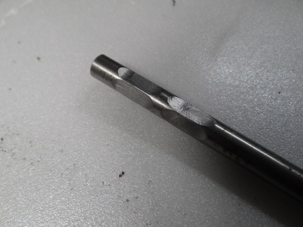

              Without a tailstock the rod visibly vibrates during cutting, perhaps as much as 2mm, and the tool chatters. Although not scary bad it doesn't sound as smooth or feel as controlled as the more rigid arrangement.
              Anyway here's the pictures:
              It's fairly obvious that the tailstock supported pentagon is better looking. It also appears to be more regular. I'll post the measurements as soon as I find that pesky micrometer.

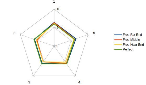

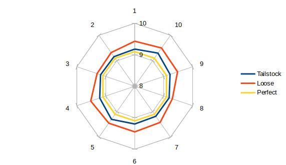

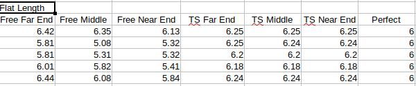

                I've been busy taking measurements and drawing graphs. All dimensions in millimetres.
                These tables are roughly equivalent to Iain's change over distance. This one shows dimensions when the work is unsupported:
                And this is when the work is supported by a tailstock:

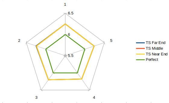

                Graphically the difference looks like:
                The tailstock supported cut is closer in shape and dimensions to theoretical perfection than the unsupported cut.
                The change of cut depth when the work is unsupported is up to 5 times worse than when the work is supported. In both cases there is evidence of a taper.
                Next I lathed the ends off the test piece so that I could measure the widths of the flats, ie the legth of one side of the pentagon.
                The figures reveal much more variation in the unsupported ('free'  pentagon, than it's Tailstock supported equivalent.
                This graph overlays the shape of the pentagon over about 8mm length of rod. (I wish I'd taken longer cuts!) You can see that although the table holds the 72° angles the dimensions of the pentagon change. There's a hint of twist too, though that might be a coincidence.
                The equivalent graph when the work is supported by the tailstock is neater. The lines almost overlap showing that the pentagon is dimensionally stable and there is no hint of twisting. Only the blue far end edges out on axis 2, this being consistent with the slight taper noted earlier.

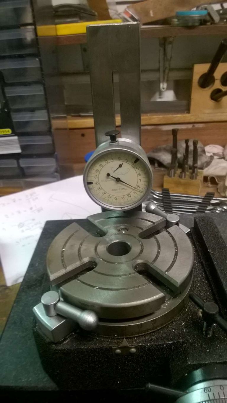

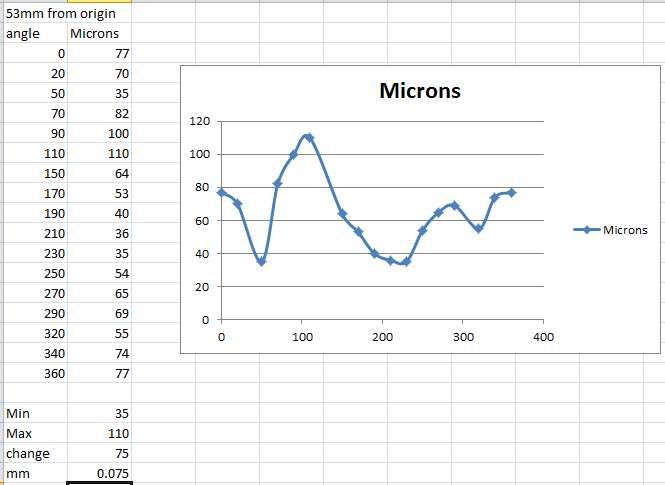

                  Again, for information, I was measuring the run-out by rotating the table with the test bar in a collet and a dial test indicator resting on the top. not along the test bar.

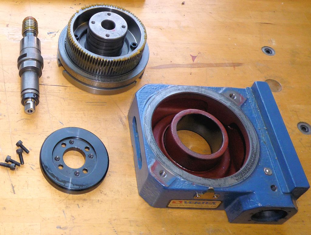

                  What I've just done is to take the table of the mill and put it on my surface table to see if the table itself is flat. In the process I note that the MT2 taper appears to be integral to the table and not an insert as someone suggested.
                  I rotated the table and measure the relative height every 20 degrees or so (the slots made that impossible in all places). the indicator was around 53 mm out from the centre – by coincidence close to the distance I was testing run out on my test bar.
                  My results look like this.
                  In truth, I'm not quite sure what to make of this. I think it says more about the lack of flatness of the table than any run out. If the taper axis was perpendicular to the surface of the table, I would expect about the same gross error at the same distance along as across. I'm only seeing half of that and the shape of the error doesn't make much sense in the context of a single angle incorrectness.
                  What my original post was really asking (before experimental physicist, Dave, took us to the heights of professionalism) was if the table could be adjusted. I mainly asked this because the rear of the table appears to have a sort of push pull arrangement of grub screws and I wondered if they could be used to correct the tilt.

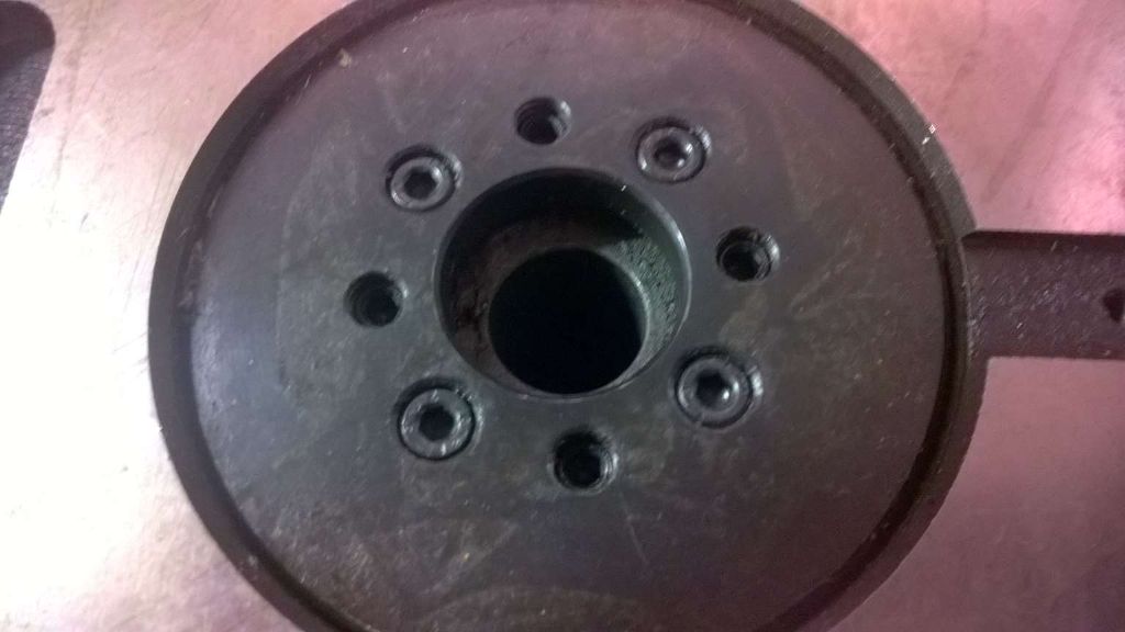

                  Iain

                      Journeyman
                        @journeyman
                        Iain, the black plate on the underside simply bears on the body casting to prevent table lift. The combination of four cap screws and four grub screws adjust the clearance. If you loosen all the grub screws and tighten the cap screws the table will lock up! It is an excercise in patience to adjust the plate so that the table turns smoothly with no appreciable lift. I took my 4" Vertex apart when I motorised it. Everything is fairly crude inside, no bearings as such just cast iron to cast iron faces. Picture below shows some of the parts:-
                        The critical measurements would seem to be the flatness of the base which also needs to be at 90deg to the end when used vertically and the parallelness (is that a word) of the top to the bottom. I don't think any of these are really adjustable by the user, save with a surface grinder, it is more a matter of making allowance when setting up / maching a part. It also occurs to me that whatever is in / on the rotary table is at the end of a long chain of things that can be out of true. i.e. R.T. square to mill table, vertical to mill table any swarf under the table? this of course assumes that the mill itself is absolutely "in tram" in all directions. Loads of variables which all add up if just slightly out. Me I'll just work to the nearest mmdevil

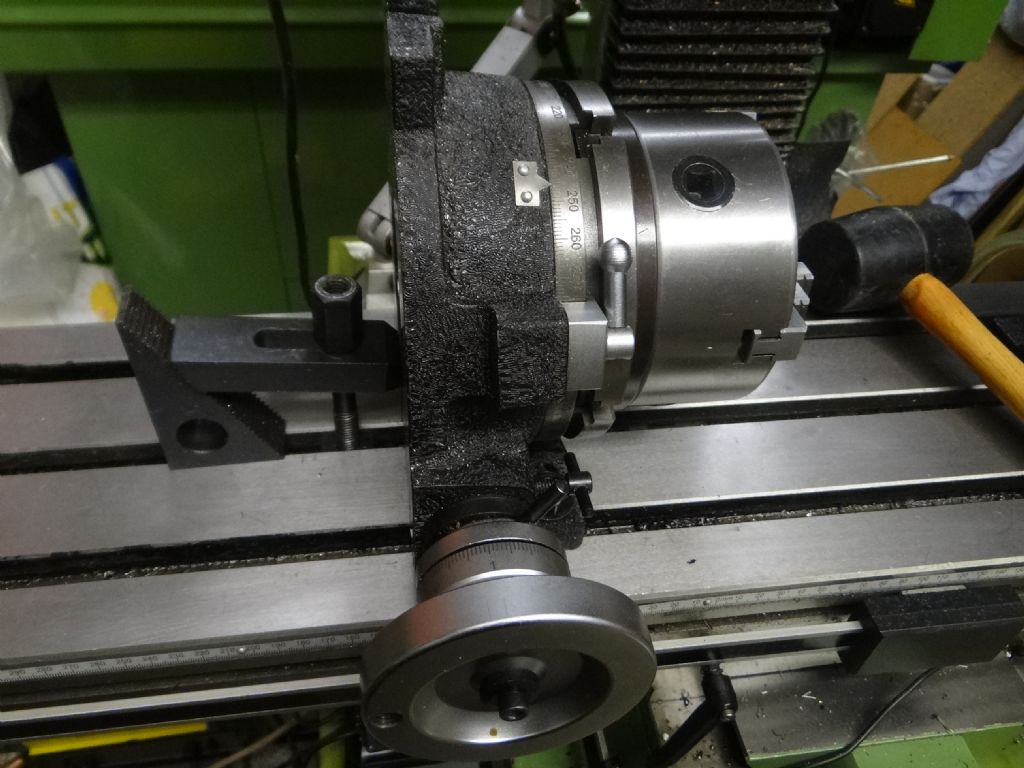

                                    Personally, if the workpiece is unsupported at the other end (and better practice even if it is), I would never use a rotary table just being clamped to the mill table by the base, even with a clamp on the back as well, as there are lots of leverage forces at play.
                                    As well as the RT being clamped to the mill table, I would use a big angle plate or box big enough to also reach the top flange mount of the RT and clamp it there, as well as to the table.
                                    Supporting the workpiece at the other end would probably cure most of the issues, but it still offends my engineering eye to see a RT just clamped near the table like that.

                                        Excellent! I hadn't thought of doing that.
                                        Reinforcing the sense of David's suggestion, although I successfully jammed a rear clamp into the groove at the back of the table, I don't think the slot is intended for that purpose. It's only about 5mm deep and using it didn't feel quite right.
                                        The only down side is that I don't have a box or angle big enough to reach the top flange. On no! Another new entry on my ever growing 'to-do' list.

                                              Posted by Journeyman on 29/03/2017 09:58:55:
                                              Iain, the black plate on the underside simply bears on the body casting to prevent table lift. The combination of four cap screws and four grub screws adjust the clearance. If you loosen all the grub screws and tighten the cap screws the table will lock up! It is an excercise in patience to adjust the plate so that the table turns smoothly with no appreciable lift. I took my 4" Vertex apart when I motorised it. Everything is fairly crude inside …
                                              Thanks for posting the photos … it's always interesting to see the guts of these things.
                                              I was surprised to see that they use four of each screw [given that three of each would be both technically superior and 25% cheaper]; but I'm sure John Stevenson will be pleased.
                                              #291233

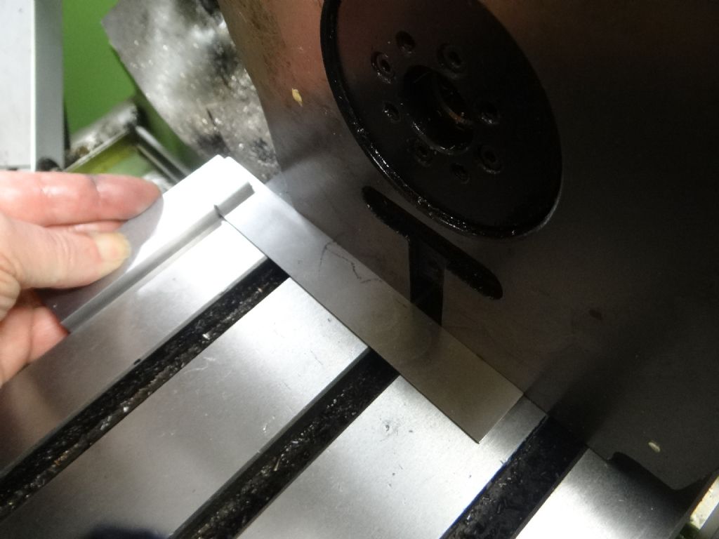

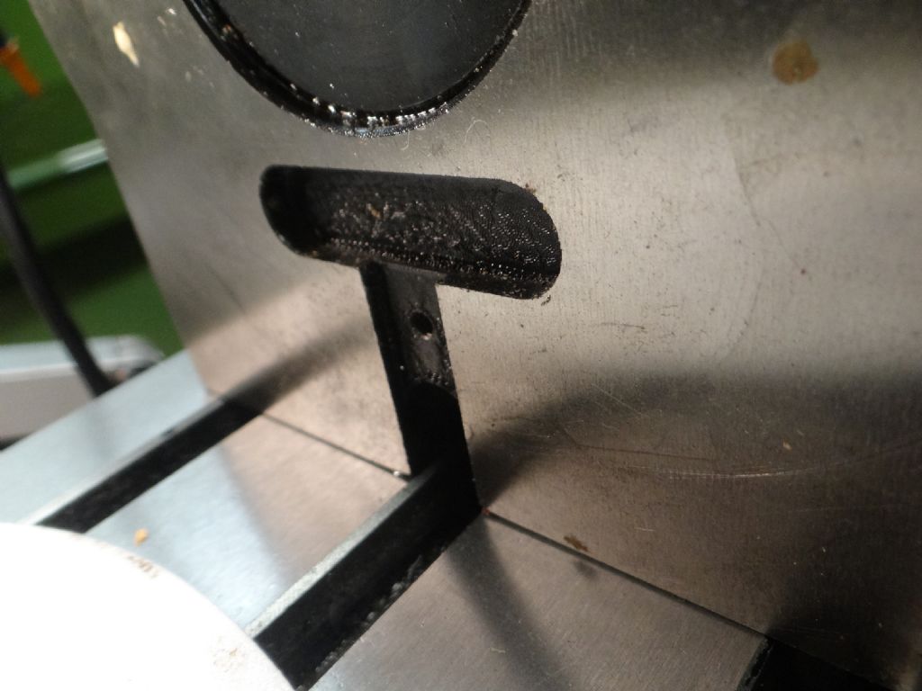

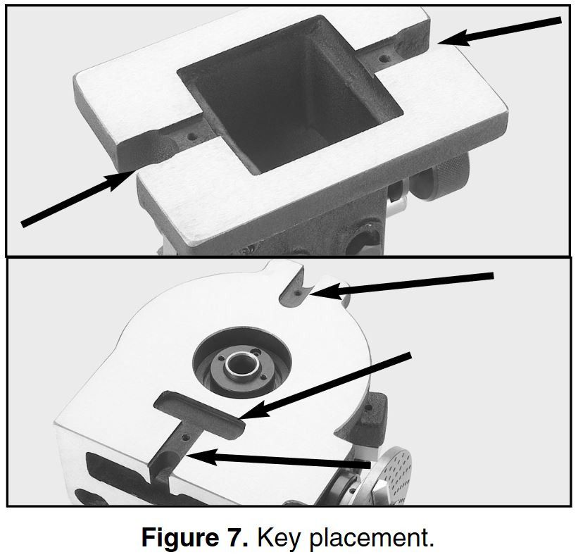

                                                I was going to question Neil's comment using the photo below to show that the vertical part of a 'T' shaped slot couldn't possibly be intended to take a clamp.
                                                On closer inspection, I think I'm wrong . The vertical slot has a construction hole in it and there's a matching hole at the top of the table. The holes have been protected by shallow slots, one of which happens to be part of the 'T'.
                                                Apart from being used to take a clamp, I can't think of any purpose of going to the trouble of cutting the slot forming the top of the 'T'. Score so far Neil: 1; Dave: 0

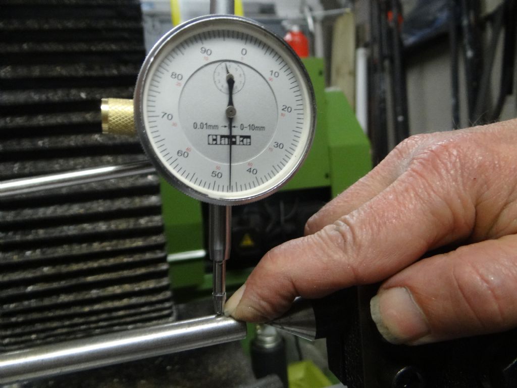

                                                After removing the rear clamp I put a DTI on the chuck. Then with 250mm of 3/4" steel pipe in the nose as a lever, I found the following movement:
                                                • Locking clamps undone: 0.12mm
                                                • Locking clamps applied: 0.06
                                                • Rear clamp and Locking clamps applied: < 0.02
