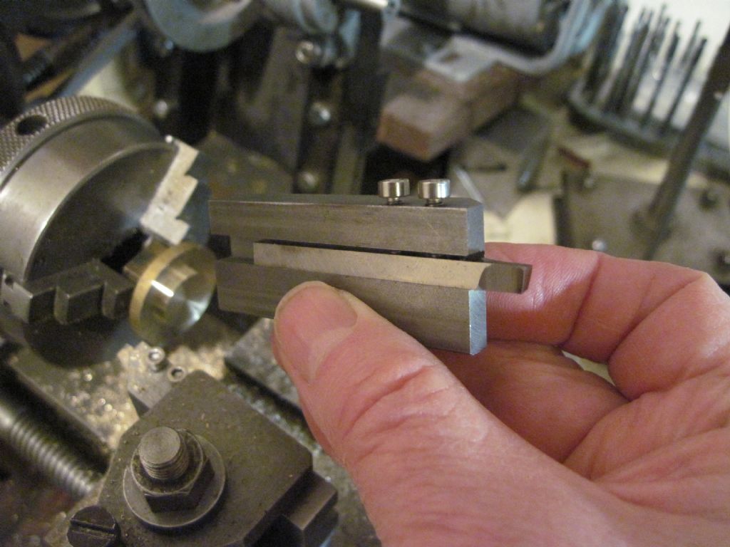

      I was interested to see Rob Renshaw's note about Simple Tool Holders in 'Scribe a Line' (MEW 301).
      I made a set of Rose Blocks a few years back for my EW 2.5" lathe, having first tried a small QCTH. The QCTH had a lot of overhang and also restricted the cross-slide travel. Additional toolholders were also fairly pricey. I'd read the article by Dr Rose and decided they might solve the problem.
      I made half a dozen (I did mine on a shaper) all to the same dimensions and to take 3/16th HSS tools. I then made a clamp block to get the tools on centre height. For brass tooling (with no top rake) I don't need to pack the tools, they are at the correct height. Even where a shim may be necessary on other ground tools, once set that's it, they can be moved in and out as required without further setting – no different from a QCTH really and much easier to make.
      Although not the original reason I made them, they do hold the tools very rigidly too as Rod mentions. Obviously they won't suit all uses (or users) but they certainly work well enough on my EW.

          I like that design.
          Years ago I made something like it for my EW, by drilling holes at appropriate angles in short pieces of rectangular-section steel bar, to take tools ground from old milling-cutter 1/4" shanks and the like. They are not a cohesive set like yours though.
          One extension to my idea may be to put small locating fences on the blocks to engage the top-slide corner, giving a simple quick-change function. Does that clamp-block have a rebate to the same effect?

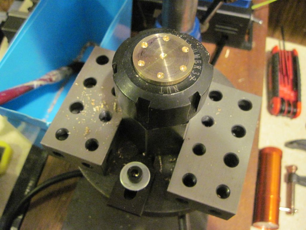

            I need a large blanking plug for one of my boilers (for testing) and found a suitable piece of brass in stock. As there wasn't anything 'spare' to hold on to – I used a shellac 'wax' chuck to hold it and turned the outside edge and inside face on my EW (you can see the partially turned part in the toolholder photos above. I find my soldering 'station' hot-air gun very convenient for this operation (it was really acquired to solder SMD components). It gives very controllable temperature and doesn't overheat things – albeit it's slower than using a gas torch. The photo shows the part being "un-attached".
            Heating a Shellac Chuck
            I then needed to index the part and drill six mounting holes. I normally use my rotary table for this (but it was down the Shed). I'd gripped the part in an ER32 chuck to face off the other side, so decided to use my Hex collet block to drill the holes. First problem was (with the vice mounted) there was insufficient clearance to set the block vertically. A simple solution was to bolt two 20-40-60 blocks directly to the table (via 8mm bolts and the table slots) with a front stop. These held the block very firmly. This then allowed the holes to be part-drilled – I couldn't go right through as I didn't want to damage the collet.
            Vertical HEX collet Block
            I should mention that whilst still chucked in the EW, I'd run a spotting drill into the centre. Dividers were used to then mark the hole radius. A sticky pin in the drill chuck was trued and set to this radius mark (easy to see with my Optivisior). My Cowells drill has a very useful design feature in that the table's 'arm' can be swung, as well as having a table that rotates. So a part can be fixed to the table and then simply aligned by moving the part through the two arcs possible. I've fitted a collar/clamp (which sits under the arm) to the drill's main column so that when the arm itself is unclamped – the table doesn't just drop but can be swung to either side.

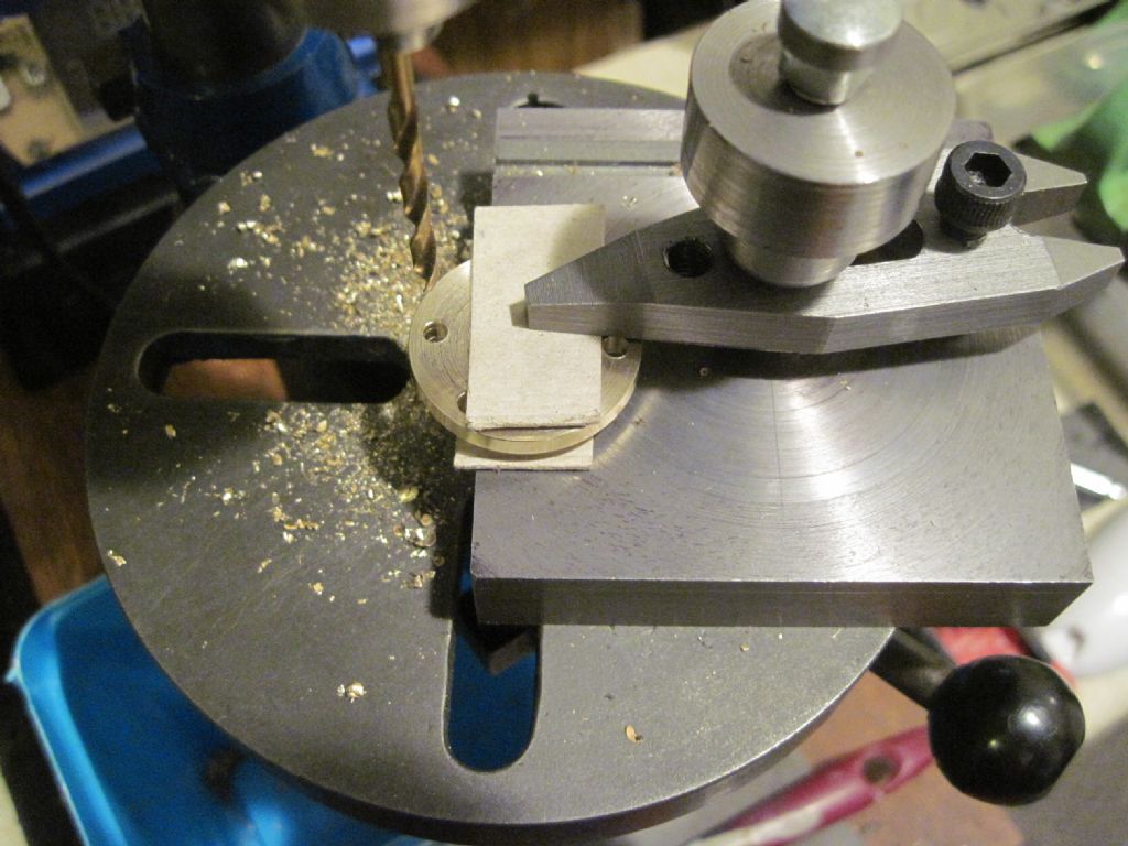

            Finger Plate on drill table
            To finish through drilling the holes, the part was clamped in my finger plate. Something that may not be obvious is that the long (8mm) central bolt can be screwed right through the base plate and in this instance there is a wing-nut holding the plate in place on the table. The finger itself is then tightened using the finger 'knob' & cap-screw.
            Anyway – that's the blanking plug finished hopefully. I will try a test fit this evening and all being well make a gasket for it. I hope this wasn't too basic for the experts here and that maybe there is something here of use to others.

              I fitted a spilt circular clamp to an Elliot 'Progress' drill column for the same support, particularly as that drill's table is heavy, most easily raised and lowered with a scissor-jack from an old car.
              Neat finger-plate – I don't think I've seen a double-ended one previously.
              You could try using a T-nut for that centre clamping-screw, with a wing-nut or knurled knob up on the top.
              Just a thought with circular, rotatable drilling-machine tables as on your Cowells. Assuming the table can be centred under the spindle and its centre faithfully follow an arc from it, how feasible would it be to add to it a simple indexing plate for drilling pitch-circles? A 24-hole plate would accommodate the vast majority of such tasks, including 8 holes.

                I've thought about several 'improvements' over the years Nigel (including guides on the blocks) but never quite got around to them. I did fit a 'guide' piece/block that a) generally positions the blocks and b) supports the clamp adjusting screw and its foot. This guide isn't currently fixed in place and can swivel – allowing the blocks to also be angled, which can be handy for chamfering etc. I may drill it for a removable taper-pin one day. I have considered fitting an 'end' stop (to make things a bit more 'repeatable' ) but haven't found a desperate need for one yet.
                One thing I didn't mention is that when making these holders (from bright mild steel) the bottom will NOT be flat. I took a very light skim over the bottom surfaces. Otherwise they will tend to move, even if firmly clamped.
                These blocks are very simple to make and use and perhaps it's best to keep them that way. A spring lifts the clamp when changing blocks and (again) whilst I've thought about a handle (instead of the nut) but it's never quite reached the top of my TUIT list…

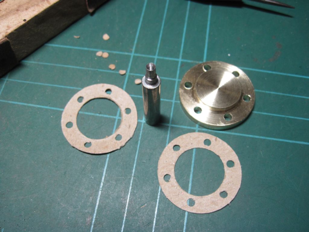

                        The blanking plug fitted well and I've made some paper gaskets for it. Amazon use a nice thick brown 'packing' paper that looks ideal, so I've used that. In the past I've used a plastic 'circle cutter' to cut these but never been very happy with them – especially on smaller diameters. After throwing several attempts in the bin, I simply used a compass to draw the inside hole and cut it out with a scalpel. I then cut the outside diameter using the plug itself as a guide. I don't think my circle cutter will see use in this area again. Sometimes simple and obvious is best!
                        The holes I've made in the past with a (leather) hole punch but I again decided to change tack and made a simple custom punch. It's very easy. I chucked some 6 mm mild steel rod, faced it and then centre drilled it with my smallest centre drill. I then turned it down to 3mm (to fit the holes) – which gave a sharp end. Then using low-peel masking tape (to hold the gasket in place) I punched away on top of a wooden block. There was no need to harden the punch.
                        I hope this helps someone here – it was (and still is sometimes) often the simplest things that caused me the most headaches.
