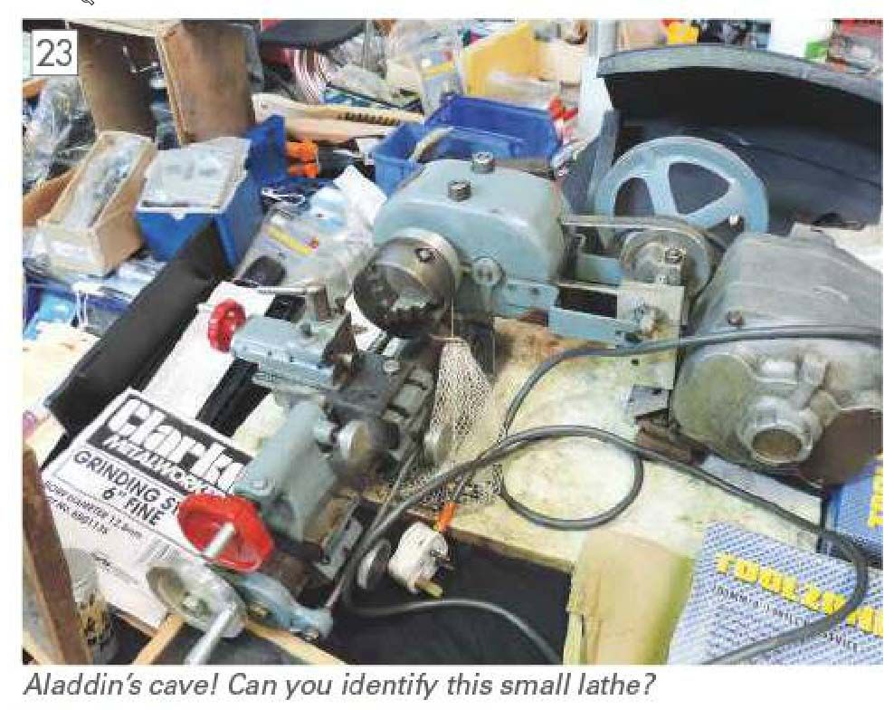

      Another funny little lathe in a tool lot that just arrived, a ROLLO 'ELF'.
      All came apart and went back to gether OK but this strange rod linkage was separate from the machine and obviously goes on the back and hooks up to theeccentric on the shaft driving the spindle. Runs in the 2 small brackets at back. The tailstock end has a spring detent in it but cannot see what it does or where it goes?
      Any thoughts will be welcome please?

          Does the round part of the linkage fit somewhere on the leadscrew handle/bracket so you can operate that gear engagement lever on the rear of the headstock without having to reach over the back of the machine and risk getting one's cuff links entangled in the chuck?

                Might this be a basic longitudinal feed mechanism ?
                The Elf being a plain lathe there is no gearing between the spindle drive & the leadscrew – the "added" bit on the input shaft looks eccentric, so could this cause an oscillation at the leadscrew handle end to give a shaper-like cyclic "nudge" to the leadscrew ?

                  Nigel B, I think that you have the right of it. Had another look and took these pics, the linkage seems to go on the serrated alloy part on the leadscrew.
                  The leadscrew end has had a bit of a knock and is slightly our of true so am a bit wary of running it all hooked up .

                      It doesn't help much but this photo from MEW231 shows a similar bar to the rear of the bed that looks like it might have been supplied like that.
