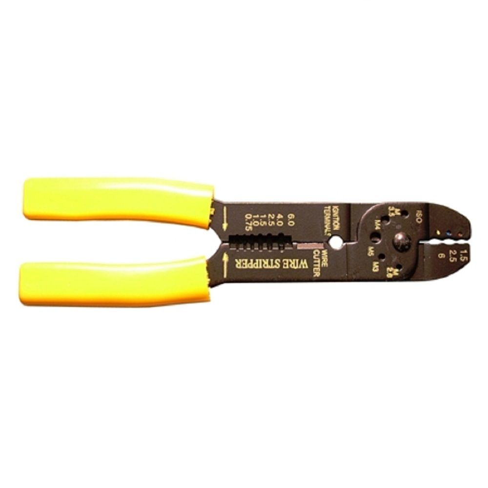

      How do you cut rivets and bolts to length? I have had considerable success in trimming BA bolts to length using electrical crimp pliers which have a set of threaded holes (Metric thread). Screw your bolt into the hole and use the pliers to shear the bolt to length. This also works well for rivets 1/8" ro 3/16", but not small enough for smaller rivets. How do you cut rivets and bolts to length – especially when you have lots to do and a standard length is not available ?

          I mostly make my own bolts, or design to use a standard length, so not an issue. For shortening rivets I will be making a jig for use on the repetition lathe. The rivets are 3/16" and 1/4" steel, so I doubt the cheaper crimp pliers would cope.

                  Search for "rivet cutters UK" on google turns up a few likely candidates working on similar principles to the multi-function crimp-shear-stripper pliers in your picture. Expensive to very expensive tho'. Intended for aluminium rivets but some offerings look very hefty for that job.
                  Flat face wire cutters, as used by piano tuners, work pretty well on small ones. Best to get the double lever semi-parallel action type as these leave a near flat end. Less of a squeeze too. Sorry I'm not sure what the real name is, they look very similar to common nail extraction pinchers.
                  Be careful not to overload yours. I've had to weld 3 sets back together so far! Also the coloured sleeve bullet et al connection crimper doesn't make a "to specification" crimp and won't cover the full range of wire sizes each sleeve is supposed to take. I'm glad I splashed out on the proper thing. Paid for itself in about 6 months on do-overs for folk who used the basic one and were getting too many failures. Probably around 10 to 20 % were turning up bad so for much of the time the simple tool was doing a decent enough job.
